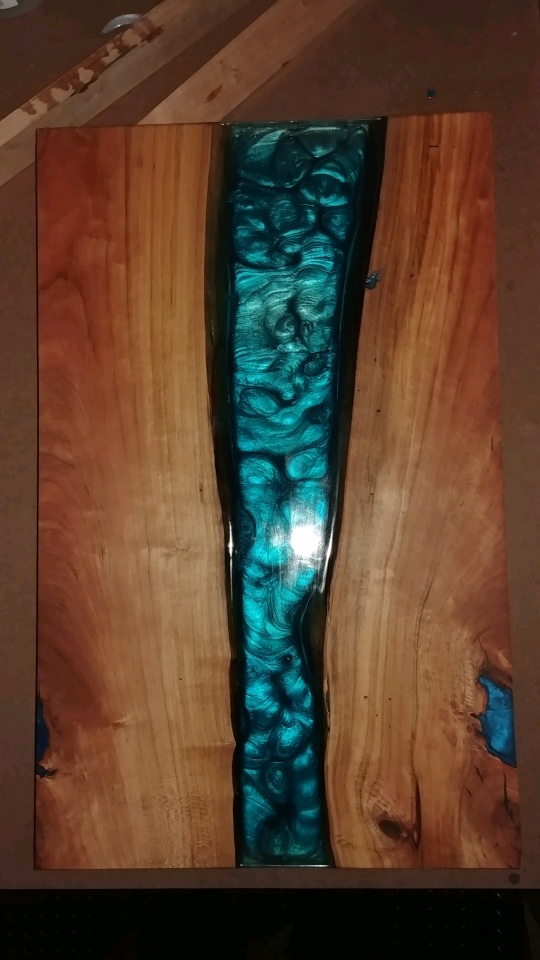

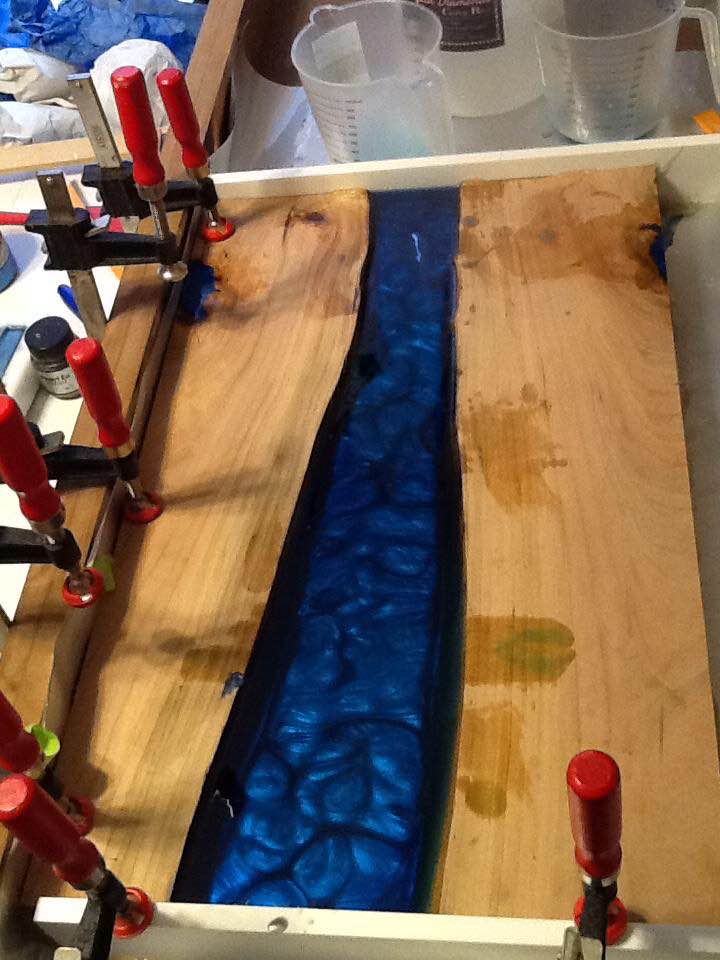

The first layer is about 1" colored blue and the second is about 3/4" tinted blue poured after 3 to 3 and 1/2 hours. table.jpg

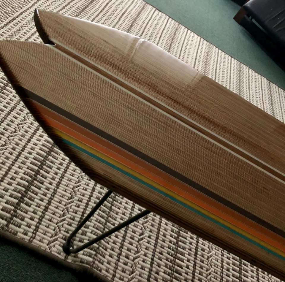

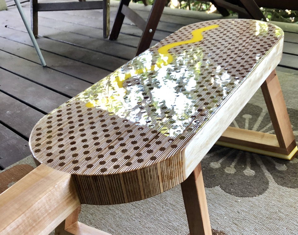

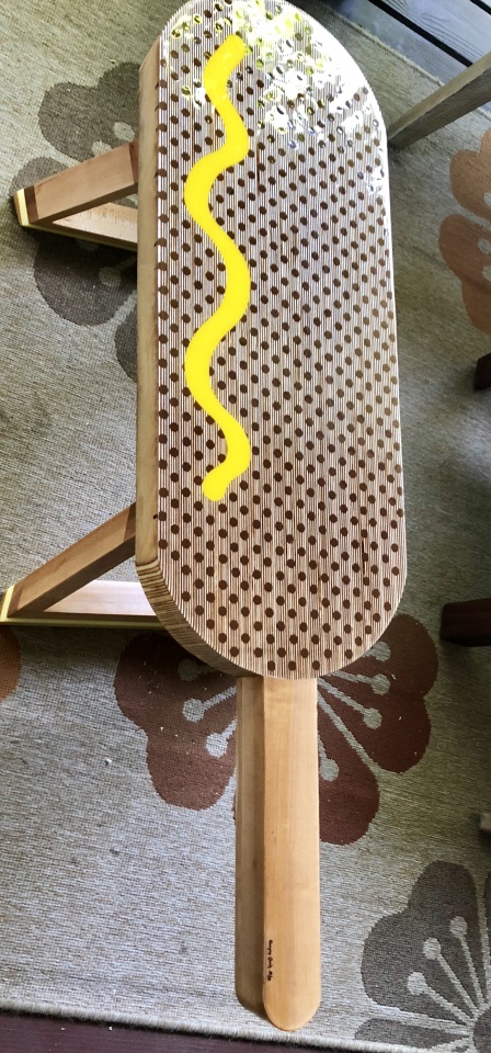

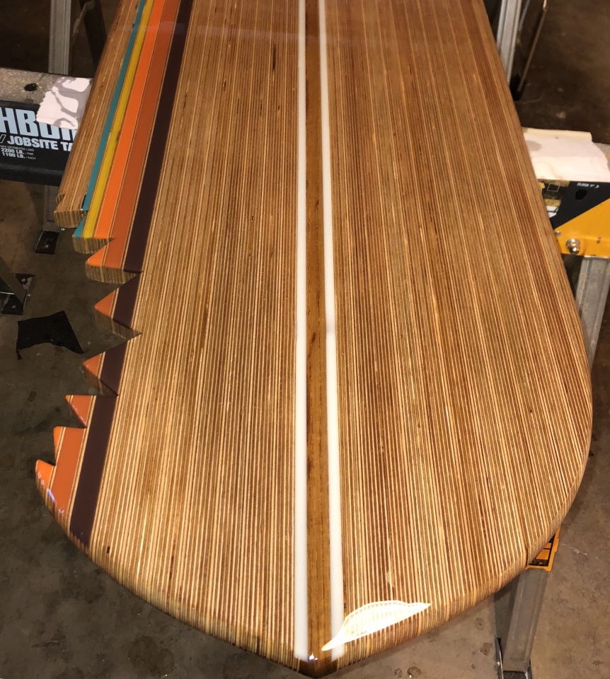

Here's a couple of projects that I've done with epoxy resin. In each, all the colors were poured into cavities/grooves that I routed. The cavities are about 3/8 thick so that I'd have plenty of depth of epoxy as these projects were passed thru my planer.
Both are coffee tables-one's a surfboard and the other is a corndog. After planing, they were covered with 3 clear layers of the same resin and bubbles are easily removed with careful use of a torch. The long open time means I can mix one large batch and dye it as needed without having to worry about it starting to kick over.
