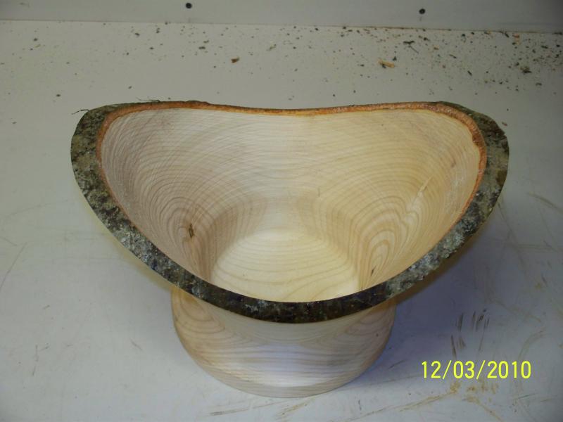

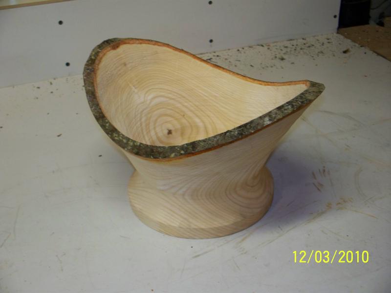

This vessel was turned from a hunk of an alder tree that blew down in a storm. The pictures were taken right after I "green" turned it. I know that you dont have much alder back there but out here it grows everywhere and its not a very interesting wood. This particular vessel was made for my sister and she has it sitting as the center piece on her dinning room table, filled with dried flowers and potpourri.
Bottom line is that you can make almost any piece of wood into a keep sake for someone. :biggrin:

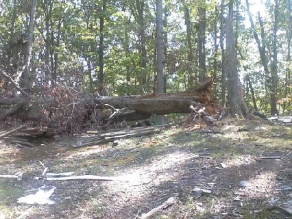

Here's the tree. Upon closer inspection the main trunk is closer to 36" across.
It broke off at the base. The root ball is not exposed. Here is the hollow trunk. I can probably get some fair sized slabs from that - the wood is about 3" thick there.

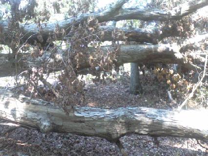

Is this what I'm looking for - where the younger tree had a branch that has since covered over.
There are a few of those that I can get to.

As you can see, it's a large tree. If I had a need, I would cut the entire thing up, but very few houses around here have fireplaces. If possible, I'd like to get the 'good' off of it without too much extra work. I'm lazy like that :biggrin:

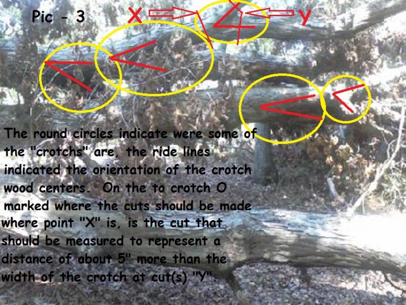

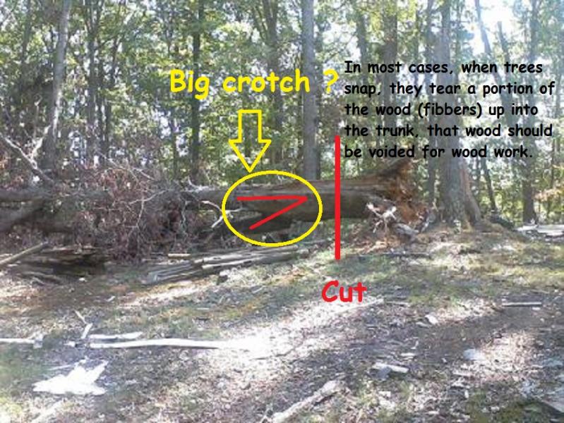

Most of those "bulged"/"sacks" you are referring as "burls", are not so. Those formations are in 95% of times due to tree "repairing" itself after a branch has snapped and or cut at that location. You will find a curled/twisted type of grain formation but, is no guarantee that it has any special colourations on it, sometimes those sacks are full of sapwood...!
Burls CAN form from a tree defect such as these, the burls themselves are a tree attempt to release the chemical reactions from a disease of some nature or form, pretty much like a cist/furuncle(boil) is formed in animals such as humans and others...!
So, the best way to deal with those is to do what I shown on pic-1, just in case the area has some interesting grains and colours caused but that flaw. The log is then slip/rip through the pith (logs centre) where that flaw/sack stays attached to one half of the log and at is centre for further processing...!
Crotches do offer some of the most intricate grains at the fork junction, those full forks/logs are then split/ripped through its pith, in the up-right position so that you endup with the "y" shape on both halves...!
Pretty much all the information contained in your pics that I edited on, is self-explanatory and easy to follow, it all depends of how much wood you want to take out of that tree and you 14" chainsaw in more than enough to do the job, if you start with a sharp chain and keep it sharpened as you go...!
After you get your logs, we can go through of how to process each one, depending on what you want to turn from them or prepared/seal them for later use...!
