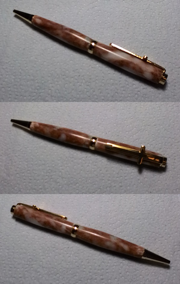

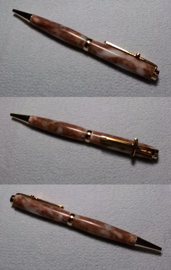

Want me to send ya an alabaster blank?
Alabaster turns much like a very VERY dry cedar, actually... MAKE SURE YOU USE A DUST COLLECTOR! At least the alabaster I have here at the moment that I like working with. I have some Italian alabaster as well, which turns quite a bit more like ebony. It's beautiful, but very difficult to work, I'm having problems with it. I'ld send you some of this New Mexico Alabaster ... it's got some lovely orange and cream colors in it.
attachment.php
My issues with using it normally is that it is some fairly fragile stuff, and it won't take a CA finish very well. I tried doing a CA finish on it, and the CA sloughed right off. I have no idea what I may have done wrong, and I plan to try again sometime, but these pics are with NO surface coat whatsoever ... just plain polished stone. PlastX worked beautifully, since it's such a soft material.
If you want to finish an alabaster pen, just take it up to 12,000 grit micromesh as you would an acrylic, and then polish just like acrylic. Before pressing the pen together, take a power drill with a small slotted rod and chuck in a piece of 500 grit sandpaper and ream the seating areas in the barrels. You do NOT want a tight press seal in your brass barrels, the stone WILL crack. You want a loose hand press for the parts, and either epoxy or CA them in place.
DO NOT DROP. Alabaster will shatter.
