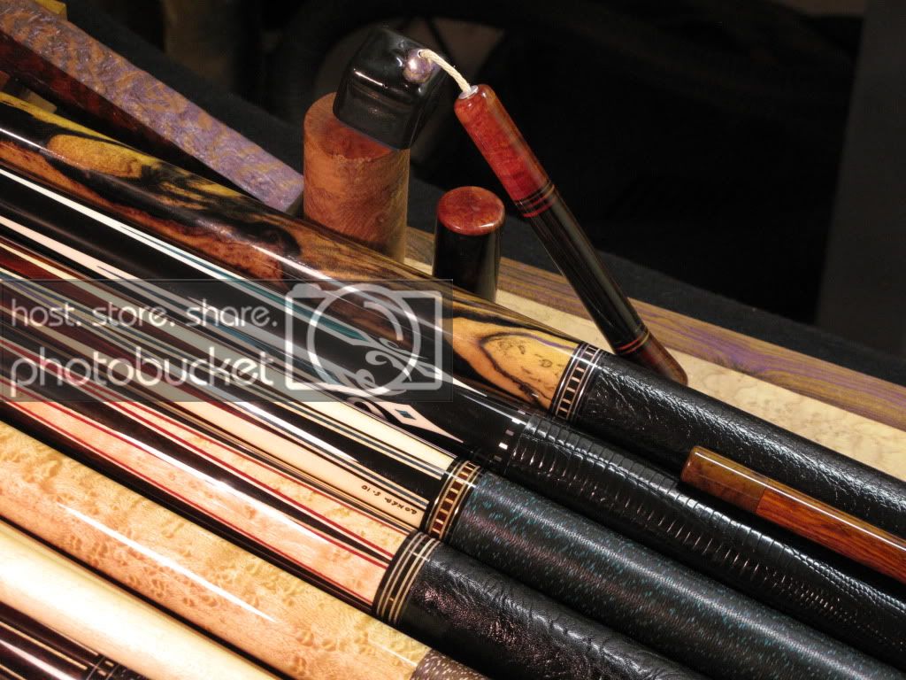

Hmmm ... looks like a Taig lathe with a small router mounted to the cross-feed.
That's one way to square blank ends on really hard wood.
Can't figure out what the toothpick is for, though ... or the small birch (?) dowel.

Sorry not really a pen maker, want a be cue maker except really no wood working experience.
Made these pool cue chalk holders or pocket chalkers is what I call them .
So I could learn wood working on my own .
Didn't really want to copy anyone's work, no idea what I am doing but they seem to sale ok .
But for the last 2 years been trying to get caught up on my orders and get my health together enough to make pool cues, I also make allot of pipes .
The tooth pick was trying to point out I have a purple heart ring on the end of the cocobolo that has been trimmed to about 0.004 .
I don't have issue of squaring a end up or cutting hard or soft woods or acrylics .
Having blow out and things like that.
About once ever 3 years I forget to get a piece of wood clamped down good and the router bit catches it and sends it flying mach 10 .
The dowel if for Alinement and strength .
