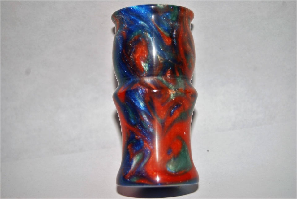

These are 2 alumilite slow clear blanks. I poured resin into mold at 94 degrees. Just a few colors like John mentioned. Alternating as I poured. But only gives you about 3 minutes to pour and get under pressure. So have everything ready before you start

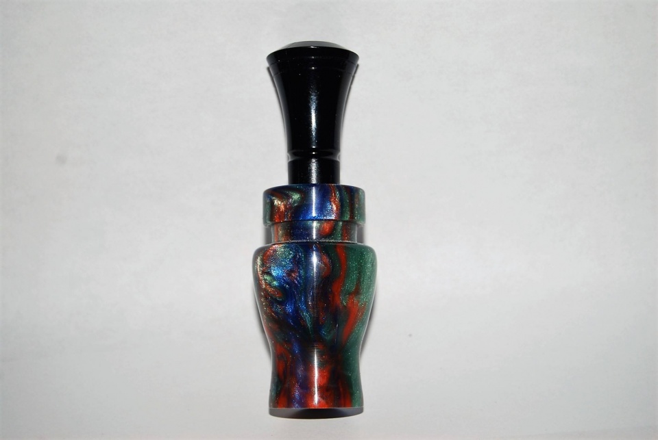

I had to do some digging, but I wanted to be fair, and show some urethane blanks.
These were cast in a very similar method to the polyester blanks I posted.
These were poured immediately after the two parts were mixed thoroughly.
They weren't poured based on the resin's temperature, and from the time the two parts were combined, to the actual pour, was approx. 3 minutes.
They were under pressure in less than 6 minutes.
The swirl is a result of the method, and not of the temperature.
I still prefer polyester.
