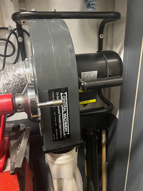

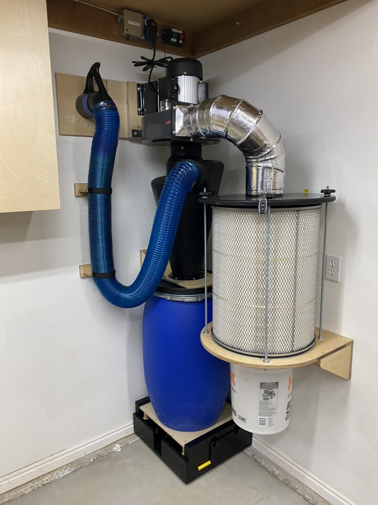

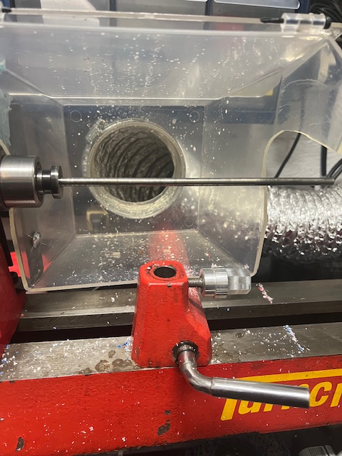

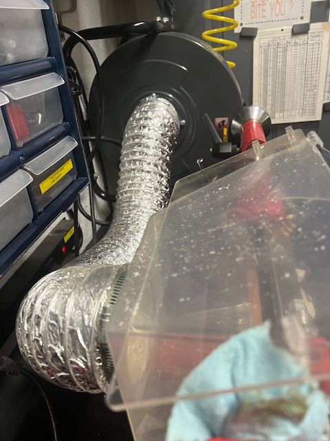

I have the 2 HP Harbor Freight duct collector. I am not using it as sold, but am using the motor, fan/impeller and housing in my built up dust collector (picture below). I have it paired with a Super Dust Deputy and a Wynn Environmental Merv 15 cannister filter. I do not know what impact those may have on the decibel level.

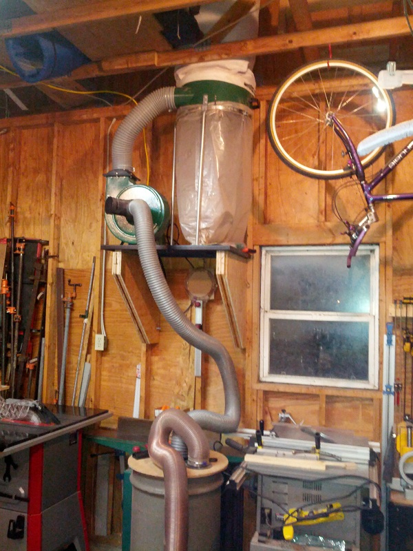

I added a Thien Baffle (self made) on a Brut Trash can to mine. It collected fine, but this allows me to empty the can without having to empty the bag. I also replaced the OEM fan wheel with a larger diameter Rikon fan wheel that has a different blade pitch and reduced the length of tubing between the blower and bag housing to move more CFM (this helps offset a loss of CFM from adding the trash can baffle). Final mod was to replace the exhaust bag a Wynn pleated filter. This decreases the exhaust resistance, increases level of filtration and decreased noise level.
None of this was necessary for it to work. But I had fun and ended up with a much higher performing system for a few hundred dollars less than buying one already built that way.

The HF system will take care of separation, at least at some level, but I believe that the Super Dust Deputy does a better job.
Another issue, at least for me, is that the HF design has the separator between the fabric bag "filter" (I use that term VERY loosely) and the clear plastic collection bag. Because of the space I wanted to use it in my shop, I wanted a different configuration. I also knew that I was absolutely not going to rely on the HF 5 micron bag "filter". The really bad stuff for you us smaller than that. I didn't want 2 HP dust circulator in my shop so I built swapped in the Super Dust Deputy and the Merv 15 Wynn Environmental (filters down to 0.3 microns).
Also my design, similar to Mike's (MRDucks2) allows me to simply empty the 30 gallon drum/barrel and not mess with the bags.
If you have space for the HF as designed, you can get the Wynn filter kit is designed to sit/mount on top of the separator section in place of the fabric bag "filter". Here is a link to it.

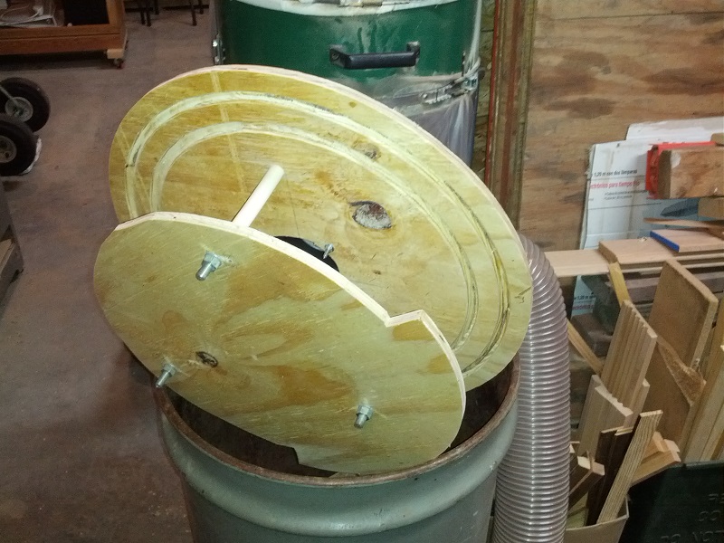

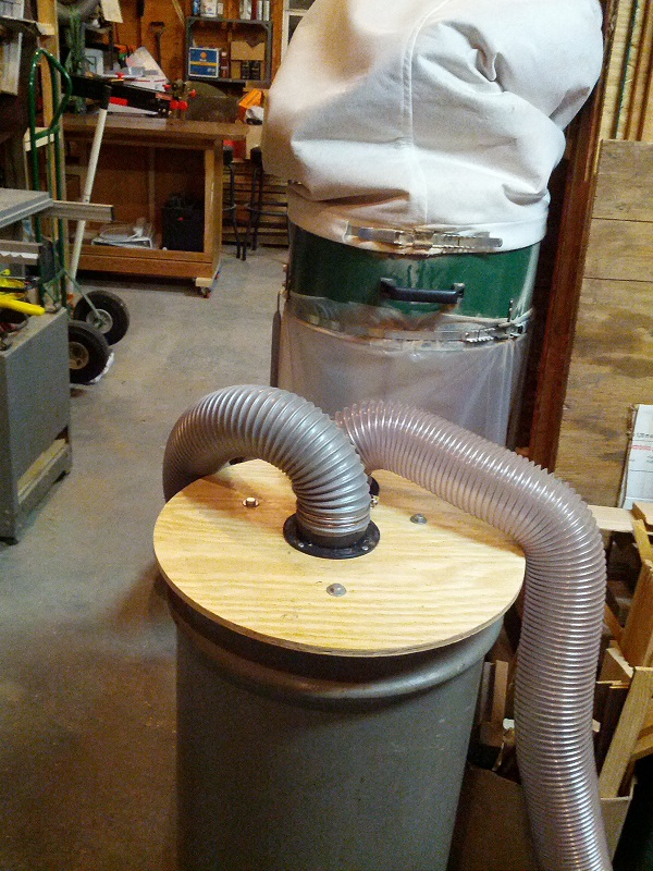

Another homemade Thein Baffle here. Haven't had the plastic bag off in 8 or so years (make that 11 based on the dates the pics were taken!!), but have emptied the barrel a gazillion times. Allowed me to mount the DC high, just reach up with a long broom handle to knock a little dust off the filter bag on occasion.
