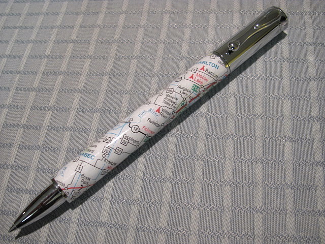

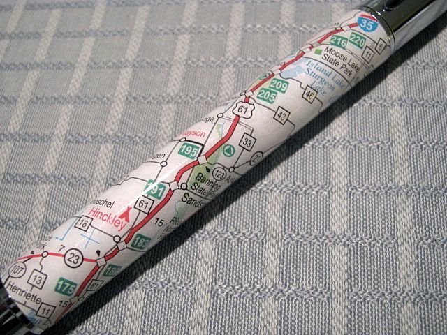

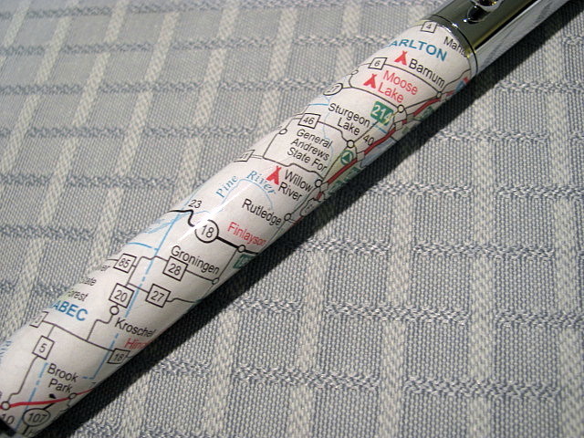

I thought it would be cool to make some roadmap pens.This is my first one,kindof an experiment.
For this one,I picked the map of the route we would drive up north to Moose Lake,Minnesota almost every weekend to visit with relatives,hunt,fish,ride motorcycles,and just have fun.
The small towns and country on this map are all really pretty scenery.Looking at it reminds me of all those fun times growing up.
I'll keep them close to my heart,when it's in my shirt pocket.
I did this the same as a decoupage stamp pen,with ca.
So now I want to do some of our favorite vacation trips.I just love looking at maps,I can get lost for hours studying them.It's fun to try to imagine what all the places are like!
Thanks for lookin'!
Steve

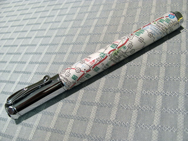

It's a Zen rollerball pen in chrome.These have the neat magnetic cap.
It's my favorite kit for pens like this because there's no clip to get in the way.

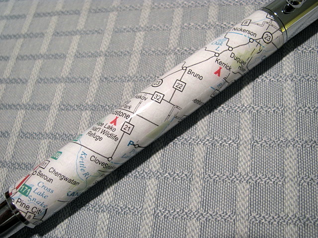

favor please, odd request but would you mind showing the seam side where you glued them together. And you are gluing up on a blank of wood thats been turned? Would you mind giving us newbies more insight of start to finish please... thanks
Hi William,
The 4th picture shows the seam a little.I just had it overlap by just a little bit.I lucked out because in that area,there is not a lot going on,so it blended in ok.
I did it the same as a decoupage stamp pen.
I used up boring piece of wood,and made the pen like normal,only I made it about .035" undersized.Then a quick ca finish to seal it,then I spray paint it with satin white Krylon Fusion paint.Then use Mod Podge to glue the map on,then 2 sealing coats of Mod Modge over it to seal.I wait a day or two to cure,then coat with ca.
I found that using the foam wedge-shape cosmetic applicators from Target work great.With the lathe running slower than when you use paper towels,since most of it goes onto the blank than getting soaked up by the paper towel.I do three pretty heavy applications wiped side-to-side,then accelerator,then repeat I build it up about .010-.015'' over,then I use a freshly-sharpened skew like a scraper to take it back down to size,eliminating any bumps.
If you save the foams,you can use the other side.It gets curled by the ca,so the curl really fits the pen blank nice.The foams take some practice to get used to,but I'm sold on that method now.
I'm doing it TBC,I think it would be hard to do it on a mandrel.
Then I just finish as normal.I sure like using that Dr.Kirk's Micro-Magic that CSUSA sells,that really speeds up the final finishing.
If you haven't watched the video on You Tube that PSI made,that's how I got started.Just do a search on YouTube, "Stamp Pen" and it will come up pretty quickly.
I hope some of this info is helpful.I'm sure there's better ways of doing it,but it's just the way I do it.
Take care,
Steve
