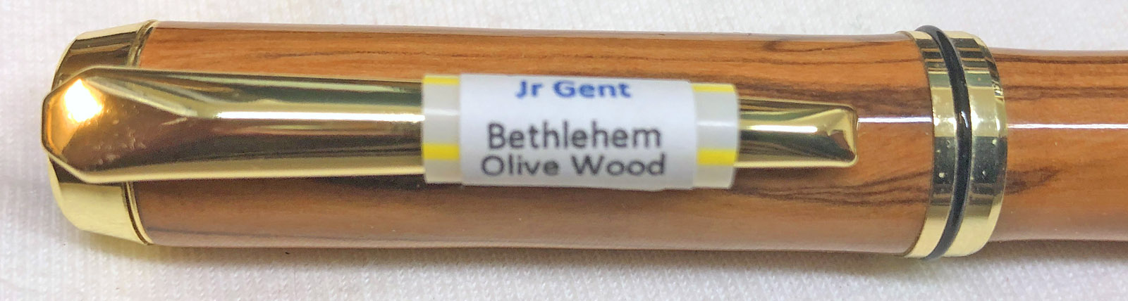

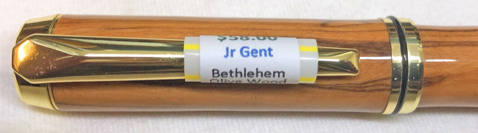

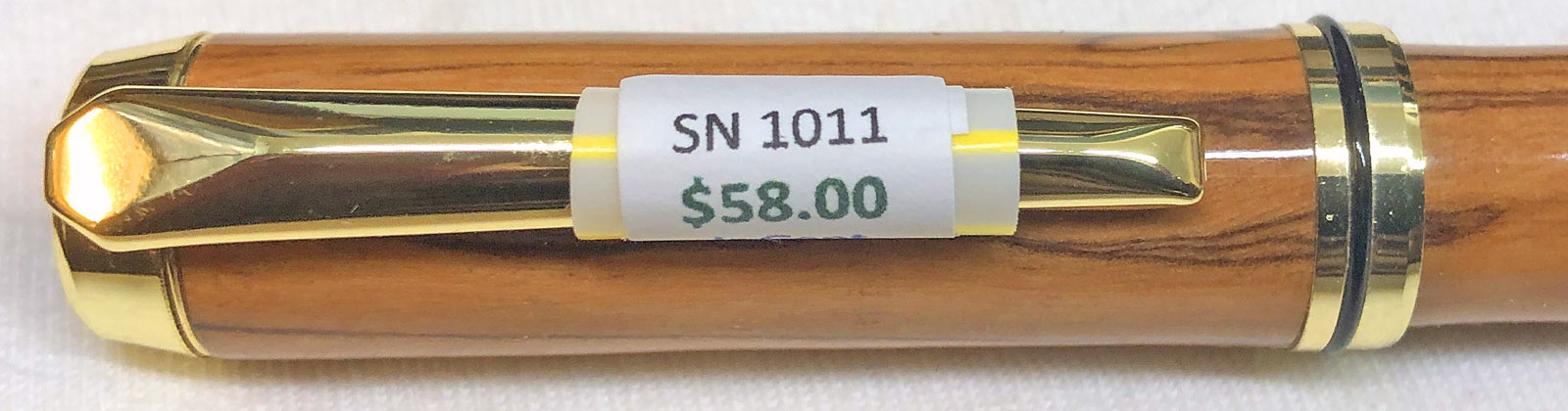

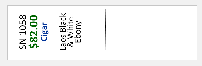

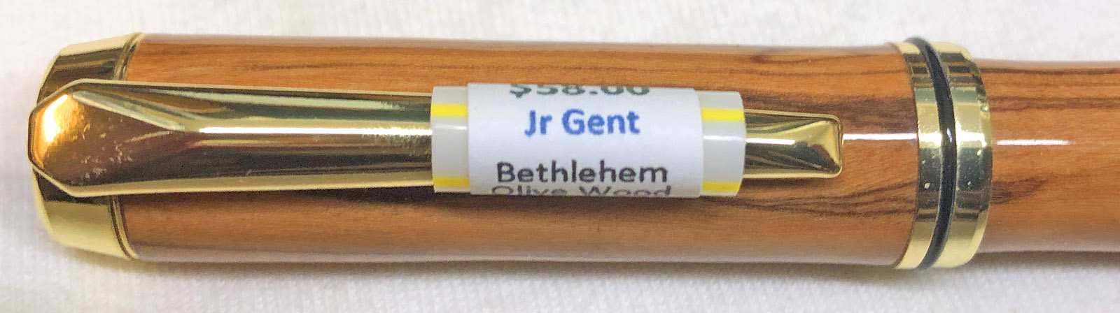

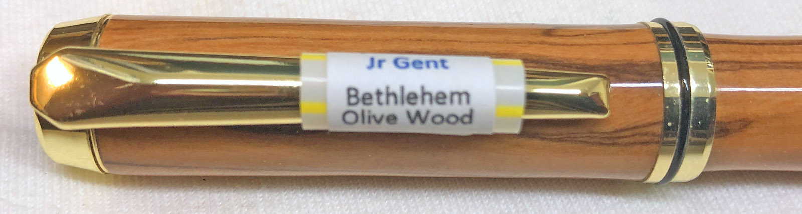

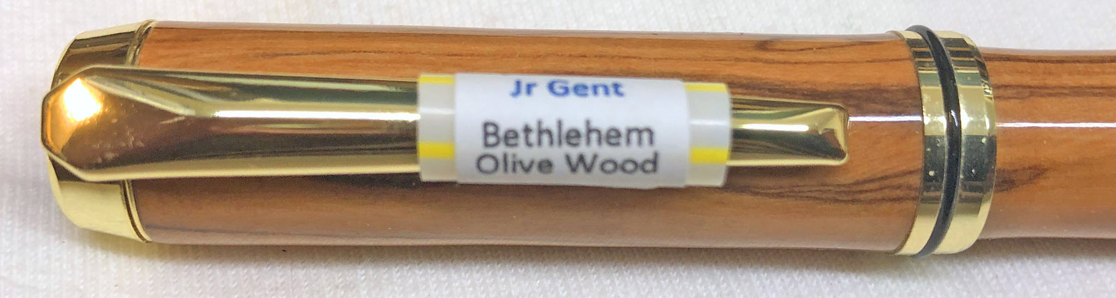

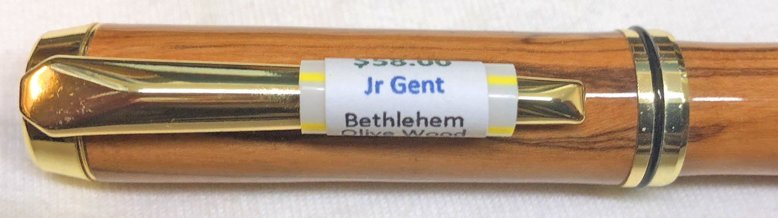

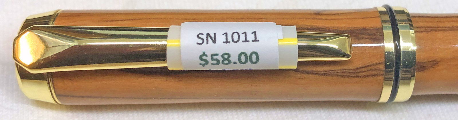

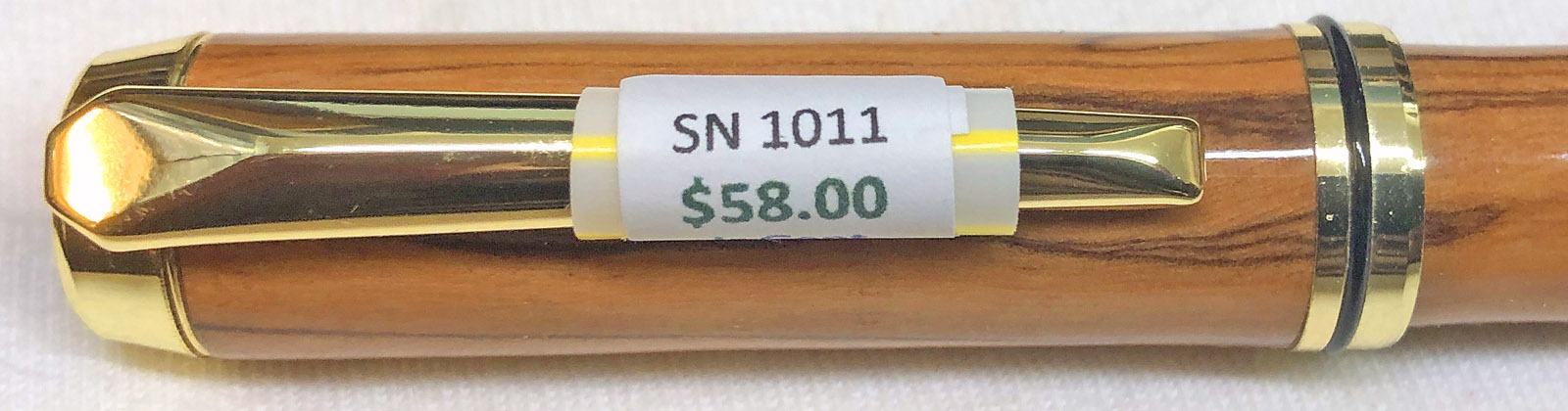

So, ultimately I wound up printing the ID number, the value, the style, and the blank material information on half of a return address label (they are 1.75" x 0.5" - Avery #8167 or Online Labels OL25 and apply it by rolling it around a 3/4" piece of plastic drinking straw. Then I simply slip the straw onto the clip. It is compact and still contains more information than just an ID number. As for ID numbers, I just use a serial number with no embedded information. I like it because it is compact, easily installed or removed, and doesn't leave any kind of sticky residue behind.
Here is a screen capture of one of the labels (I use an older version of Microsoft Publisher and just print them on my inkjet printer). The fonts are 7 point for the ID number, 8 point for the Value, and 6 point for the pen type and blank material.
Dave
Dave

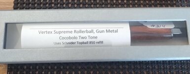

I print a full description of the pen on the back of a business card, which goes in the box with the pen. I grab the card based on the pen number.

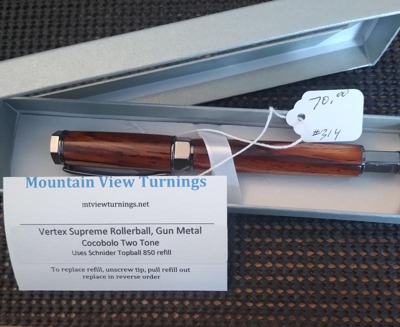

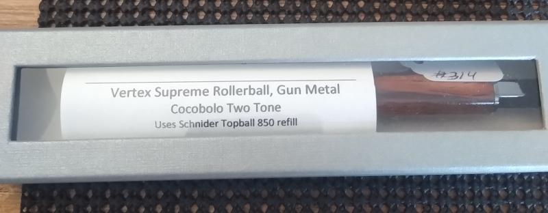

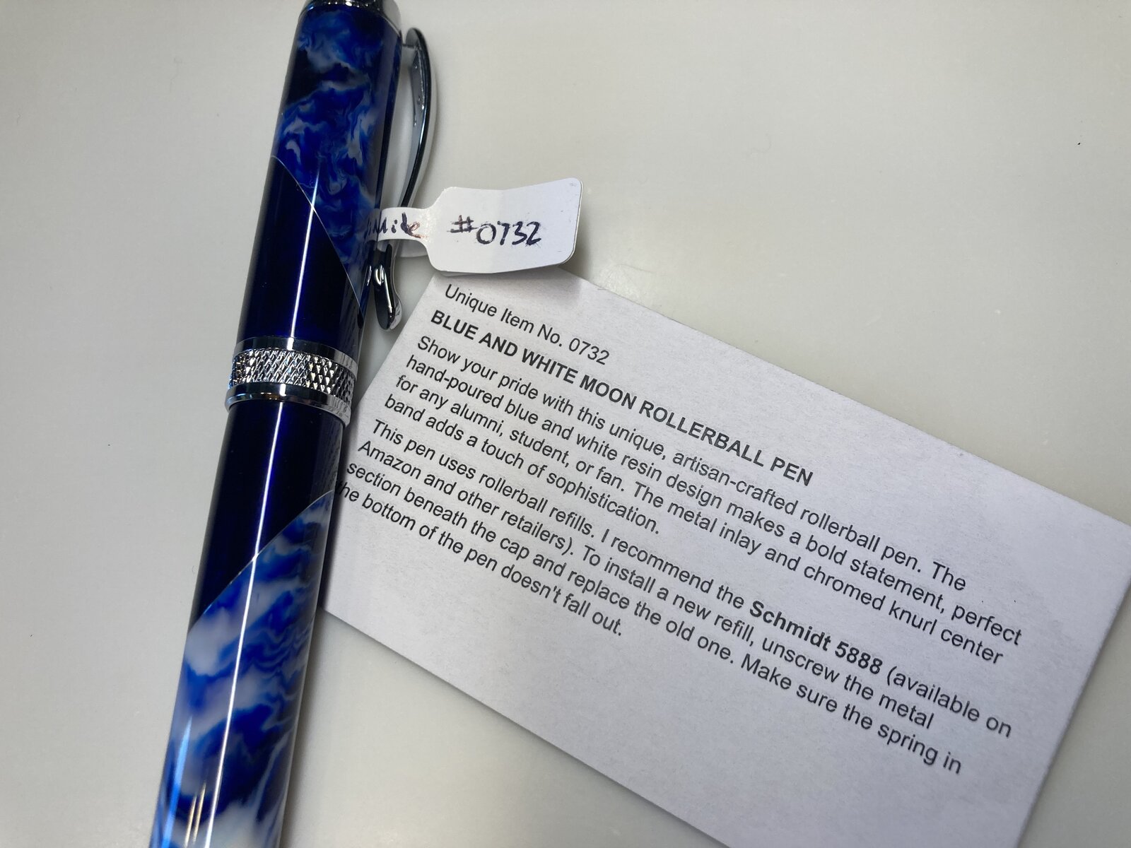

When I do shows, I have pens, bottle openers, other small turnings in gift boxes or clear bags. Bags get a sticker with item description, and wood used.

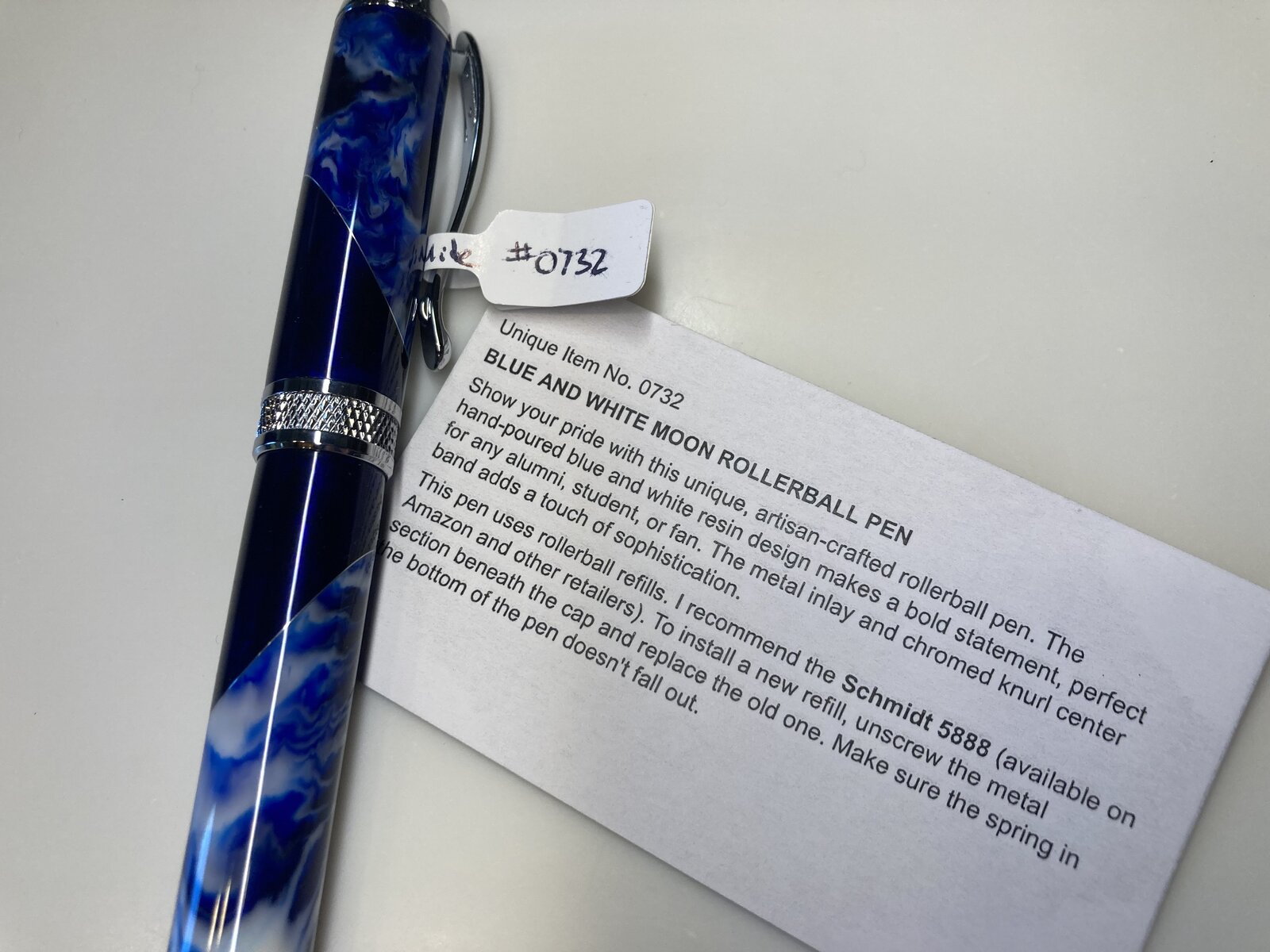

Pens have a small hanging tag and a description card. Business card size. I have cards made up for each style pen, then I use stickers for the wood used and pen hardware used that I'll put on the card. Pens stay in the boxes while on display or some will be on stands.
I use Excel to keep ID numbers for all I have in stock. The cards not only describe the pen style and wood, I also include info on how to change the refill and what refill is used. It works for me.
