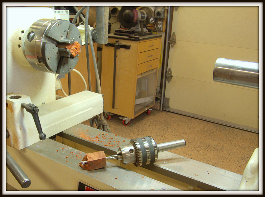

When drilling deep on the lathe, I bet a lot of you take the same shortcut I do. You advance the chuck with the handwheel, then hold on to the chuck, flip up the tailstock retaining lever, and withdraw the whole thing. I've done that countless times. It seems safe, but maybe with the MT it's not as safe as I think.
Last weekend I wasn't gripping the chuck as securely as I should have been, the bit hung up in the workpiece, and the chuck pulled out of the tailstock. Wanna guess what happened? :biggrin:
The bit bent, and the chuck made several increasingly large orbits around the centerline. The chuck met my thumb on one of those orbits, and finally launched itself across the shop, ricocheted off the drill press, and impaled itself in my dust collector piping. This was the most serious accident I've had in the shop, and it shook me up.
After changing my shorts, I patched myself up, but after a week of pain and lack of healing, I had a little surgery today to clean up the mess. The nerve block wore off a couple hours ago, and it already feels better than it did this morning.
Keep asking yourself "how can this hurt me", and pay attention to the answer! I lost focus for one moment at the wrong time and I got bit. Other than a few bucks and a few lost evenings in the shop, I'm none the worse for it. 18 inches to the left of where I ended up ducking and I might be dead.
There are many dangers in the shop and the only defense is YOU! Be careful my friends.

The first thing to remember is that tapers are designed to accurately align parts in a compression setting , not a tension one . The second is to frequently withdraw to remove the cuttings , as they are what jams the drill bit . Some woods are more prone to it than others . Don`t keep drilling if the cuttings stop coming out . Low melting point plastics are the worst hazard .

No. I was advancing the bit using than handwheel. Retract to zero. Lock tailstock with bit at entry point. Advance with handwheel into stock. Hold chuck and retract entire tailstock. Crank quill back to zero, advance tailstock to zero, reposition, repeat
*) the first red flag I noted was 'I wasn't gripping the chuck as securely as I should have been' <- by this you mean with your hands?
Yes, I believe it's very common to put a little pressure on a MT connection to keep it firmly seated by holding the chuck barrel.

here's my tip. now whenever i put my chuck in i retract the jaws all the way in and tap the chuck home with a hammer.
If you want to be really safe and your lathe has a hollow tail stock, look for a drill chuck with a threaded (3/8" x 16TPI) end in the taper. These are commonly used for drill presses and milling machines.

When you turn the wheel to back the bit out of the work to clear shavings out of the bit, sometimes the bit catches a bit in the work, and breaks the grip of the morse taper on the tailstock. As a result, instead of the bit backing out of the work as you turn the wheel, the chuck comes forward out of the tailstock. When it clears the tailstock, the weight of the chuck and morse taper cause the bit to bend. Since all this is happening at about 500 rpm, it happens FAST. The whole chuck is whipping around in a circle until something lets go and it goes flying across the shop.
