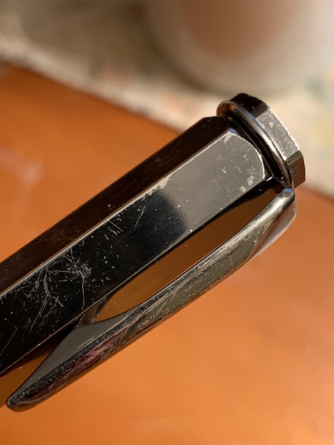

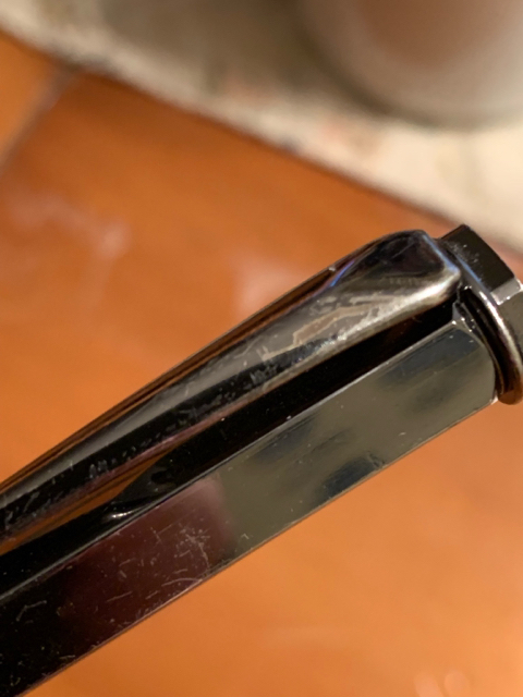

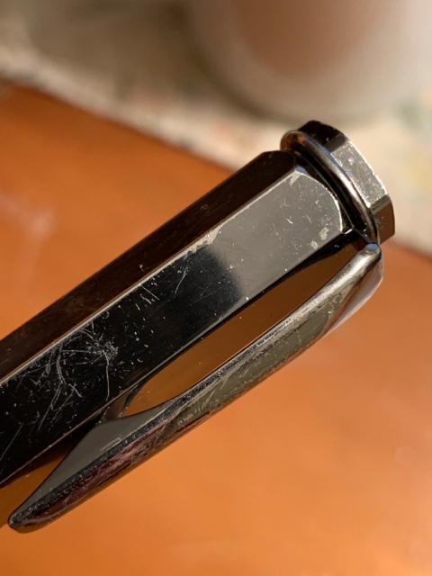

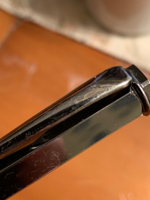

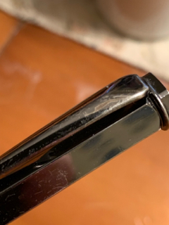

I've had gunmetal parts that have become pitted over time, probably from chemicals in finger oils and/or sweat.
Up till then, I'd believed the claims I'd read that gunmetal finishes are "as durable as chrome".
I believe "gunmetal" starts life as "black chrome" without some, most or all of the hardeners added to traditional black chrome. If substrate prep isn't thorough/sufficient, finished plated part may be prone to pitting, especially in presence of normal human body contact. It certainly is not as durable as traditional "chrome". This is also true for "rhodium" where expense is already greater hence the potential to cut some corners in the process.
