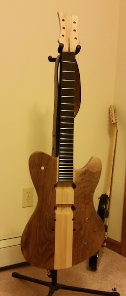

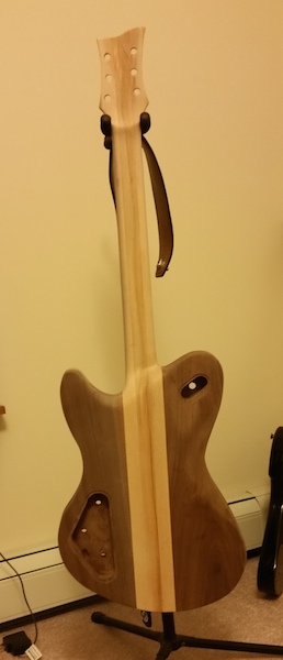

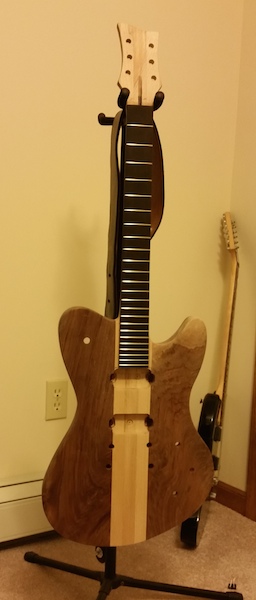

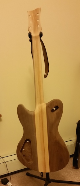

In my opinion the guitar templates are not a good investment of your money, unless you are trying to replicate a specific guitar. There are three important decisions to make when building a guitar, what scale length you want (the distance between the nut and bridge), what bridge you are going to use, and what neck joint you want. Once you have answered these three questions you can figure out all of the import and locations using some math. This is the process I used to make the guitar in the pictures below. I have not had a chance to finish it yet, free time is hard for me to find right now. One place I found very helpful when I was building this was the Crimson Custom Guitars youtube channel. They have lots of instructional and problem solving videos. If you have any questions feel free to message me, I would be happy to share everything I learned while making this guitar.
