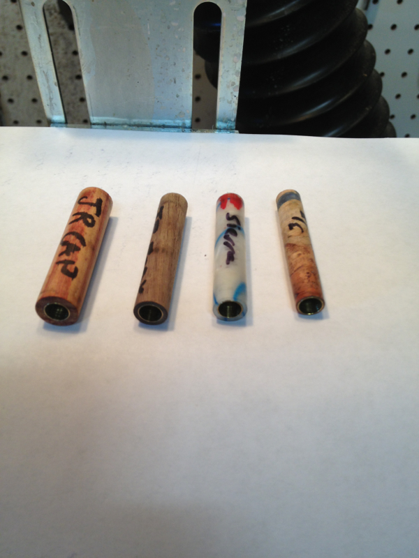

I make em. I've used blanks already on 7mm tubes that I've received in swaps or buys and turn them down to the ID of the tube needed. That way they can slide onto a pen mill or onto the sanding mill Rick Herrell sells. Works great. I think I have an extra metal one here if you don't want to make one though.

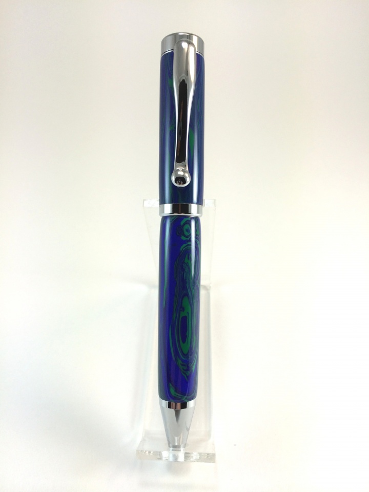

Hi Folks: I wound-up oversizing the length of the cut, not drilling the whole way thru (after blowing two blanks attempting to drill thru it), gluing in the tube using thick CA, then trimming small amounts off of the closed end until a 5 mm hole appeared. Then I sanded (trimmed both ends of the barrel) using my lathe (80 grit) and the HF transfer punch (I guess it was about 12MM). Worked out well. I didn't enjoy by Malachite tru stone experience. The 10.5 mm side went well, but the 12.5mm was a PITN for me (all about patience...some day I will learn). Here what it looks like. I would give it a "B". Really a C- if you count the two short blanks that I blew. Thanks for all of the advice. I really do like the Atrax. Funny, I bought the blanks 1 week into penturning (at a WW show in Atlanta) and two weeks before buying my lathe. I had no idea what I was buying. On to my DC system. Despite organic mask, shop vacs, and hood, that blank made a lot of dust which managed to get into my lungs. Thanks again! It looks that Jet DC 1100 VX may be the right way for me to go.

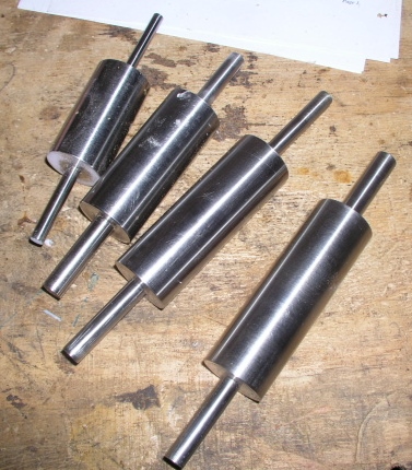

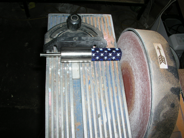

i bought a pen mill many years ago when i first started pen turning and hated it , but used it for a few months . then i started using a small block of wood with a bolt in the end and some plastice bushes that i turned up to fit the different tubes . i have only just finished a few days ago making these ( pictured ) they are made from stainless steel , as you can see i have made up 4 so far to suit the main size tubes i use 7mm 8mm baron , triton ,3/8 ,sierra , once i see how they go i will add more sizes if i need to i actually only just tried one this morning for the first time on an 8mm tube click pen and it seems to work just fine .
johno
