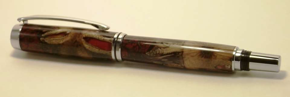

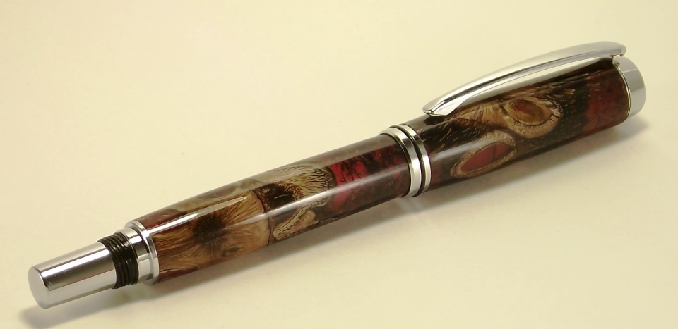

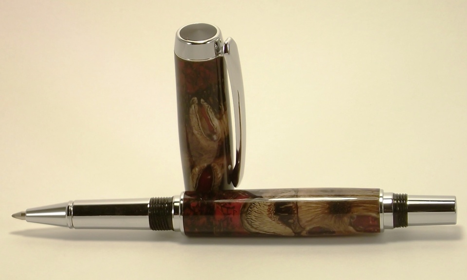

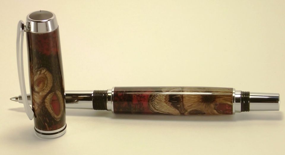

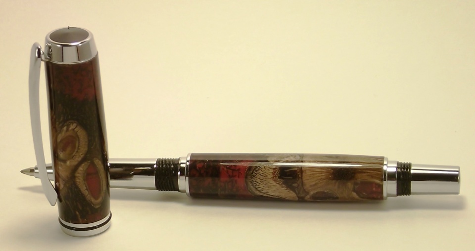

This is from the prize package I received at the MPG. George will hopefully chime in here and confirm or correct my guess. A really neat blank, cast in a resin of some sort. I painted the inside of the blanks with some dark red I had in the cabinet. Kit is another Apprentice Jr. Gent Chrome. A better pen turner would have had fewer flaws. Thanks for looking!

I may not be the George you're looking for but if had to risk some very sensitive parts I would bet on hairy pod banksia:..but I'm not ashamed to admit I've been wrong before:rolleyes:
Yes, wrong George but thanks anyway. I think we're right. Looking for George Valentine (Robutacion) Bits-of-Timber :biggrin:
Beautiful finished pen Chuck, and I see no flaws!
I believe your thought on the blank is correct, and if so, a fussy, delicate one to turn well. And then, you did a wonderful job! The finish looks excellent (I still am CA challenged).
Yes, Yes, I'm here...!
You are absolutely right, that is one of my Hairy Banksia pod Resifills cast in clear Epoxy resin, yes, I had one of them in my mixed blanks bags as door prizes at the MPG.
These are well known for being "fiddly" to work with, is just the nature of the blank however, the results are nothing short of stunning...!
They are also well known for requiring the tube painted, there are areas of the blanks that, as they get cut down to correct sizes, there is very little left of the pod and in certain areas of the pod's hairs, they are not enough to cover the tube reason why is so important to paint it.
I have seen these made with different colours painted on the tubes, that colours will change significantly the finished blank appearance and in your case, that red really fits it nicely.
The fit looks pretty good and that finish is superb, congrats...!

Thank you George! It's a relief to know that "Fiddly" is NOT exclusive to ME.:biggrin: I think I filled one chip out 6 times. :frown: I nearly trashed this project, but persisted until I got it to size. :biggrin: Close enough!! :wink:

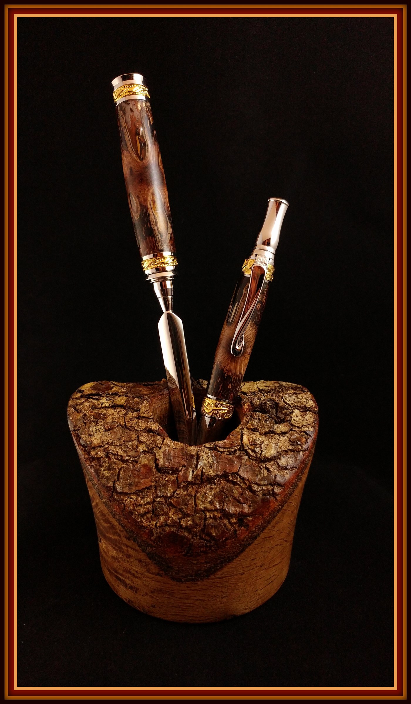

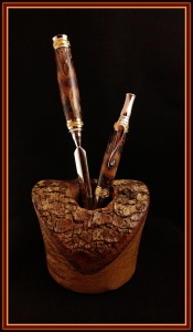

Below is a photo of a pen and letter opener I turned from two of George's hairy banksia seed pod blanks. It looks like the tubes and/or the inside of your blanks was painted a reddish color. Nice job!

Oh no Sir, your "tribulations" are a good example of what they "CAN" turn out to be, there are so many things that can contribute to a failure, and I have never said that they are easy but, one of the things that one will need to consider when deciding to use one of these blanks is, what type of kit to use, the kit with the most "meat" over the tubes/brass, is the most recommended but not always...!
People all over the world have purchased and tried these blanks, I have seen some great pens and I have seen pretty bad failures, with everything in between and from what I can see, you've done very well...!:wink:

I have done several of George's banksia pods. The rewards of taking your time and going slow, using copious amounts of thin CA as you go are well worth the results as you have proven here. That is a gorgeous pen. You should be proud.

Thank you George. I hope I haven't left anyone with the impression these blanks CAN'T be turned. Or are not worth buying. On the contrary, they are super nice, and well worth the challenge. Which is good! :wink: I look forward to a second round, but first I want to get through the rest of the prize package. Thanks for donating these awesome blanks George!:wink:

Thanks! That's exactly what it takes. And, I am proud of this pen.

I doubt that these blanks would provoke any allergy reactions to you, the pods are stabilised prior to casting.

Expertly Turned, and Well Finished, it is a shame you quit the CA a little too soon.
I know it does seem like you will never fill some of those persistent holes, But you can, and it makes the world of difference.
Not Withstanding, you have Created a Superb Pen, Chuck, one to be Justly Proud of.

Sure, the blanks are not cheap and no one wants to waste money but see it this way, making the decision to have a go should be followed by reading/all the info I put out about handling them, after that, there should be no reason why you shouldn't succeed.
Take that extra time with the steps required, you will not regret it in the end, by the contrary, you will feel a great achievement and you will have a pen that you can be proud to show to everybody you know or don't know, people will be interested in seeing how it looks like...!
Be brave...!
PS: With all this said, never forget that in the end, it's only a pen blank something you can replace and won't take you to bankruptcy or to the hospital ER...!:wink:
