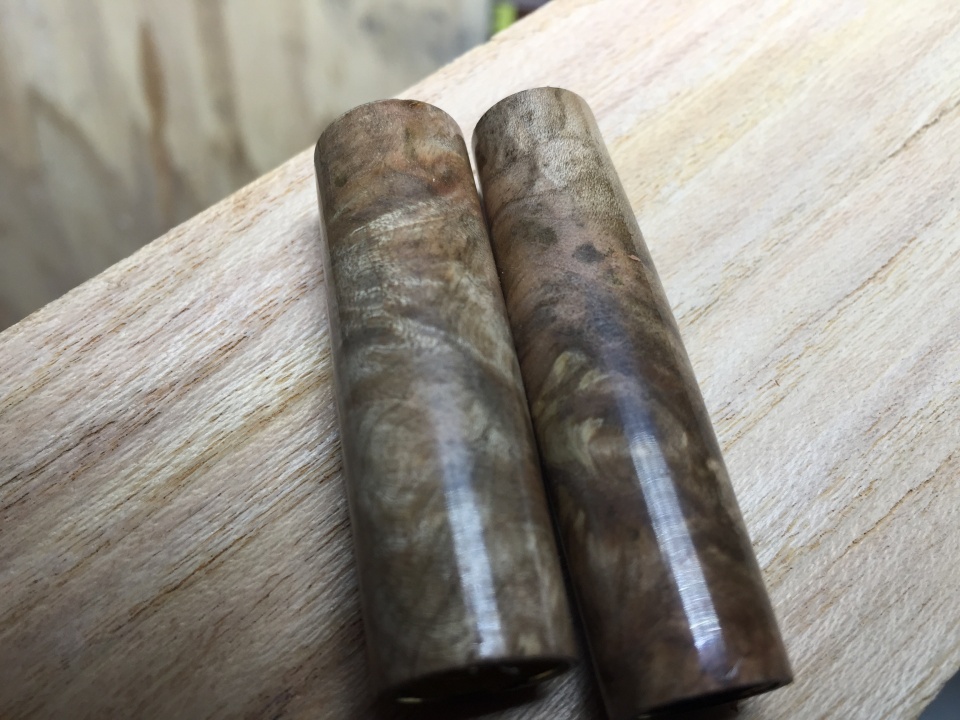

Guess which finish this is.....Craft Coat or CA? I'll give a hint: It's not CA:laugh:
So I've been playing with a bottle of Craft Coat this week, and here are the results. The pic is taken with my IPhone, I apologize. In the end, I have a finish that is 95% of what a CA finish is, without the smell, mess, cracked finish, etc..... No other alternative I have found gives me the depth like CA. Not sure of the durability, but I am satisfied with the look.

Those pen barrels look to have a good shine and depth, I would suggest you to finish them on a buffing wheel, to remove the circular marks and deepen the finish even more...!

Looks pretty good Steve.
Have you experimented with your process to get the result you're happy with?
Yes Dan, I went through many methods to get this. In the beginning....not too good. In the end, I applied each coat like CA, wait almost a minute between coats....did about 12 coats. Allow to cure for 24 hours, then micro mesh. This is where u need to be careful. I start with the second pad, only two seconds on each blank. For every pad I go up, add a second or two. You really need to be careful not to remove all of the finish in spots. The first several pads will eat right through all 12 coats real fast.
George is right, a good polishing will help with the final small scratches.
