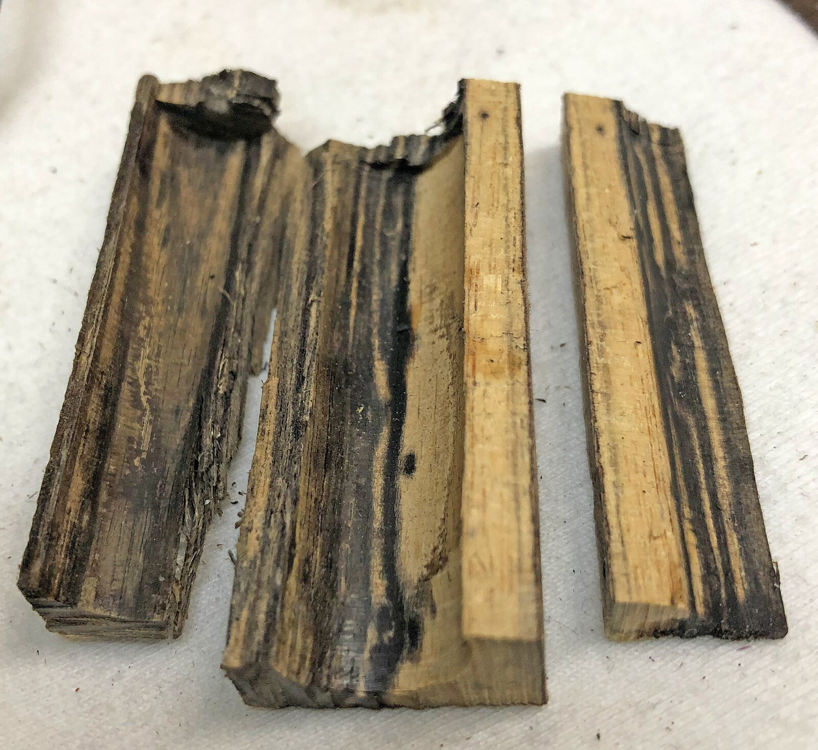

Hi all,
I just had a blowout on a nice Black and White Ebony blank from Laos. I drilled the body OK, but when I was drilling the cap I had a blowout when my drill was exiting the blank. Since this wood is hard and is prone to cracking, normally I would have cut the blank long and stopped drilling before breaking through, then saw it to the final length, but I was being greedy with the material so I could use the little cutoff nub to turn a custom cabochon for a cap insert (Jr. Gent Kit).
Oh well, I will just have to try again with a new blank tomorrow. - Dave

Perhaps this would work...or some variation. Glue the pieces to the tube, wrap the whole in tape/rubber bands and then saturate with thin CA such as Glueboost's Ultra thin.
However it is done, hope you are able to retrieve this from its path to the scrap pile.
Good luck!

It looks like you used brad points, and generally brad points are more prone to cause blowouts. It doesn't look like a total loss though. As mentioned by others, and since the wood striations vary in color, it looks doable to CA it together, if done carefully. I would use thick CA or 5 minute epoxy to allow time to get alignments correct.

To all: Thank you for your comments and suggestions. Unfortunately the blank was splintered and cracked a bunch along the sides where it blew out so gluing it back together just isn't going to be successful. Next time I might try gluing on some splints before I drill as the cap on the Jr. uses a pretty large hole (not much material left to turn away). And as Hank pointed out, I was using a brad point since I don't have any standard HSS bits for the Jr. series (yet that is).
I'm going to start over this morning with a nice, easy, Olive blank. After all, my objective was to make a custom insert (finial button?) for the cap - my very first attempt. I already knocked the black plastic one out and was ready to go.
Dave
