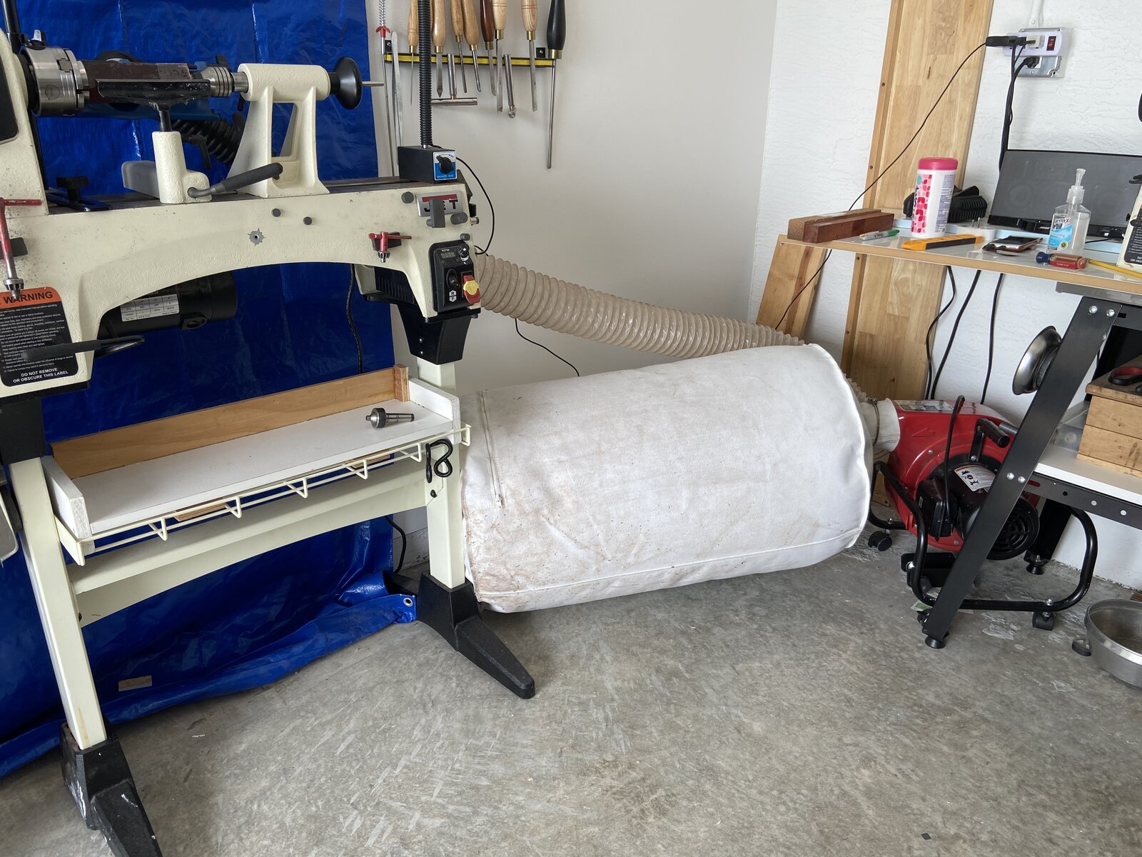

Do I feel lucky? Luckiest man in the world. I'm using 4" transparent flex hose.

If that is your setup for dust collecting you have no worries. Too short for a problem.
