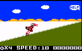

Be careful with reverse on lathes. Just because the motor/headstock can support it doesn't mean that the chuck will stay on when you suddenly slam it into reverse from a dead stop (or, worse, from full forward). A little 5" chuck isn't as terrifying as an 8" (or 12" or...), but it's still not much fun when it pops off while spinning, dings the ways, and then goes tearing off across the shop like that unicyclist from B.C. :
(how is it that the only animated GIF of this guy that I could find on the net is from the early 80s Moon Patrol knockoff?)
