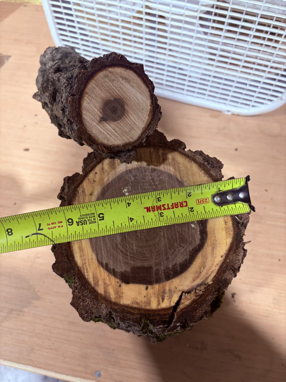

Had a limb come down off of a Walnut tree this week from storms and thought about learning how to quickly dry these out to make blanks for both pens and small bowls. What would be the process to make these into something we could turn in a months time frame?

If you were to use the larger diameter piece for bowl blanks you would get blanks that measure about 2 1/2" x 2 1/2". Small for bowls, IMO though I have turned quite a few what I call finger bowls that are that size.

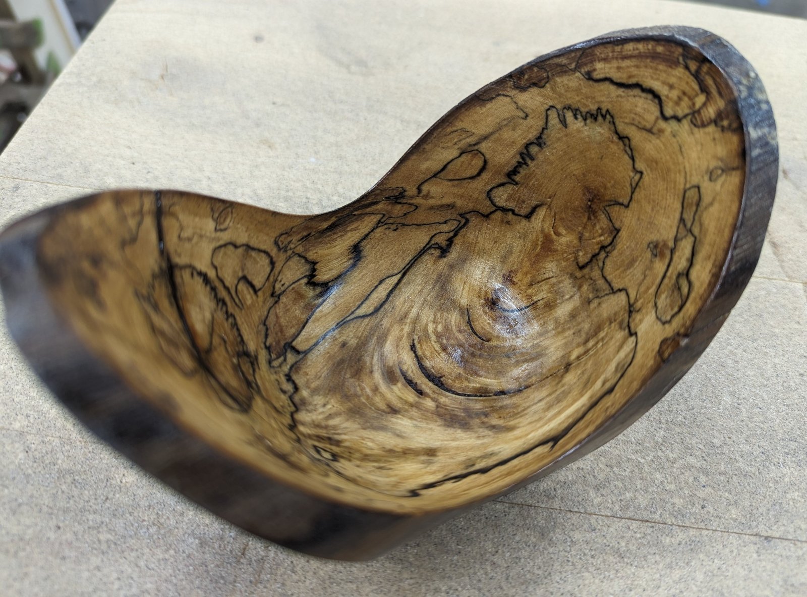

The V shaped bowl was a whole limb section that I turned. It measures about 3 1/2" tip to tip and 3 1/2" tall.

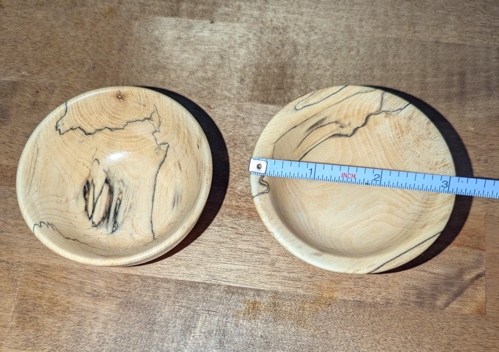

The two smaller bowls were turned from typical bowl blank as I describe cutting above. The measure just about 3" diameter and 2" tall.
