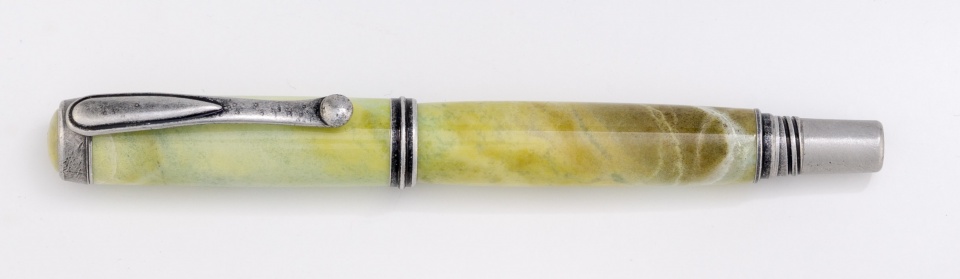

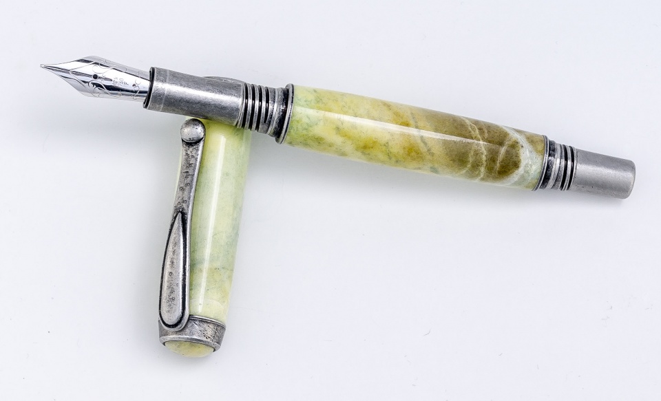

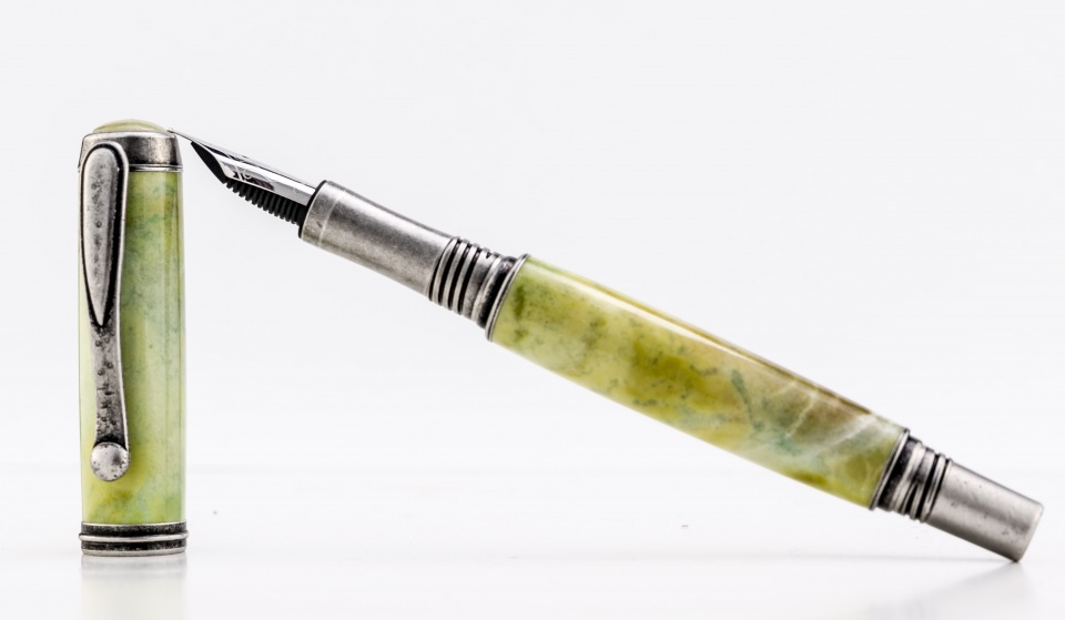

Hey folks, been a while since I posted but I wanted to share one I'll have with me down in DC. I found a great chunk of 'Antique Verde' green marble and sliced a few pieces off to make this. I love the quartz vein running through the body and will be very sad to see this one go. Thanks for looking, I hope you are all doing well :)

Hi John. Great to see you post! You need to visit and inspire us more often!
Beautiful pen! I love the subdued colors, very excellent. Hope all is well with you!
Be well, Mark
John, Is that a natural marble? What kind of tools are you using to turn marble? I have access to marble remnants but marble is so hard. Would love to be able to turn marble pens with some of the pieces I have available. Any advice?
Add me to the "how the heck did you do that" group. I've got a very special piece of marble I would love to do something with other than keep moving it around the shop and looking at it from time to time.
Thanks folks :) Yes this was actual marble, not marble-looking resin. Some of my stone technique is outlined in the IAP collection Mark has put together, but the best suggestion I have is try try try. What works for me may not work best for you; it took me months of practice (and breaking stone) to figure it out.
