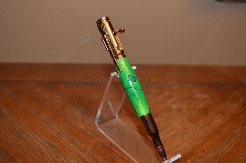

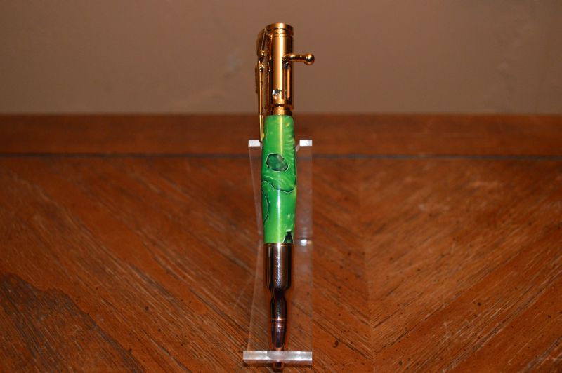

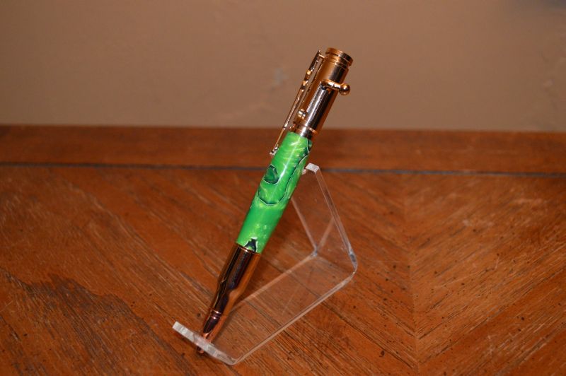

Gold bolt action kit using a grasshopper blank from woodcraft.....Really starting to love the acrylics!

What a great Stand Out Blank,
I think I hosed some of them off the grill of my car last week.
Terrific Finish, What finish / technique did you use?
A Crowd Pleaser.
Congratulations,
Brian.
Jan 9, 2014
21
Newport,NH
With my acrylic blanks i have been sanding starting at 220 and going all the way to 12000 Using the Micro mesh sanding pads. I then put the lathe at around 180 rpm and apply black magic car buffing compound and polish. Let the lathe stand for about 5 minutes wipe it with a rag then turn the speed way up to 2000 and buff. Havent had any issues yet.
