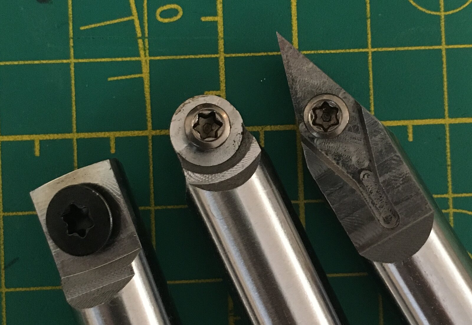

I'm about to start turning bowls and need to purchase another carving tool or two. Right now I've got one of the typical inexpensive 3 piece carbide sets off Amazon (pictured below w/o inserts) and from the videos I've been watching I'm gonna need a regular HSS bowl gouge and parting tool, and I'm wondering what size of each of these I'll need. I believe the size parting tool I've seen is described as 3/16"? so I suppose that's the size I'll order. And so far as the gouge goes I've seen them (in videos) in a number of different sizes. The turner I watch the most uses a 5/8" gouge but I'm wondering if that's gonna be too large to start off with. Since I'm just starting out my main concern is not doing anything quickly so if the only advantage of the larger 5/8" gouge is speed then I could probably do without it. Also, I've seen examples of dovetails being made in tenons with much smaller gouges, which is something I prob need to consider. Is there a middle size gouge that would do well for general bowl turning and tenon dove tails? What size parting tool and gouge would be best? Trying to save $ so if 1 gouge will do instead of 2 different sizes then that would make my day.
and...

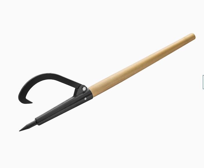

I believe that what you are looking for with regard to moving you log will be either a cant hook, to roll it, or a log jack, to lift it. Depends on your intent.

A "spud bar" can be used in a pinch to roll a log, but not as effectively as a cant hook. However, they are expensive. Logrite makes excellent ones, Stihl also has either a cant hook or similar tool (one has a point on the bottom of the pole, the other does not).

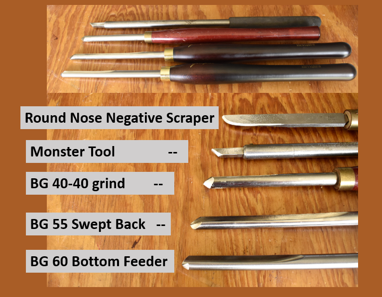

Here are the basic tools I use for bowls. Remember also, you'll need to be able to grind
them properly as well. If you can't get some personal instruction. I would advise you to
watch as many good bowl turners as possible. There are quite a few with different
techniques and philosophies. Learn them the best you can and then do what seems right
for your skillset. And don't worry about it, practice makes the best lessons of all.
Happy turning.
  • Round Nose Negative Rake Scraper... not real fond of this one.
  • Monster Tool... pretty much for hogging out... but mostly use it as a roughing gouge.
  • 40/40 Grind Bowl Gouge
  • 55 degree Swept Back Gouge. Although, this one may end up becoming a 40/40 grind.
-60 degrees Bottom Feeder Gouge.
And of course, this does not include the various sandpapers... I'll use anywhere from 80 grit to 1000 grit. Depending on what finish I'm going to use. The brands I currently have are Pinnacle, Glenn Lucas, and Monster.

I actually had log jack from either husqvarna or stihl that had a folded steel triangular welded plate for the pivot point instead of the leg. That was a great tool.

What's the difference between your round nose scraper pictured and this Hurricane scraper? What kind of cuts are each of them intended for in bowl turning?
Also, on the Monster Tool, I've mostly seen 1"-1 1/4" spindle gouges used for roughing out (1st cut) on rounding a log just put on the lathe, but you say this tool might be good for that as well? Are there any differences between the two? I've seen a lot of videos so far but this is the first I've seen this tool mentioned, or seen it pictured.
Finally, I believe the 55 swept back is used for the inside bowl sides, and the 60 bottom feeder is used for the inside bottom, but what is the 40-40 grind used for? Seen it mentioned before but haven't gotten a good explanation of it yet.
Bradley, Preacherjon does a lot of really nice bowls.... but my answer to your question... the angle of the RN scraper in PJ's picture makes it look like a side scraper, the cutting edge is on one side of the blade or the other depending on inside or outside scraper... may be just the way the angle lies, and may be a regular round nose... would be near same as the Hurricane you show.... I use a 1" wide round nose scraper from Benjamen's Best... just happens to be the one I have, as they were the first tools I bought.... mine is ground with a 70 degree angle and can be very agressive if not careful.

Okay... The scraper I made into a negative rake scraper... So, it basically Looks like this > two angle grinds. This really reduces catches. Also, it can go inside bowl walls. I've not used it in a long time. The one you picture is more for the bottom of bowls and platters. You can't really go onto the sidewalls of a bowl. Chuck did an excellent job in explaining it.
Monster Tool for me is just really easy to sharpen and it is very heavy and takes out a lot of vibration while roughing off the corners of bowl blanks. It's just a matter of choice. If I had a more powerful lathe, I'd just slice off the corner problems with a bowl gouge. But my little guy just doesn't have the torque.
Actually, I have come to the point where I use the 40-40 for just about everything. My eyes and brain seem to understand it much better than the Ellsworth grind. (55). Two exceptions. Finishing the bottom edges and bottom of a bowl, I go to the bottom feeder. When Twice Turning on the outside of the bowl, I tend to shear scrape more than anything... and I much prefer the Ellsworth grind.
