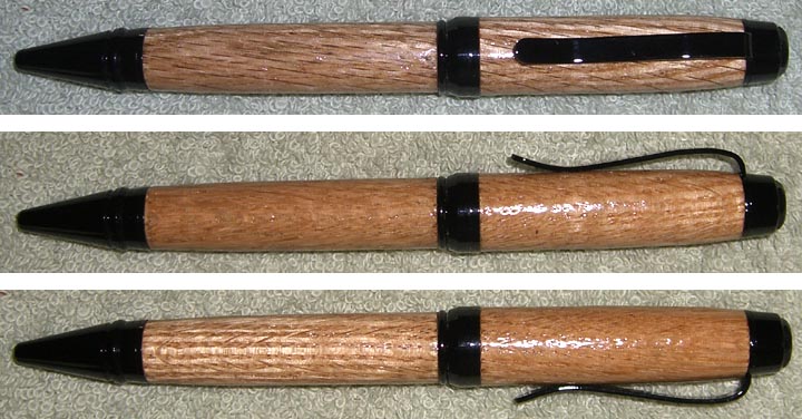

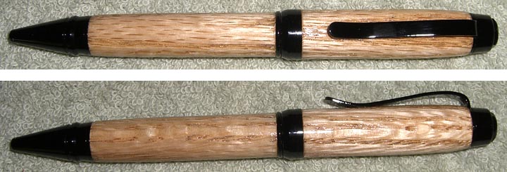

I've turned several pens from oak. I like it.

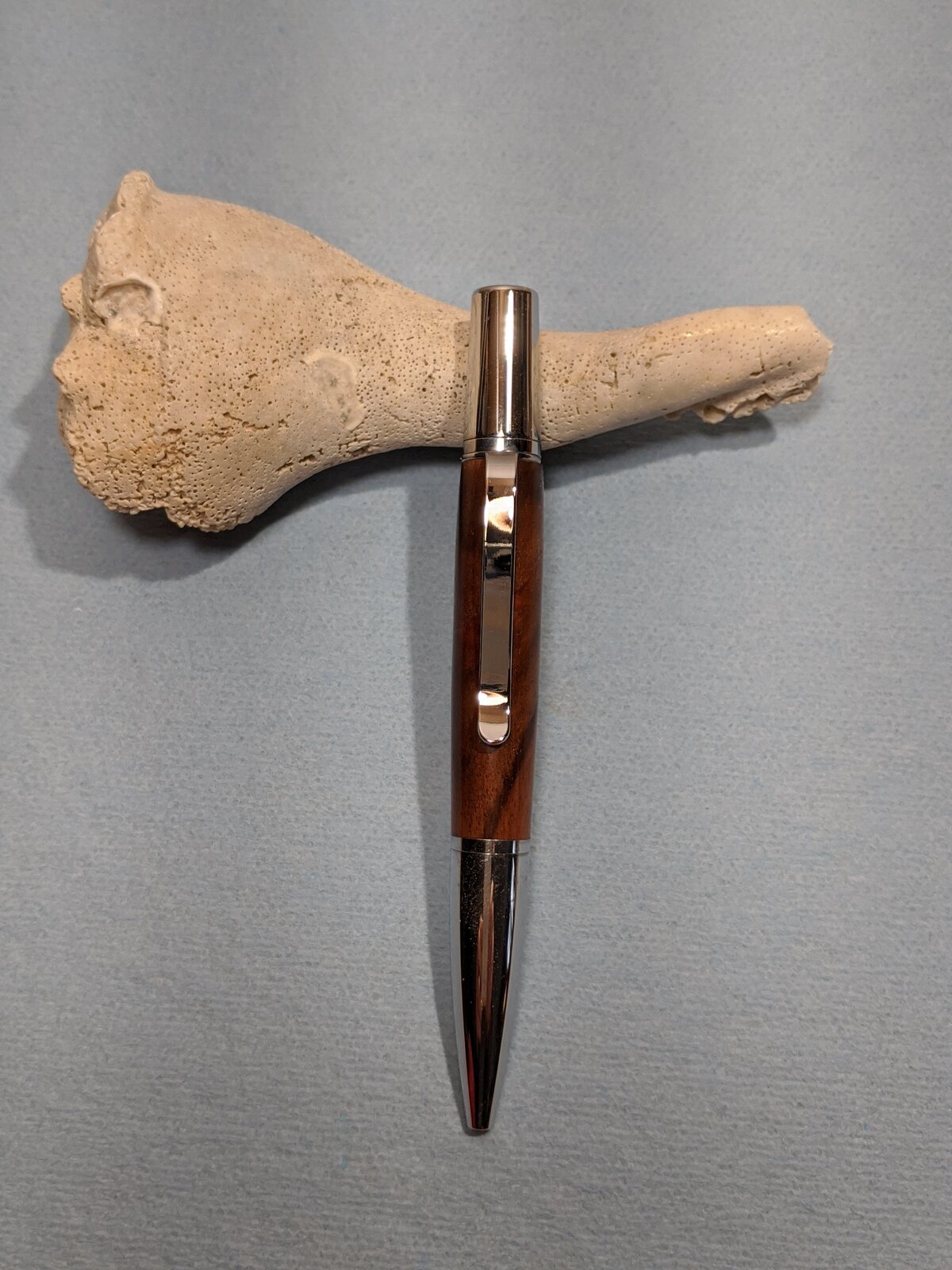

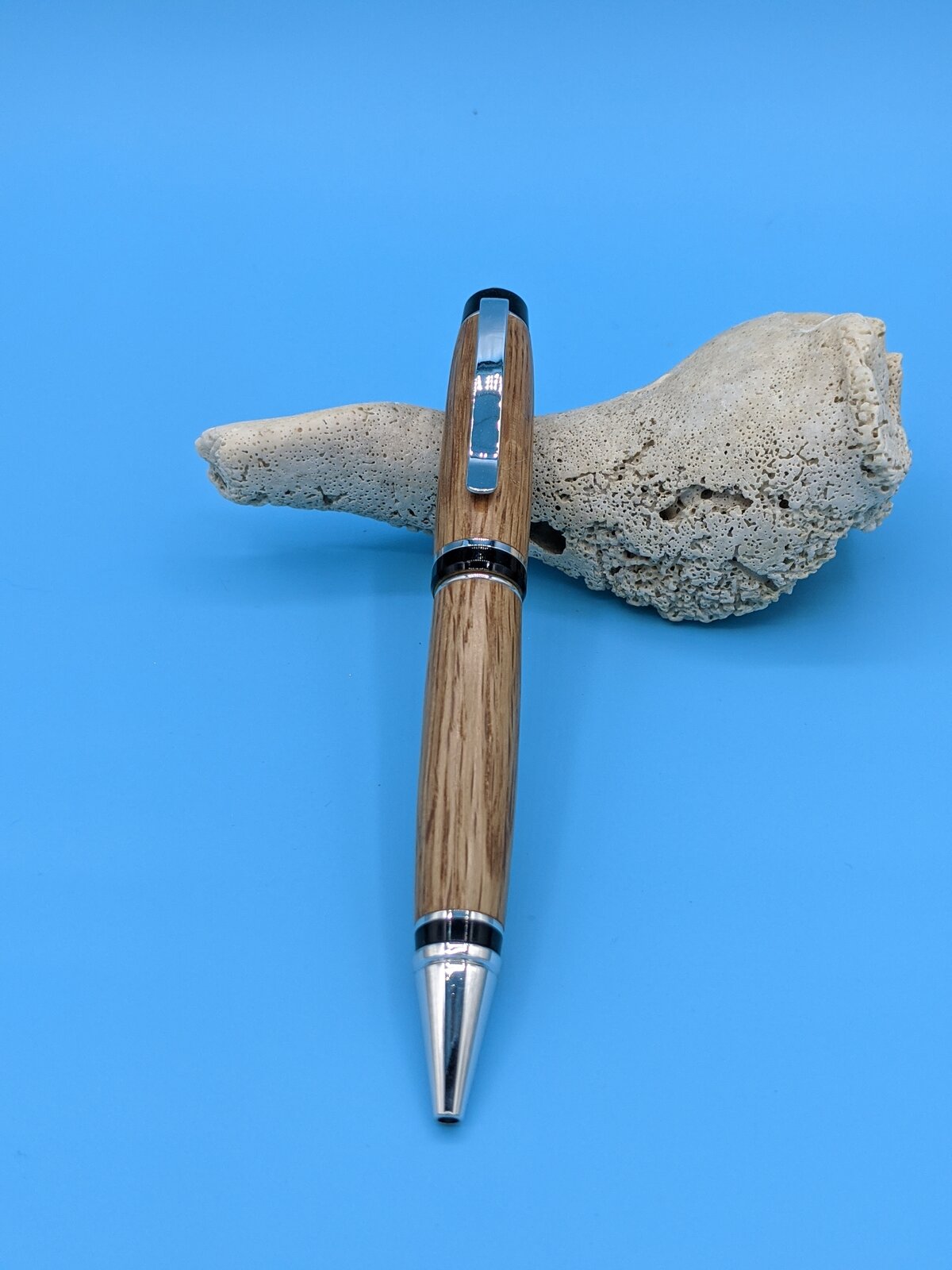

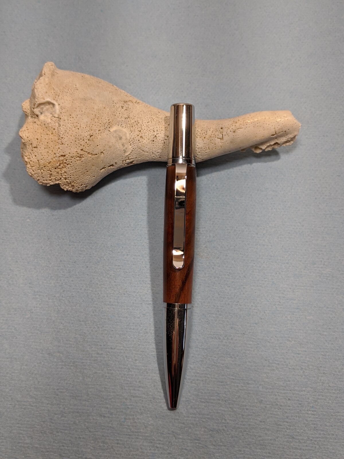

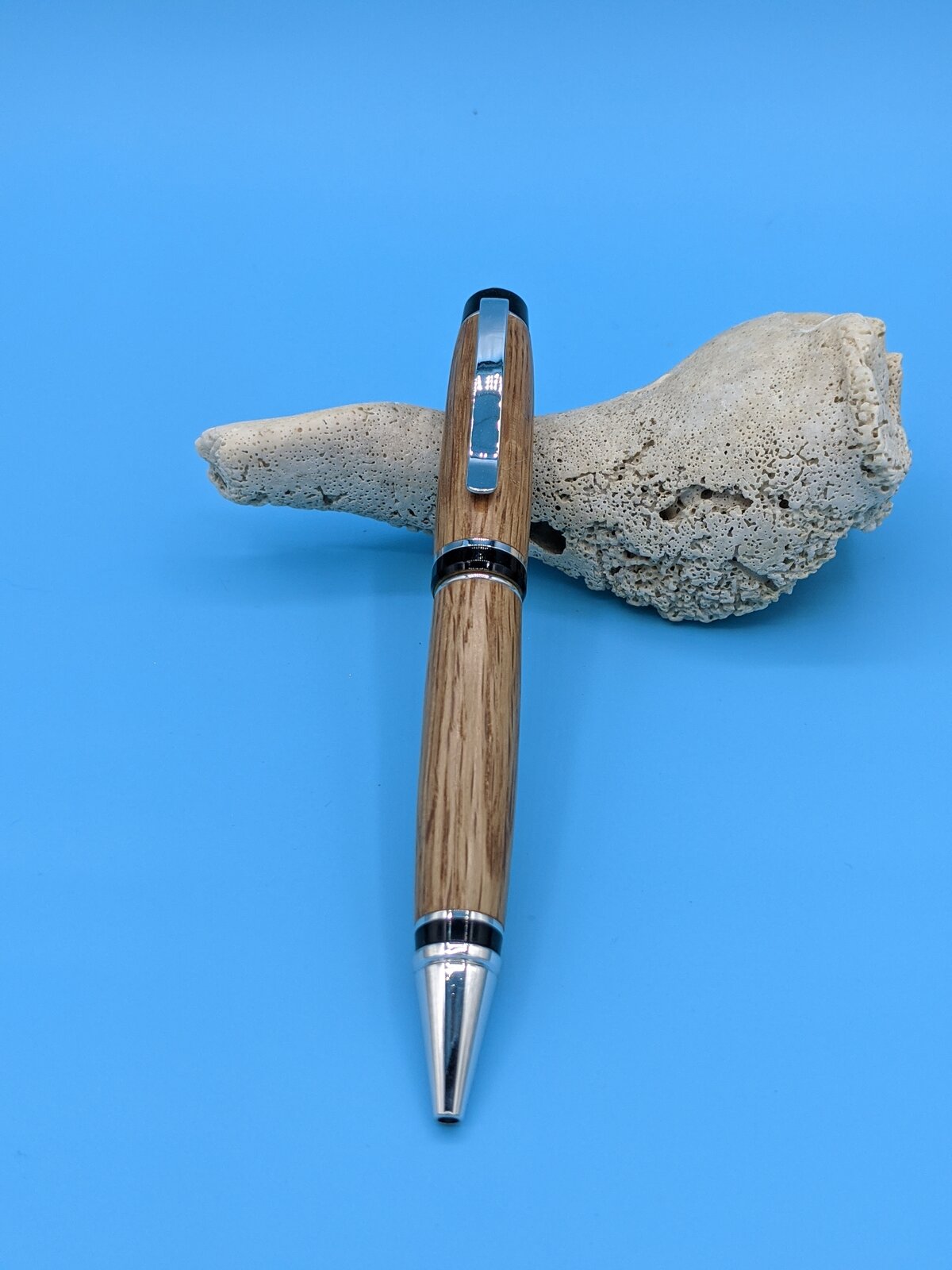

Here's a couple I turned recently.
Left PSI Bella in Walnut, right PSI Cigar in White Oak.
