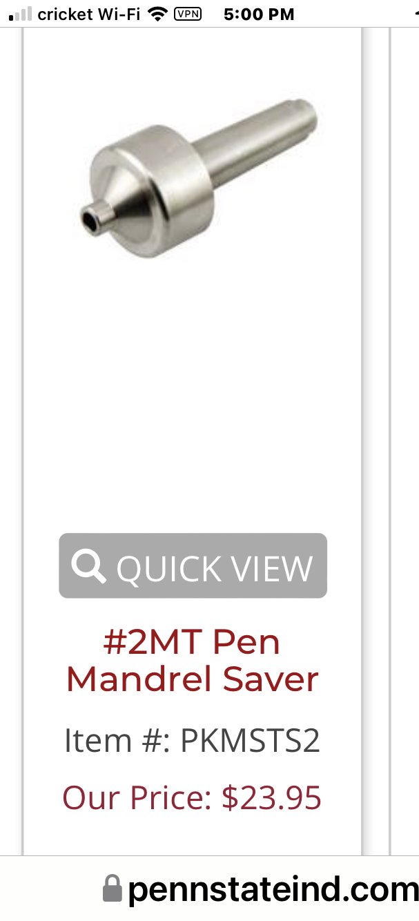

Nope. It may be great but the price is ridiculous. I use a very similar one from PSI. It too doesn't use a knurled screw but also a tailstock piece with a hole for the mandrel shaft. Works great for a MUCH lower price.

You have a link?

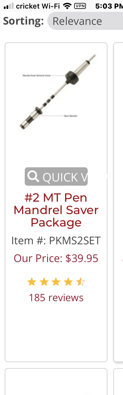

This piece goes on tailstock. Shaft of mandrel goes into hole, shortening overall length of mandrel shaft. They sell tailstock alone or tailstock piece with mandrel shaft. I've used for years and it works great.
TurningIdeas
Sep 19, 2022
11
USA
Thanks that's the one that I have, but it rattles too much inside the mandrel saver. Have found the turning between centers tool to be the best bang for the buck. Only down side is that I can't turn both cap and body at the same time.
