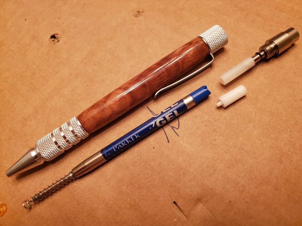

E erdman41 Member Joined Aug 16, 2019 Messages 7 Location Wisconsin Sep 19, 2019 #1 Hello 3/16 nylon bushing. Drilled it out to fit the clicker trimmed it to length. Sent from my SM-G970U using Tapatalk
KenB259 Member Joined Dec 24, 2017 Messages 4,131 Location Michigan Sep 19, 2019 #2 Awesome, that refill extender is my only dislike with that kit, as I've already lost one. Did you purchase the bushing? Sent from my iPad using Penturners.org mobile app
TonyL Member Joined Mar 9, 2014 Messages 9,068 Location Georgia Sep 19, 2019 #3 The ED Classic has the Schmidt mechanism without the extended..the barrel is longer. Also a nice kit.
E erdman41 Member Joined Aug 16, 2019 Messages 7 Location Wisconsin Sep 19, 2019 #4 Yes 19 cents at local Ace Hardware. 3/16" O.D. x 1" long. I just got the one with smallest hole and drilled out to fit. Sent from my SM-G970U using Tapatalk
magpens Member Joined Feb 2, 2011 Messages 15,911 Location Canada Sep 19, 2019 #5 Good on ya' !!!! . That's the way it should have been from the beginning. !! I'm almost willing to bet that PSI will modify the design eventually .... but not holding my breath.
Wayne IAP Library Manager Staff member Joined Dec 14, 2006 Messages 903 Location Troy, Wisconsin, USA. Sep 20, 2019 #6 Same thing was true with Woodcraft/Berea Sierra pen. They ultimately shortened the body to eliminate the extender. Before they figured it out, I shortened the body while making it. Last edited: Sep 20, 2019
