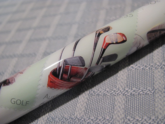

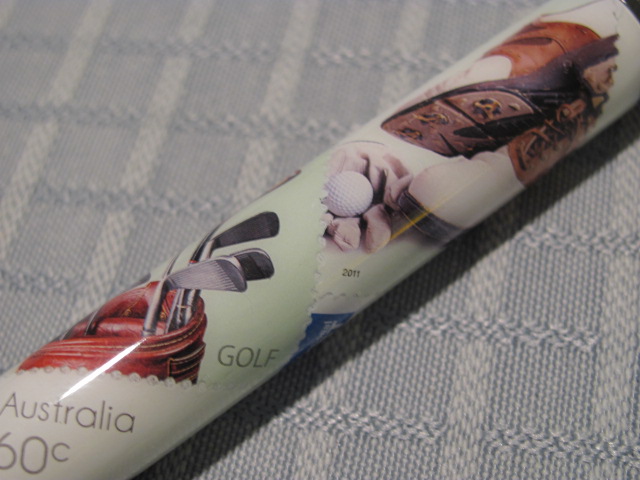

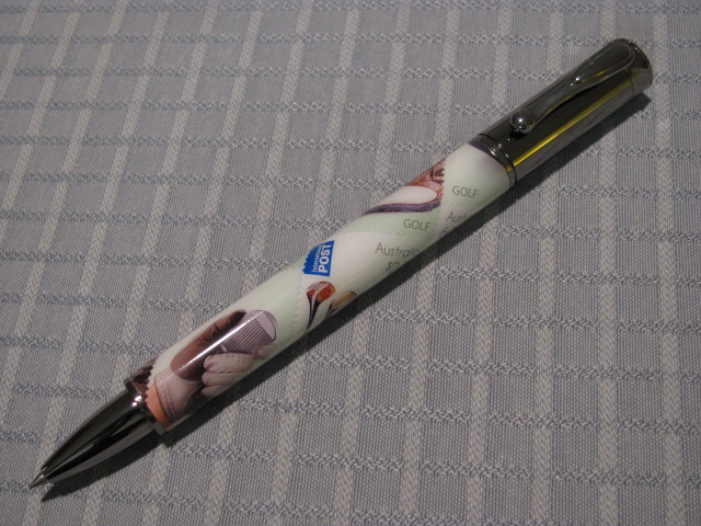

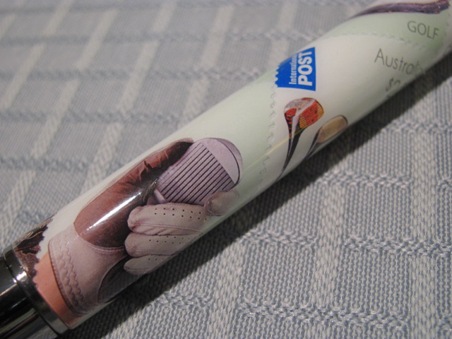

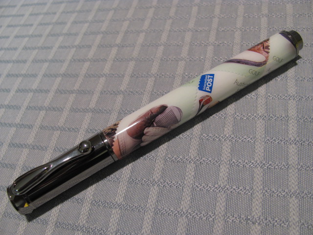

I wanted to make a stamp pen that would appeal to the golfers out there.I was finding it hard to find interesting golf-themed stamps,til I came across these cool looking 2011 Australia Presidents Cup stamps.
I've found that the stamps from Oz are really thin & fragile,pretty hard to work with but they do have a lot of nice looking stamps!
This one's over an acrylic core w/about 50 ca coats.
Hoping that some golfer likes it someday.Thanks for lookin!

Wow...!:eek: well, if one doesn't want or have the casting equipment/products, I suppose lots of CA will built up eventually.
I wonder how thick that the CA be, before it cracks from possible lack of flex/elasticity/expansion/thinking properties...!
I'm yet to go any further than 12 medium coats/layers so, I wonder if any of you guys and gals, have had any problems with too thick coat of CA...???
I like what you did with that pen, the stamps look very good. Another thing that I can tell you about some of the Aussie stamps is that, they have a real strong glue, its sticks pretty good, not a very good thing if you put the stamps in the wrong place, they don't comer out...!:mad:
Cheers
George
ossaguy
Jan 3, 2010
1,370
San Diego
Hi George,
I've never experienced any cracking,but I've only been at it about 7 months.Gosh,I hope they never do!
It's medium ca,and put on with paper towels that absorb a lot,so it's not as thick as you'd guess.Before the first coat it was .489,and finished it's at .512,so that's not that thick,I think.
I've done a couple using ca only,and they never cracked but the tinting effect of the accelerator makes the white of the stamp background a little darker,which I don't like.
As much as possable,I send my tubes in to Don Vann for casting.He does a great job on them.
Thanks,
Steve
BSea
Dec 28, 2009
4,628
Little Rock, Arkansas
That's a very cool pen. Great choice of kit so you can really show off the stamps.:good:
I made a pen out of cracked olive that used probably 40 coats of CA from thick to thin to fill the cracks. It really had a nice 3D effect. I gave it to my Dad, and he had it about a year before he lost it. But it never developed any cracks. I also reversed the bushing on a stretch fountain pen, so I built up the end I turned down too far with CA. Probably not the thickness of Steve's pen, but still much thicker than normal. I had that pen for almost 2 years before it found a home. It showed no signs of cracking. But it was kept in a pen portfolio most of that time.
