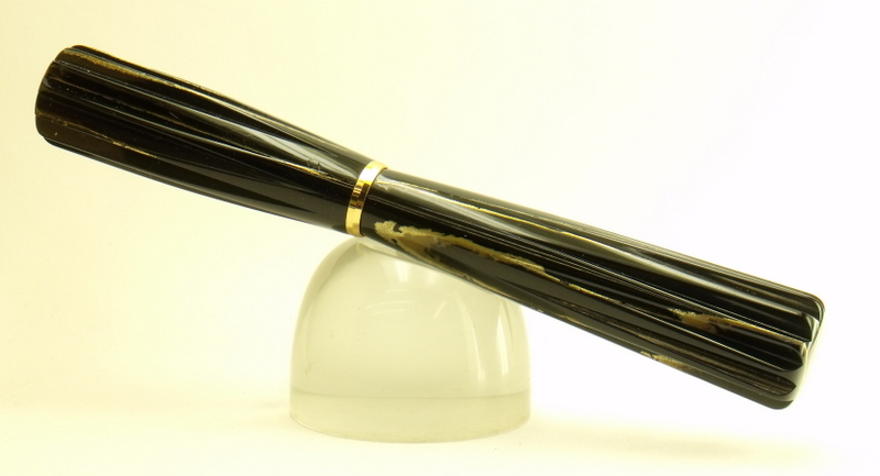

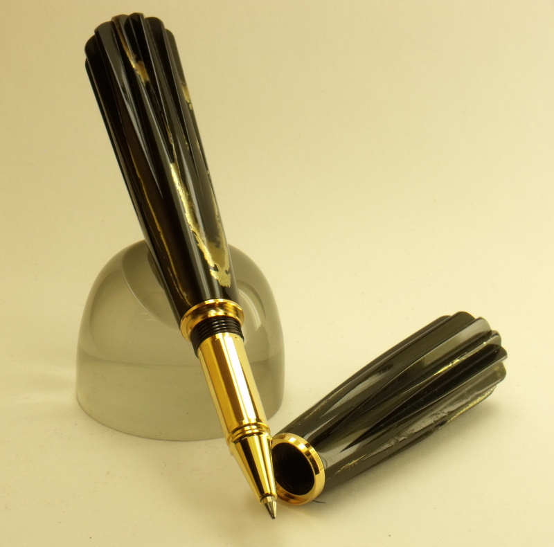

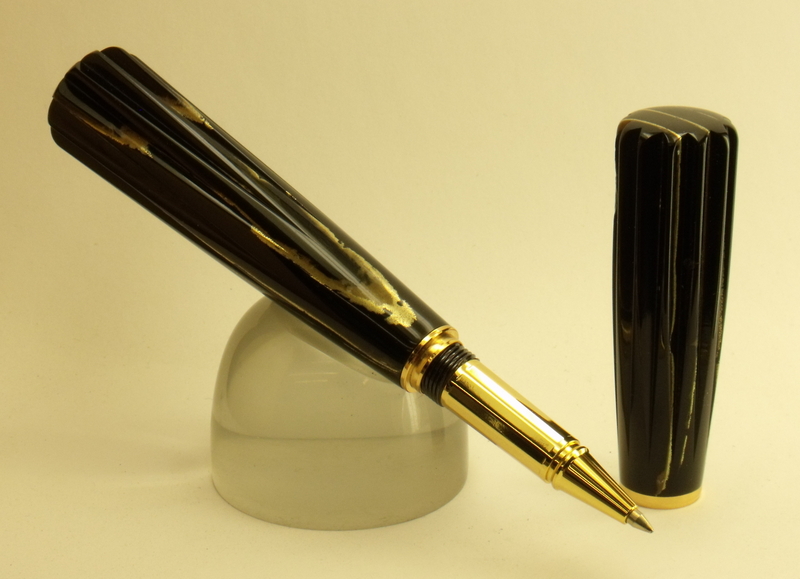

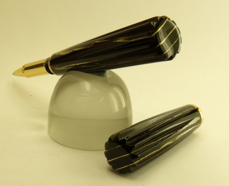

Don't worry, I had to look it up too.... a Dodecagram is a 12 pointed star.:wink:
Made sort of Panachesque shaped with bits from a Baron ( I think )
The resin is one of my own mixes.
Star points cut with the router, as usual. Hope you like. :biggrin:
Edit; Just added the rear view that shows the veins a bit better.:wink:

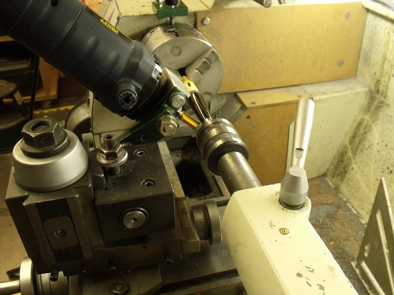

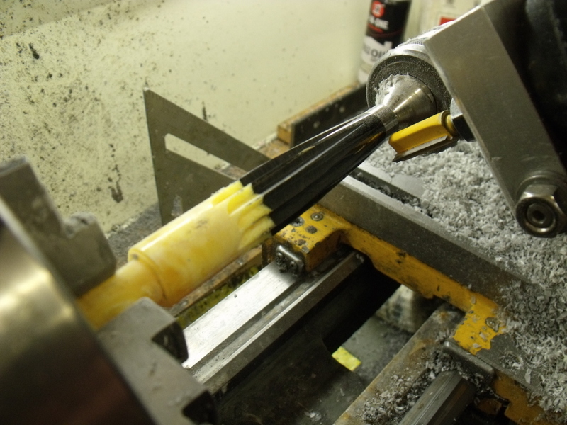

I like that !! ... Do you have a jig to mount your router on your lathe ? I would appreciate a photo of that ... or however else you may have achieved this interesting result ... please !

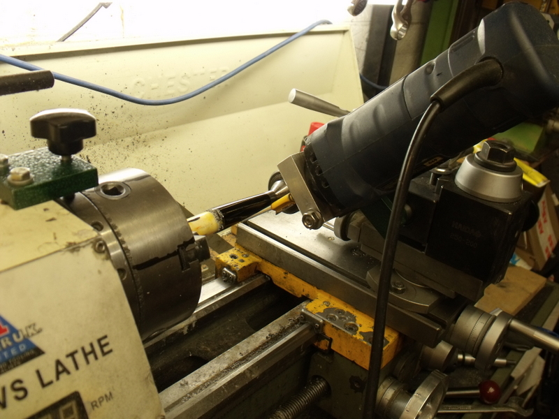

Mal, here's a couple of pics that show how I cut them. I'll see if I can find one of my old threads that show the mounting arm for the router and post a link.

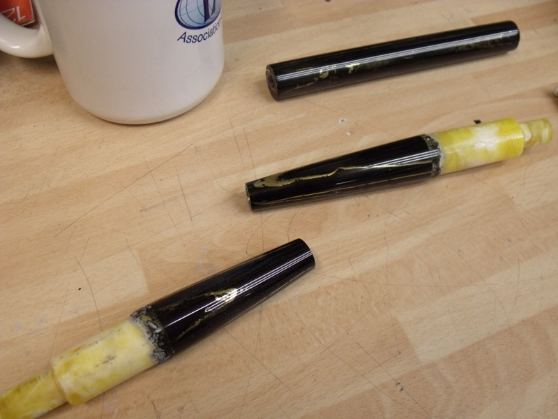

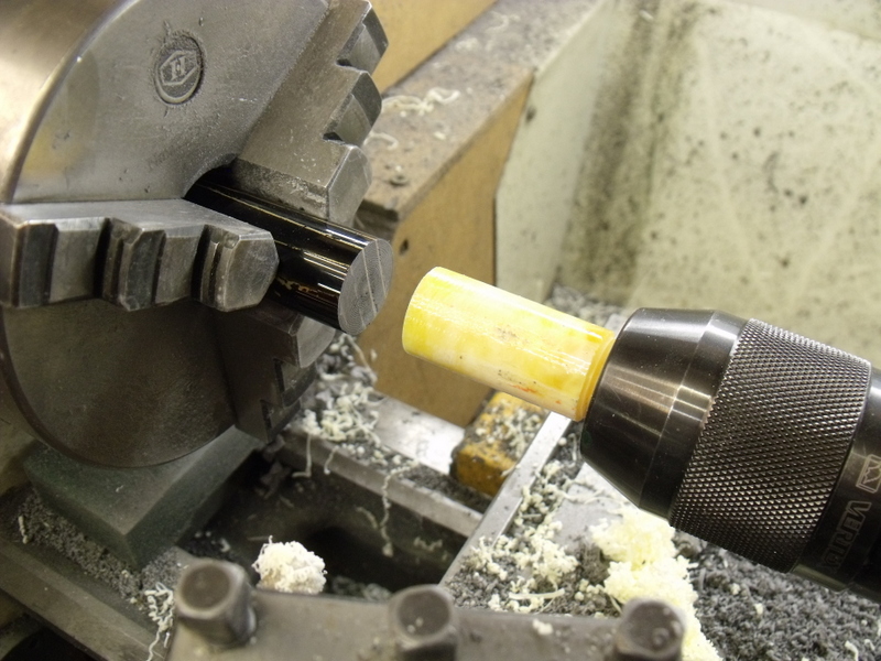

1. Glue a short off cut to the blank. This is the sacrificial piece that helps when you need to make a closed ended pen from one blank.
2. Turn the taper. The tubes are already in.
3 & 4 Set up the router at 45 deg and on the lathe centre line.
5. Index the cuts and trim the off-cut off. :biggrin:
Edit; Here's a link to the holder and other bits I use

I originally had just six points but I couldn't get them to come to a point at the back of the blanks without going with a far deeper cut. My index ring on my ML only has 12 indents so that's why 12 points.:biggrin:
