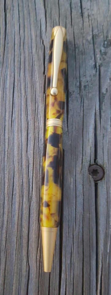

Pen Blank: Gold Quartz
Vender: Woodcraft
Cost: $4.99
The bad: Like a lot of Acrylic blanks, you need to back paint the blank. Marley wanted to make a pen for her teacher, and she picked this blank. I wasn't sure what color to backpaint but Marley picked yellow. So I went with it. This blank is very translucent, so be careful what color you back paint.
The Good: Not too brittle of an acrylic, turns and polishes nice.
I wet-sanded through the micromesh pads, and did a coat of wax. However if you are really using the wax to get the small scratches out, you should go back and sand the blank again, making sure to cross sand. This acrylic blank will have a very nice finish.
Would I recommend this blank? I for one, do not like the "chippy look" style blanks, and this is one. With how translucent it is and the "chippy look" I wouldn't recommend it.
