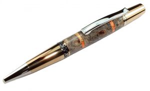

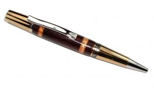

Rob,
I've done a couple using mixed metal leaf rather than straight gold, but I like the results:
Is this what you had in mind?
-Barry
