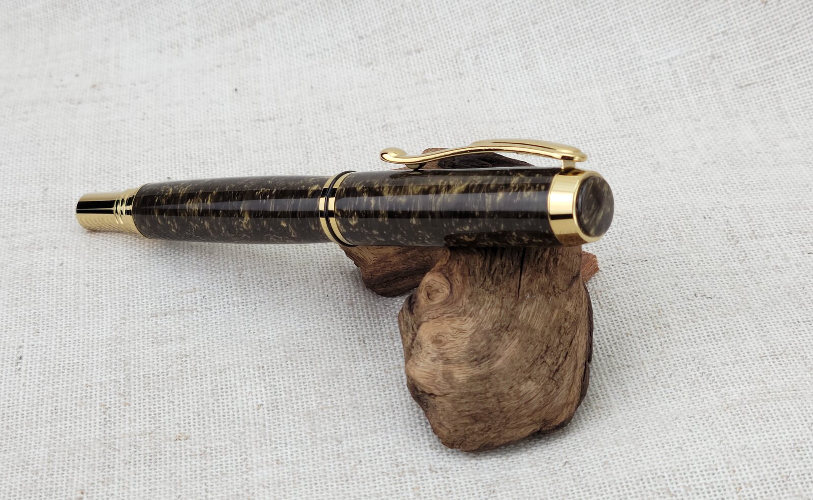

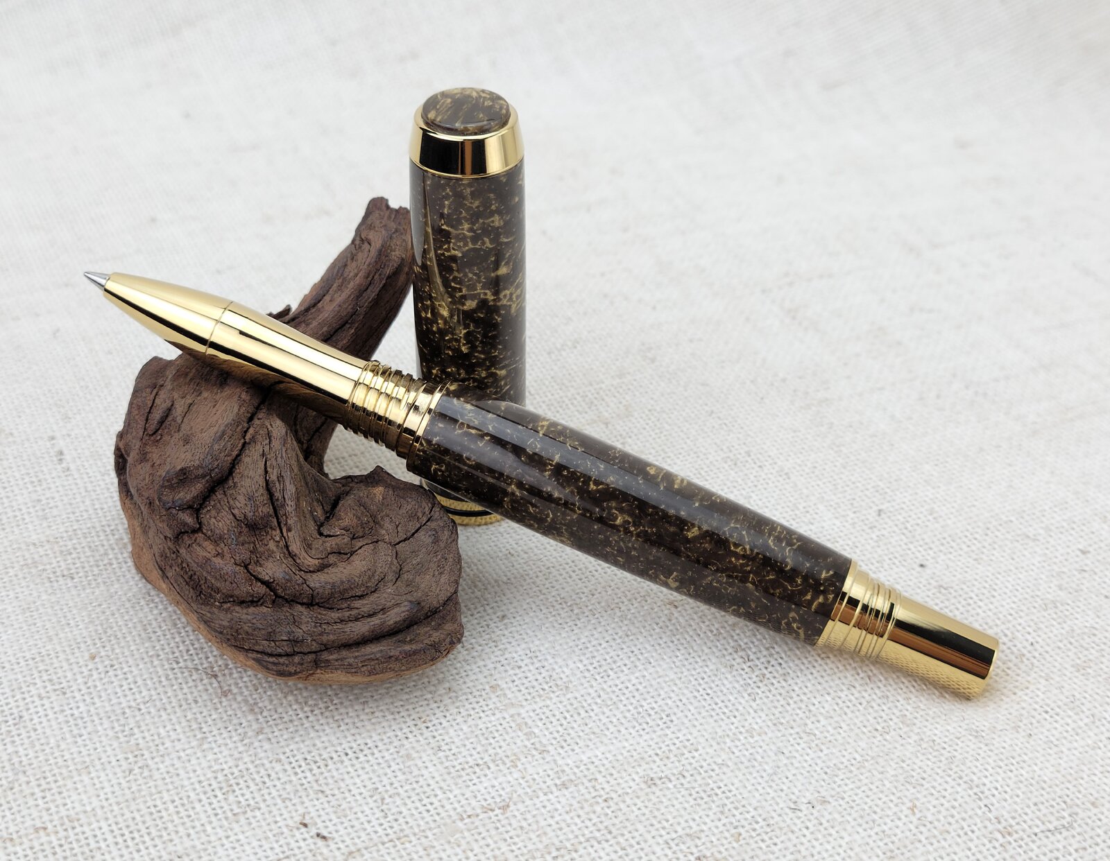

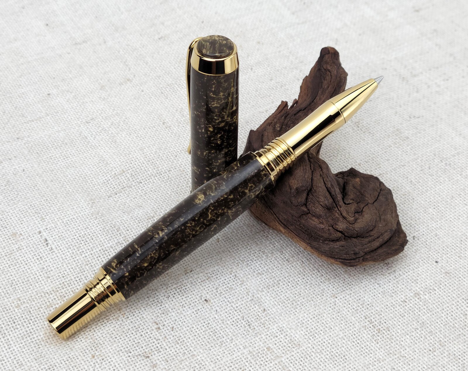

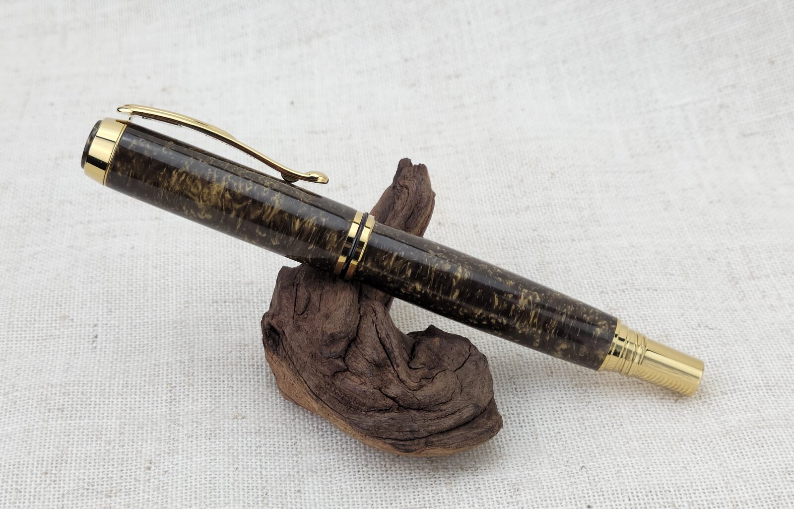

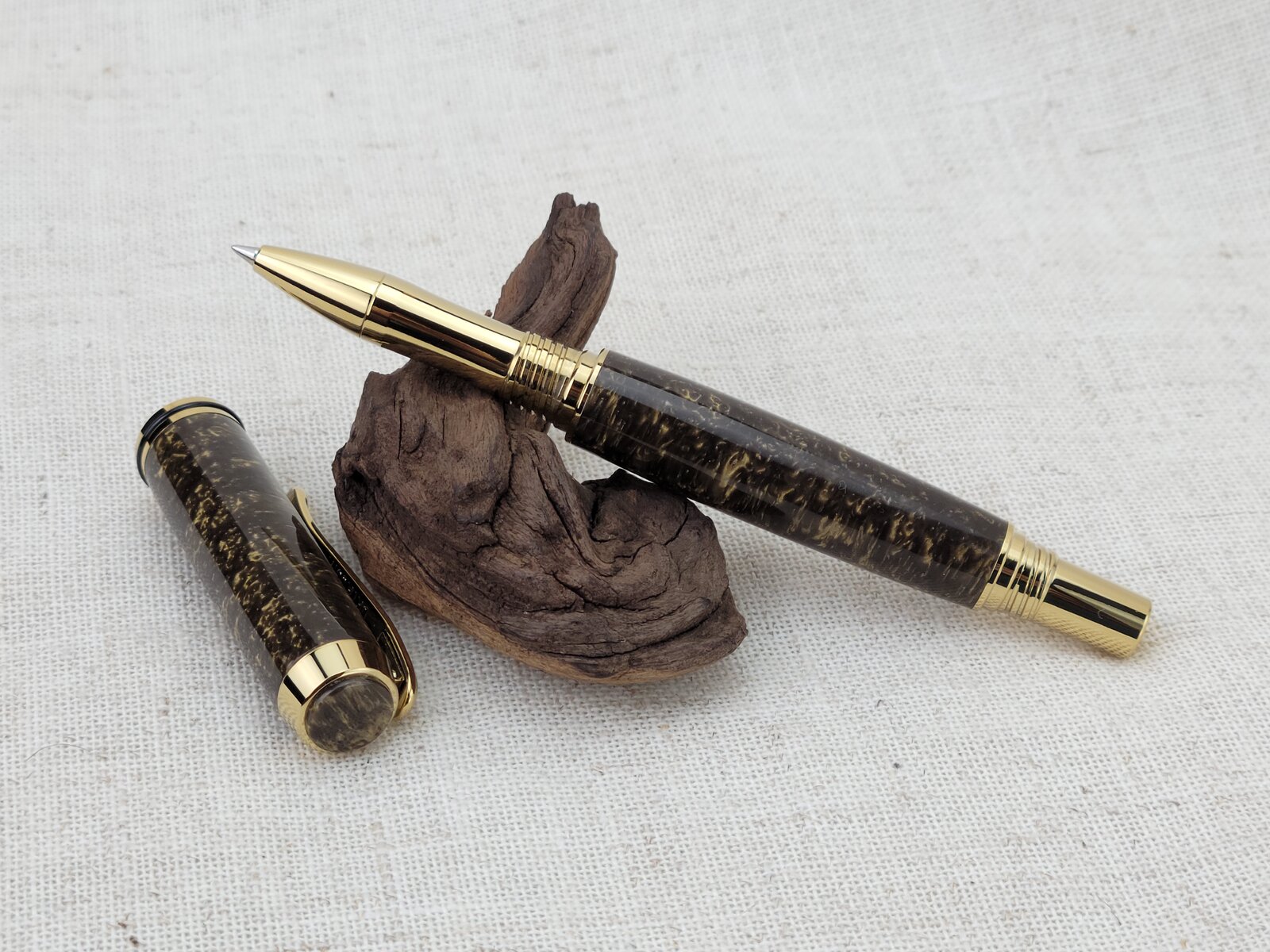

Jr. George in gold Ti with an antique gold Rhino blank. Polished through the 6 Zona grits, then the last 3 micromesh pads, finished off with some Meguire's plastic polish. I like the Jr. George kit for it's minimalistic hardware. This blank had some bubbles in it. I put a couple layers of thin GluBoost on the main barrel to fill them in there, but it didn't help and I just polished the CA off. They aren't really that noticeable anyway. I was pretty happy that I got the finial lined up so the least shimmery angle is the same as the least shimmery side of the pen. Is that too OCD?

Beautiful pen, Todd! What a perfect blank!
Love the photography setup as well...as always. ;)
