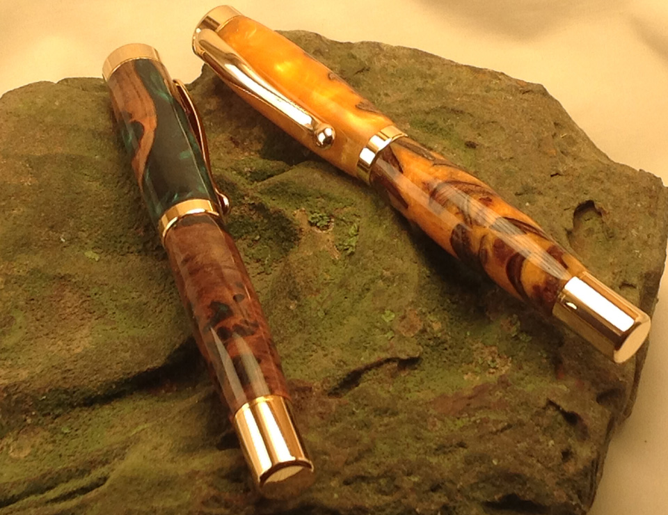

Pens #11 and #12. Gold Atrax RBs with Amalgam-Mutt blanks.
I found the blanks challenging to turn, but rewarding in the end result. Both blanks experienced an almost dime-sized blowout while turning. But I glued them back on and now can't even tell where they were. Had to sharpen the HSS chisels constantly. About 5 coats of CA, then some HUT plastic polish.
Photography still evolving. Used a cardboard coffee box with holes cut in the sides, wrapped in an old white tshirt, with work lights shining through. My wife helped with the photog, that's why the pic is as good as it is.
Happy to hear any constructive comments, either on the pens or the photography.

Or just change the white balance. If you are colorblind (like me) you can get an expo disc to create a custom white balance for the camera.

Thanks everyone for the comments. These were anniversary pens, the green one is mine the orange one is my wife's, she picked that blank out right away.

CrimsonKeel - thanks for the suggestion. My wife read your post and took them outside and photo'd them on a wooden bench and those pics were better. We're working on a photo setup that should help.
