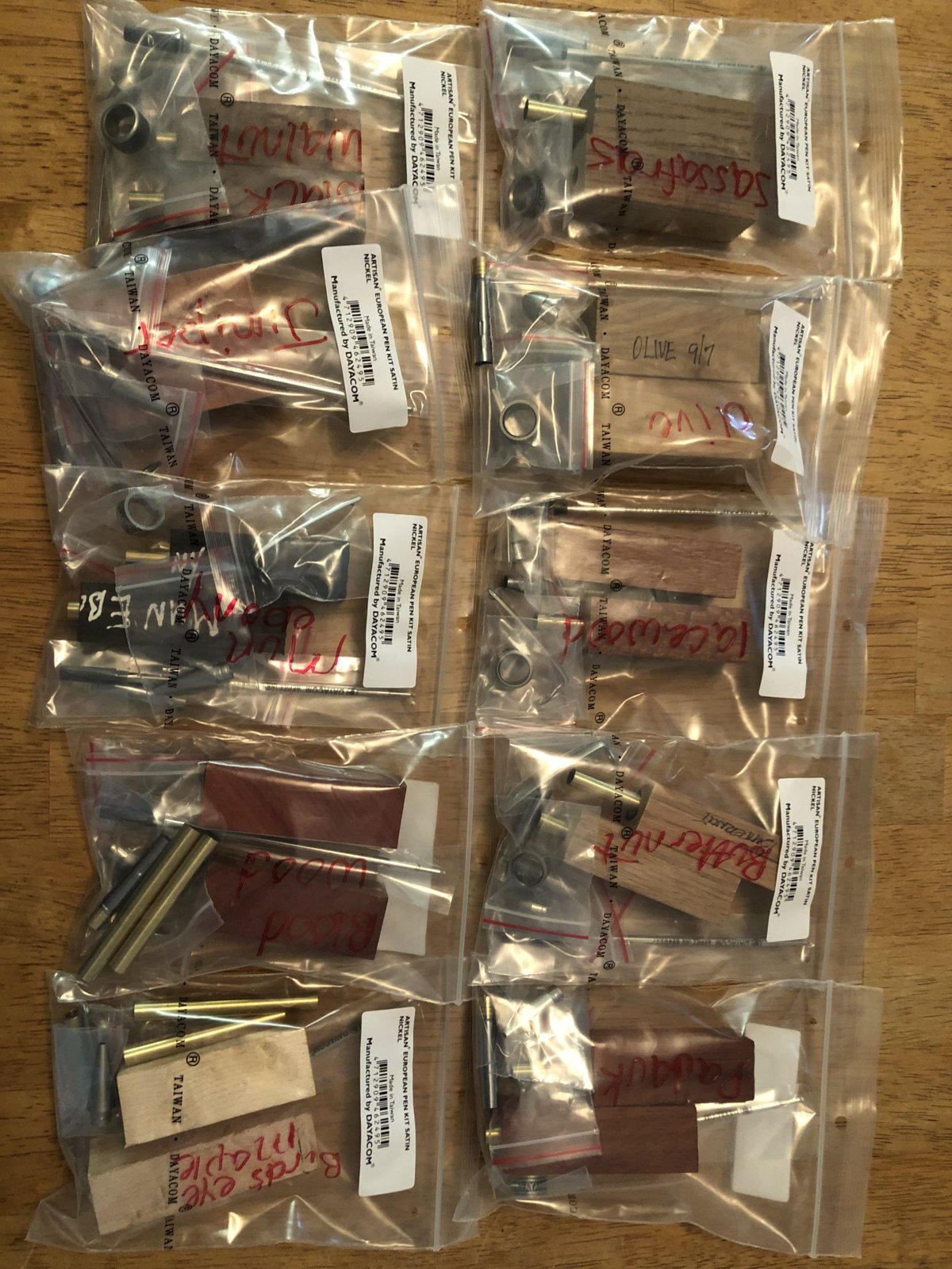

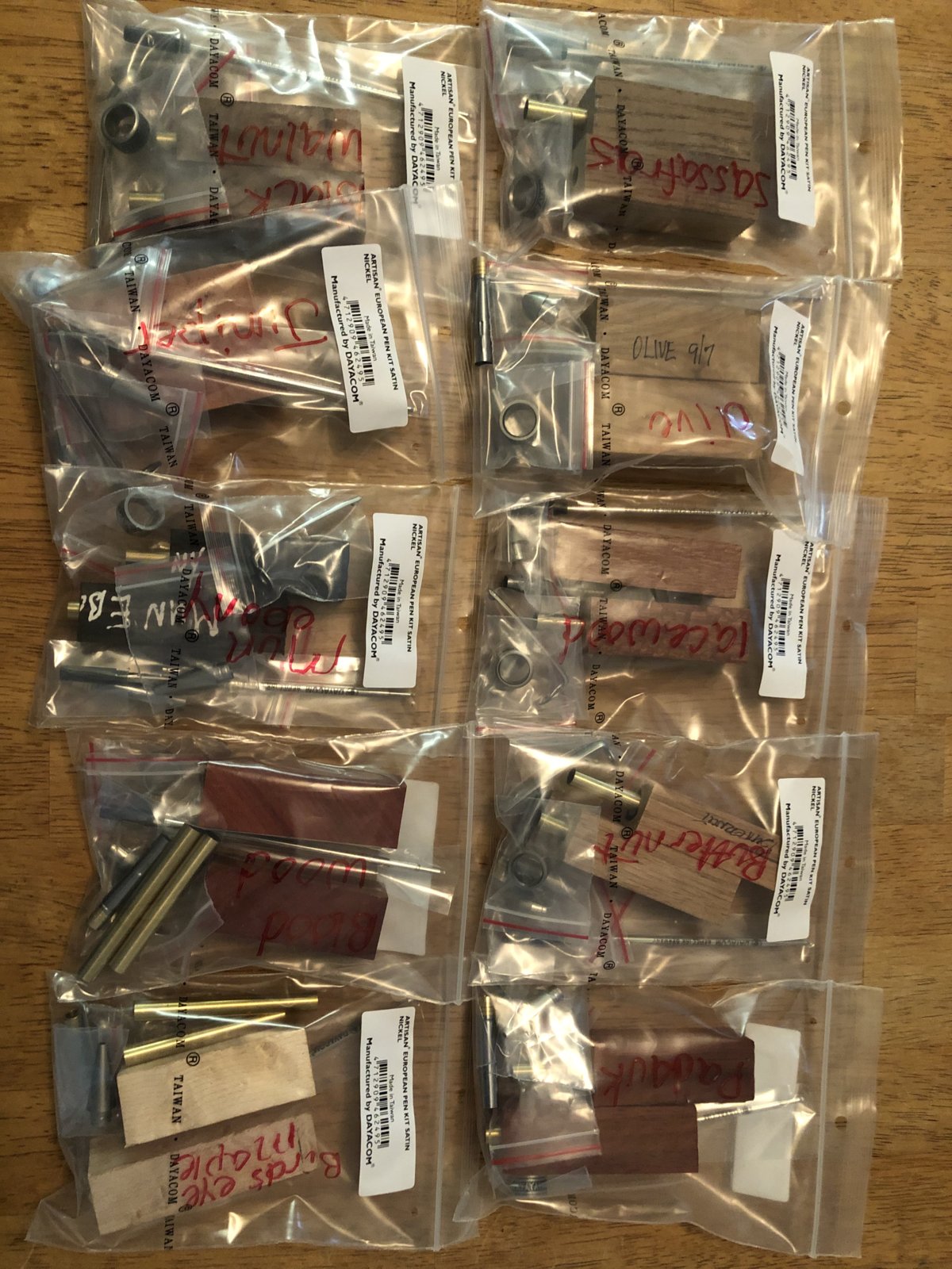

So all my stuff to start making pens is here (except the finish)...I got ten kits and have all the blanks cut and drilled...will epoxy the tubes in the morning and start turning tomorrow evening...I chose a variety of blanks so I had different looks...
I got the BSI 30 minute epoxy since I am doing a large batch and I have some bottle stoppers that need a little...I figured the open time would come in handy...

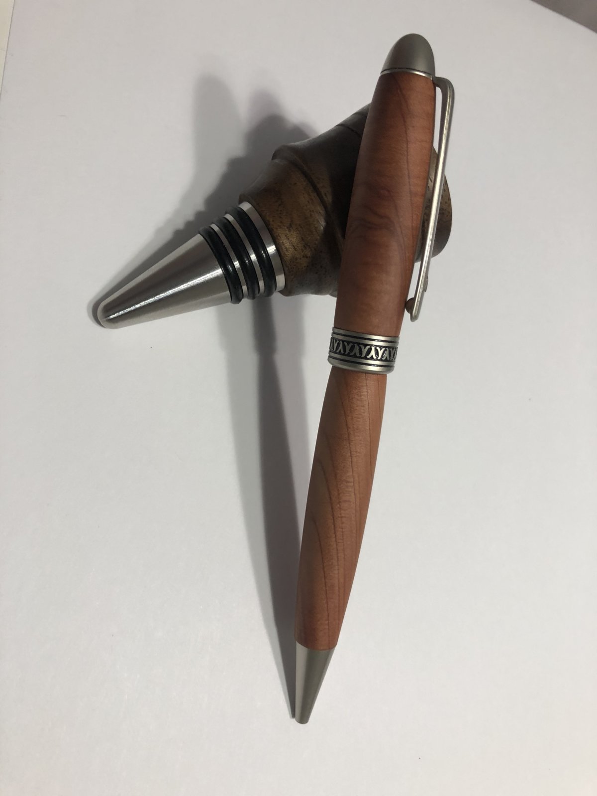

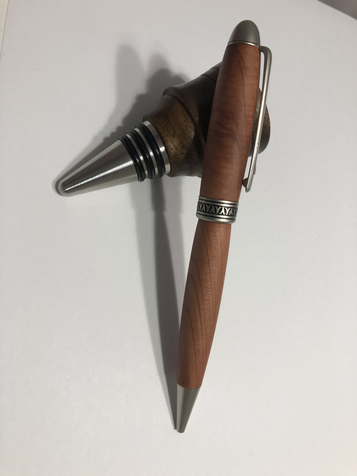

Well here is the first one done...this is Juniper with a Satin Nickel Euro kit...the finish is 2 coats of Waterlox and a top coat of paste wax...I absolutely love the finish...it is butter smooth, super matte, and really lets the natural beauty of the wood take center stage...
The mandrel that I got is not perfect and there is a slight OOR issue...I did try to rotate the blank a 1/4 turn every so often to minimize it as best I could...I did take Mark James advice and only turn one section at a time...
