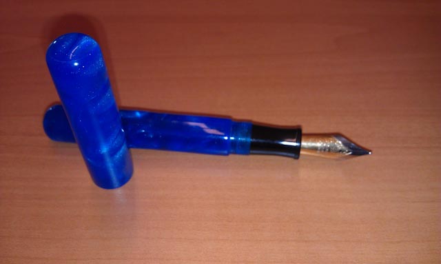

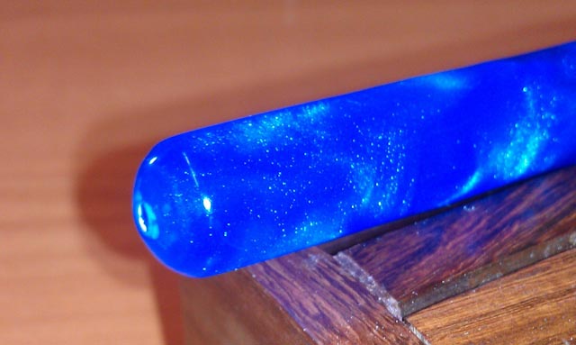

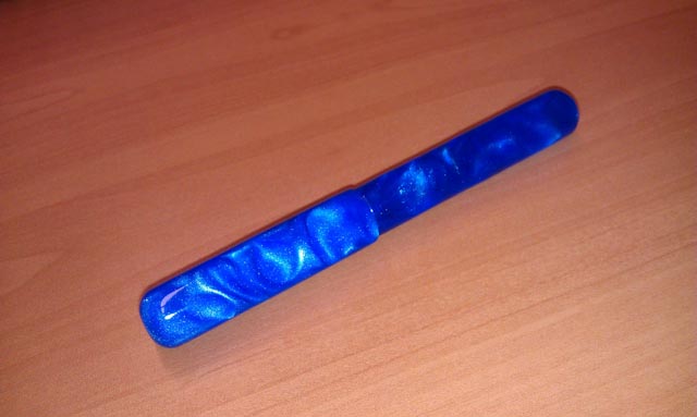

I'm making great strides (if "strides" is defined as "boo-boos"). I didn't get the drill bit stuck in the blank this time -- it had gone in a little deeper than my first depth-gauge told me, so when I parted the barrel off I got a little "pressure relief hole" :redface:

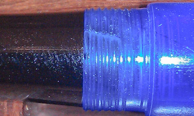

And at the other end of the barrel, when I screwed in the section ("borrowed" from a kit fountain pen), I split the material -- hadn't relieved enough of the internal threads to make space for the "step" at the end of the section threads :redface::redface:
The cap worked out pretty well, though -- so I now have a functional pen!
Next steps: I have some ebonite on order, when it arrives I'll make a screw-in finial for the barrel (destroying the evidence of the drill-through). Then I'll try making a finial and clip for the cap.
I'm still having fun, which is what really matters to me :cool:

Here's a fix tip for the slight drill through.
Mix up a small amount of 5 min epoxy and color it with some black paint. Load the hole where you drilled through and let it set. Once it's set shape it to the profile of the pen, polish it up and call it a detail.
Good work, it's a nice pen.

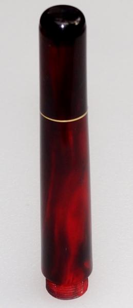

Boo Boos are just part of the custom/kitless adventure. Another thing you can do to the barrel, is make a screw in end so you can operate the converter without removing the section.
Here's what I'm talking about. I used the same tap & die as the section.
attachment.php
BTW, this is also my latest boo boo. I stripped the threads on the end of the barrel.:mad:

The metal ring is just a piece of brass that I cut from a sheet. It is loose between the 2 pieces. Before I parted the finial for the barrel I screwed the parts together with the brass, and did the final shaping. There is 1 problem with the ring that I'll need to work on. There is a small amount of play, and when screwed together, it can get a hair out of alignment, and you can feel the ring. But if you're careful putting it together, it works fine. That's ok for this one, but not what I'm after for future pens like this one. I'll probably do something similar to this in future pens as long as they aren't as transparent as this blank. But for clearer blanks, I'll have to do something different. I think the glue would show through & not look very good on a clear blank.
BTW, I bought the brass sheet at a hobby store.
