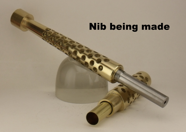

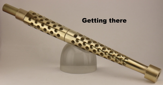

Frank, it's made from brass and weighs exactly 101 grams. As it will just sit in a drawer or maybe get squeezed into my display case, I haven't decided to plate it, lacquer it or just leave it.
The problem is, if you don't sell pens then what do you do with them all?
My wife, kids and close friends have more than enough of the more practical ones.
I actually get a lot more fun from finding ways to use my limited tools to find a solution to a problem than the finished product. :wink:

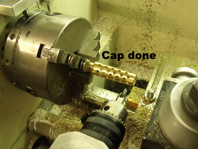

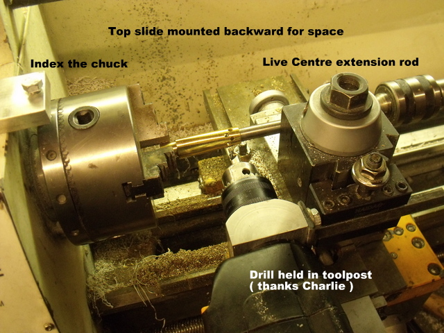

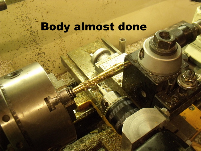

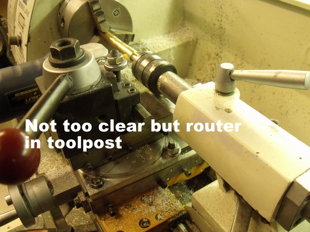

For instance, the tri-lobe shape was done with a router making one deep and two light passes on each lobe to create the shape and the 150 holes were done with a portable drilling machine. The lathe chuck was used to hold and index the pen and it's leadscrew was used to space the holes.
I'm away from home at the moment and can't remember if I took pics with my 'work' camera or better home camera. If it was with the one I have with me, then I'll post a pic or two. :smile:
On my work camera:wink::biggrin:
The one with the router isn't too clear, but I've shown that arrangement a thousand times anyway.
You can see the index block on the chuck, the backward mounted topslide and the live centre extension.
You can also see that it wasn't originally closed ended. I plugged it and then made the concave shapes in them:wink::biggrin:

Excellent Skip! That is very, very slick! I've thinking about how to put indexing on the chuck. That is a neat setup. How many indexing holes do you have on the chuck mounting plate?
Mike
Mike
Mike, I only have 12 holes so I'm limited to 2, 3, 4, 6.
However.....:biggrin: by indexing off the change gears, I can do a lot more.
Unfortunately the spindle is fitted with a 40 tooth gear which is ok but would be much more useful if it was 36 or 48.:rolleyes:
