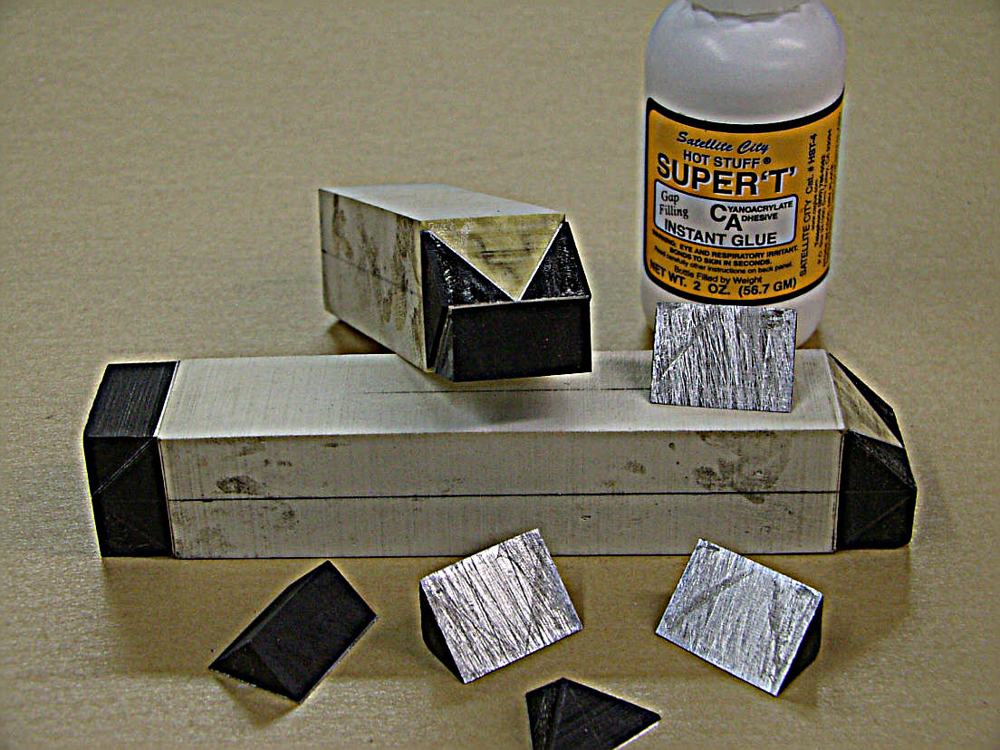

Here is an example of CA used on a blank and how easily it fell apart. Pieces fell off just with touch. So that was my first and last use of CA. I am in the school also of not using to glue in tubes. CA is just too brittle and has no give. That is a huge part of the problem.
