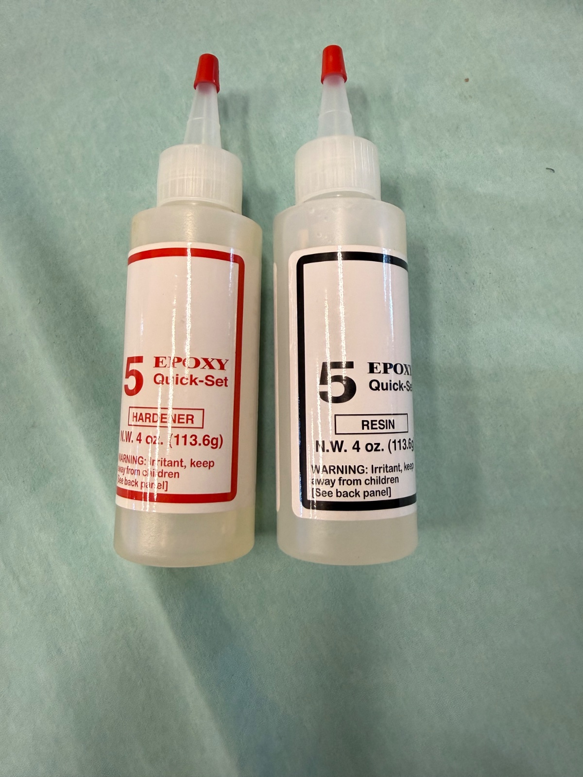

What 2 part epoxy gives you the best results? Four days ago I glued 15 sets of tubes to wood and acrylic blanks with Gorilla Glue 5 minute epoxy, started to square the blanks this morning only to find out that the stuff is crap. The heat from friction loosened them up and several blanks were ruined. Some blanks are still tacky from the initial glue up so I am more than frustrated.Suggestions are appreciated.
I bought the 4 oz. bottles of Two Ton epoxy from Amazon. Gives about 30 minutes work time so I can do a few pens on one mix. I let the blanks set overnight before turning. I used the epoxy for building golf clubs. Gives an idea of its strength. Some stores carry the syringes for a few bucks. I found one hardware store that used to carry it but had to buy six syringes. Cheaper to buy the bottles.
Edit: realize I had replied earlier. Now I do plug one end with modeling clay. Saves time with a file.
I've settled on DevCon 2-ton, 30 minute working time, and leave overnight before sanding to the tubes. It was recommended to me by a guy who made bows and arrows for hunters.
Try this. The folks that sell EZ Bond glue sell it. I've tried CA and Gorilla glue and both failed. The epoxy just works every time.
