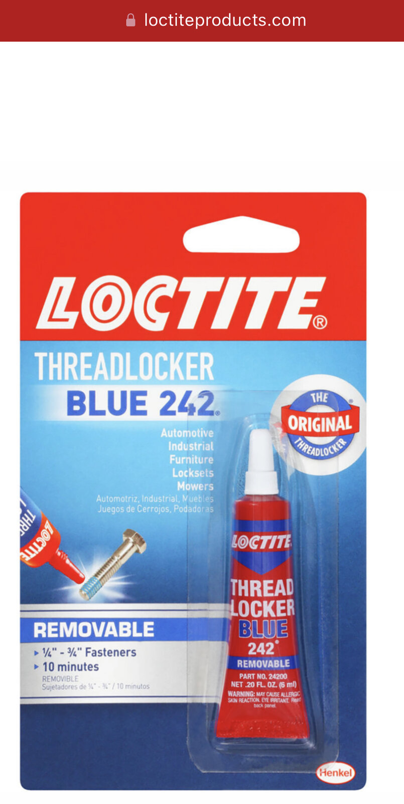

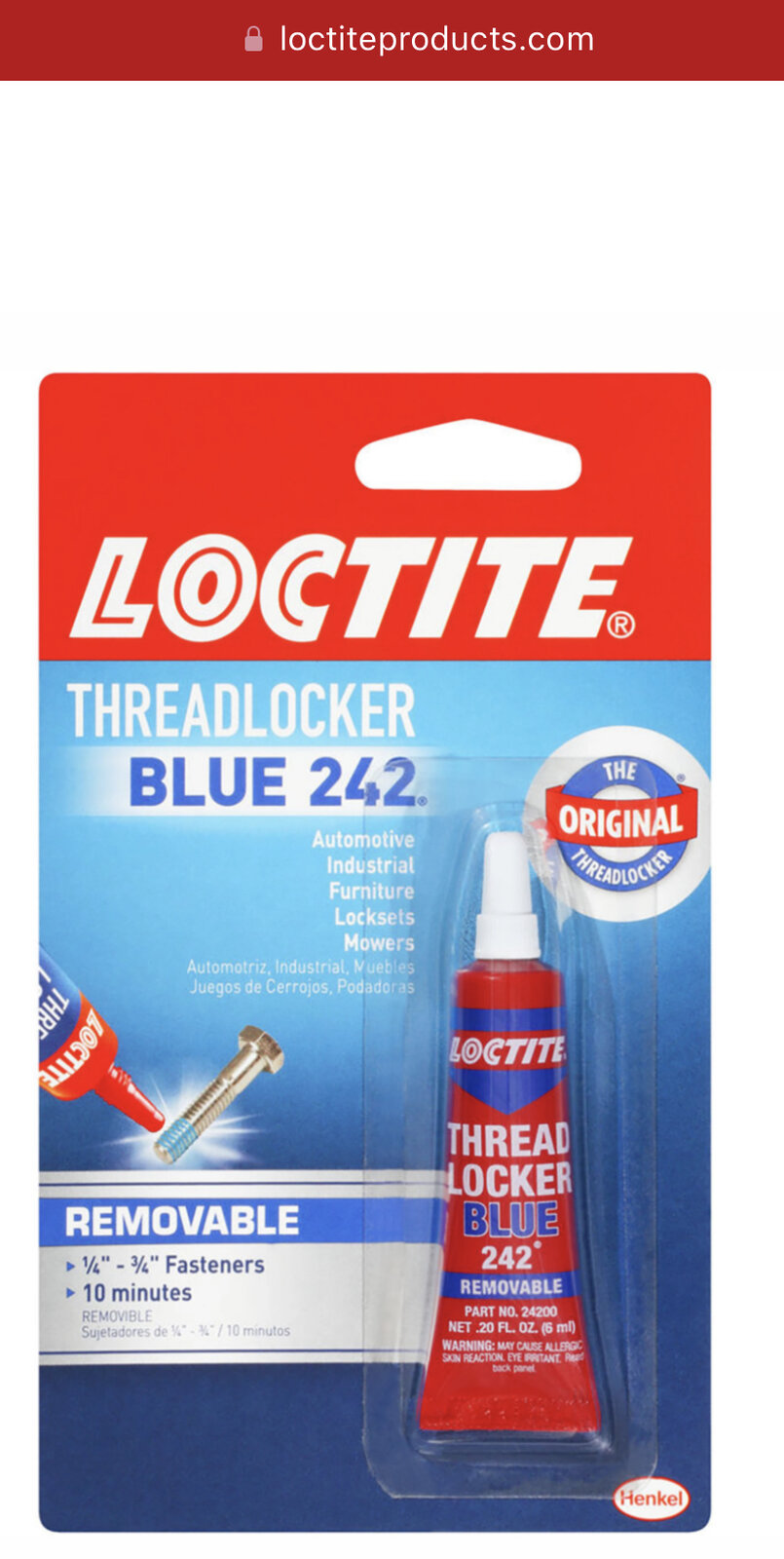

Is this the blue loctite super glue.
No, loctite is not a cyanoacrylic (ca) glue. It is a thread locking "glue" used to keep bolts and nuts from coming loose. There are several companies that make it. When blue is used, the parts can be taken apart with a little force. The red usually (but not always) requires heat to loosen.
