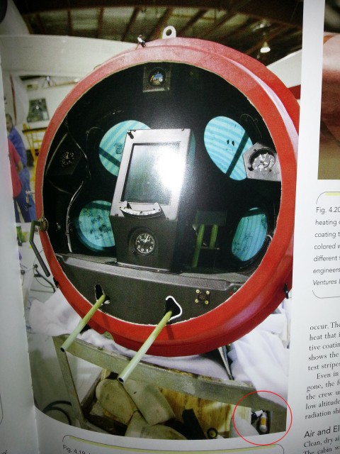

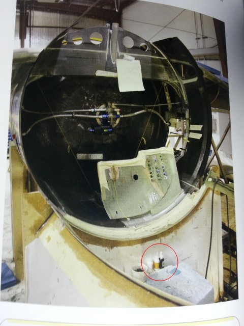

A lot of penturners are already using glues that are used in aerospace. Ever heard of Scaled Composites? They made SpaceShipOne, the first private manned spacecraft to reach an altitude of 328,000 feet twice in two weeks, and they are working on SpaceShipTwo, among other projects. They use Hot Stuff CA glue from Satellite City extensively in construction. You can see the glue in some pictures in the book SpaceShipOne: An Illustrated History. Check it out:
2 posts and 2 plugs. Not bad.:smile: I use your glues mostly for finishing but will tell you they are not my go to glue for segmenting at all. Epoxy is a better glue for those things and for tube gluing in my opinion. I will use CA when gluing acrylic to acrylic in a segmenting blank I am working on now because I need the quick turnaround because of the many joints I have to make. Hopefully it holds together.
You wanted to know which glue had been used in aviation or by NASA- how could I resist that plug? :smile: Actually, we have sold to NASA as well, but not often in large quantities, and we don't have any pictures of what they use it on.
