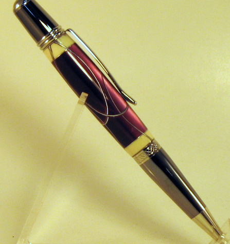

I do alot of segmenting and use various materials such as acrylics, metals of all kind, woods and so on. I use System3 T88 epoxy glue. It is the best epoxy glue I have found. They also have a 15 minute epoxy but warn you that it sets in 15 minutes so if your blank needs clamping time then I suggest you use the long open time glue. I tell this story all the time and yet I failed to follow my own advice just recently gluing up a couple acrylic segmented blanks and it kicked before I was satisfied to the way I clamped it. I tried CA glues and they did not work well for me so do not even bother any more. I agree you need to add some tooth to the faces of all materials and for that I usually sand with 100 grit paper or 120 grit whatever I grab first. You can look at my album and see many examples of these in there and will tell you all were glued with T88. good luck.
Yes drilling needs to be done slow and with sharp bits as well as turning you need to use sharp tools. Go slow and the outcome will be worth it. I never wrapped my blanks and never found a need but to each their own.
I should also mention I allow at least 24 hours for glue to cure and not just dry. I am never in a hurry to make any pens for I do this as a hobby.
https://www.penturners.org/media/users/jttheclockman.999/
