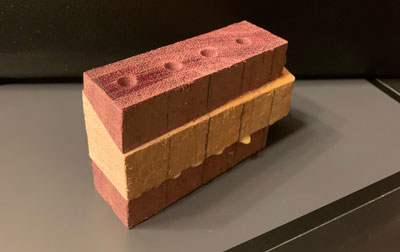

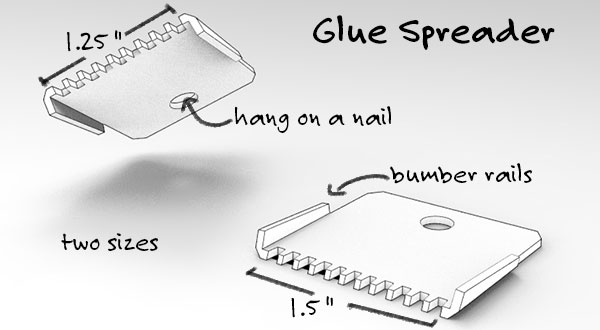

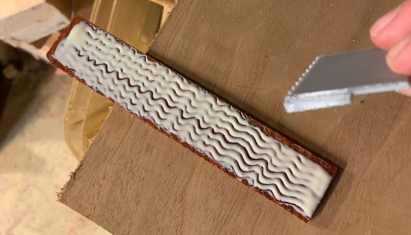

Nothing fancy, but I designed two sizes of spreaders to distribute wood glue when segmenting.
They are cheap, easy to print and last longer than expected if promptly wiped off.
The bumpers have kept things neater too... or more accurately "less messy."
3D Print Files:
Saved as obj files.
1.25 inch file: Outer Dimensions: x 41.524mm; y 4.553; z 37.197
1.5 inch file: Outer Dimensions: x 41.524mm; y 4.553; z 37.197
If you scale these to other widths I suspect they'll continue to work.

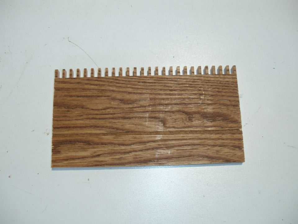

For those of us without 3D printers, here are some simple alternatives:
* Save some empty gift cards and other similar plastic. Cut one edge with pinking shears. Done. (The local woodworking stores save empty, expired gift cards for just that purpose - glue spreaders. Local woodworkers who want a few just ask.)
* Save your box joint jig test cuts to make glue spreaders. See below for an example test cut in a scrap of old paneling.
* To be honest, most of the time, I use the black flat glue spreader that came in the Rockler glue kit. Dried wood glue just peels off.
WARNING: Do not use those glue kits for non-wood glues like CA, epoxy, or Gorilla Clear glue.
https://www.rockler.com/rockler-3-piece-silicone-glue-application-kit
Photo: Box joint jig test cut in old paneling scrap.
I made the jig for this project:
https://www.penturners.org/threads/razor-stand-with-counters.173245
