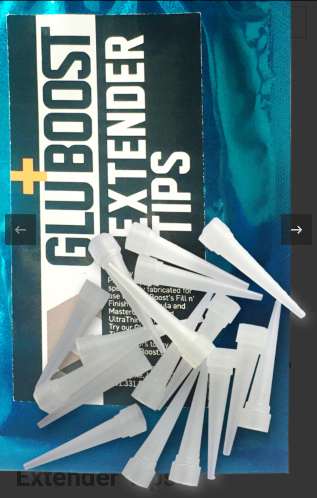

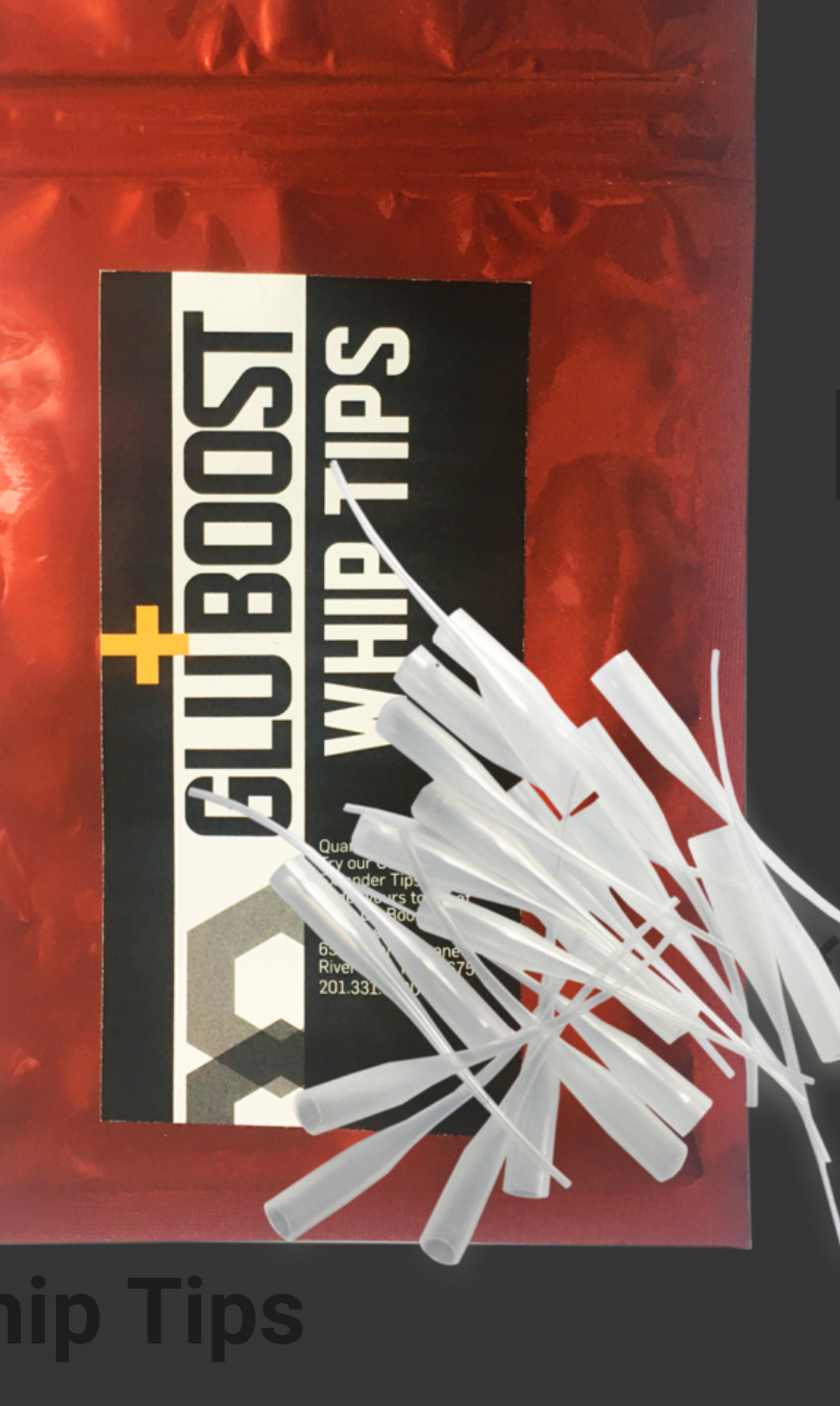

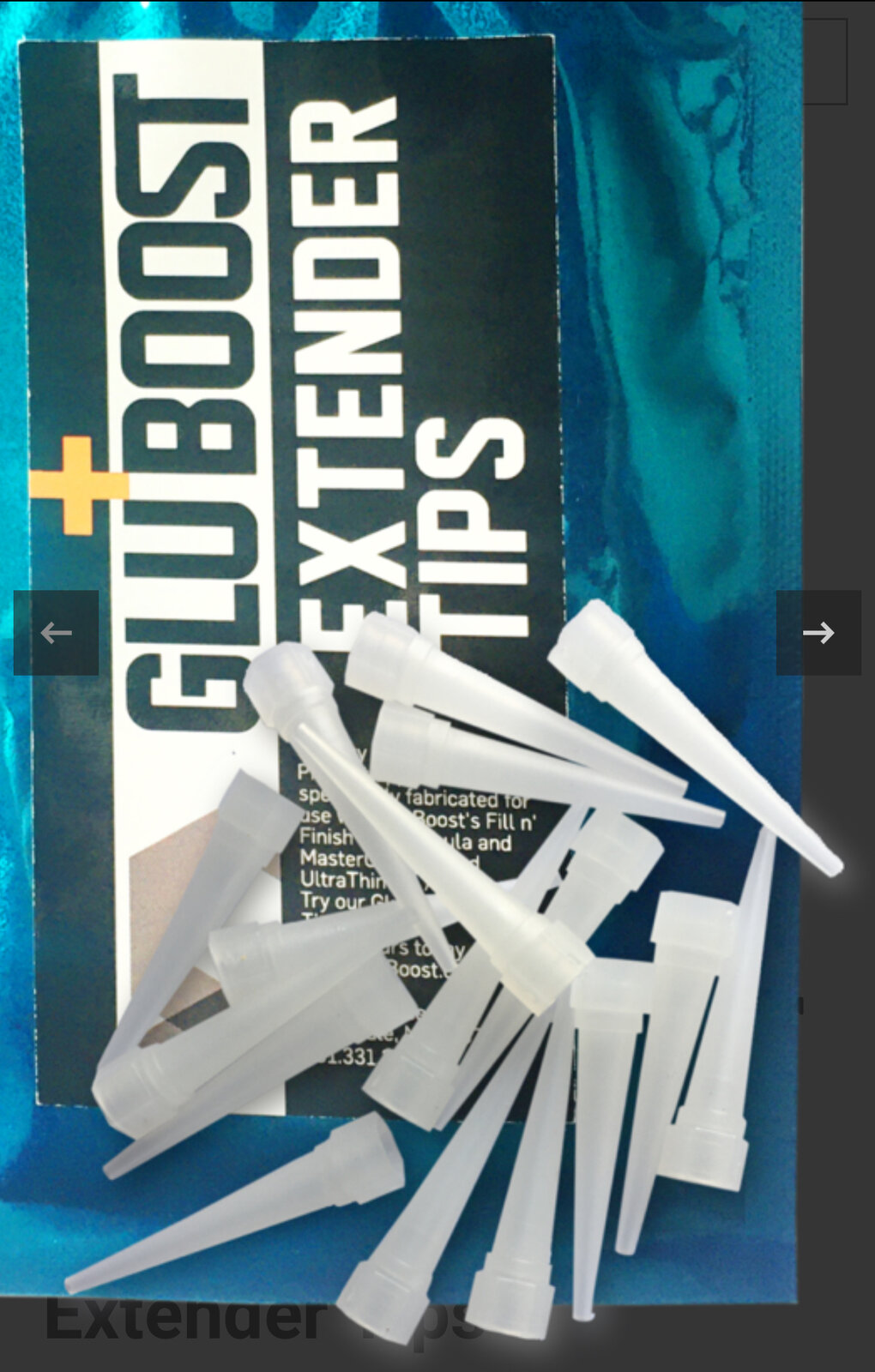

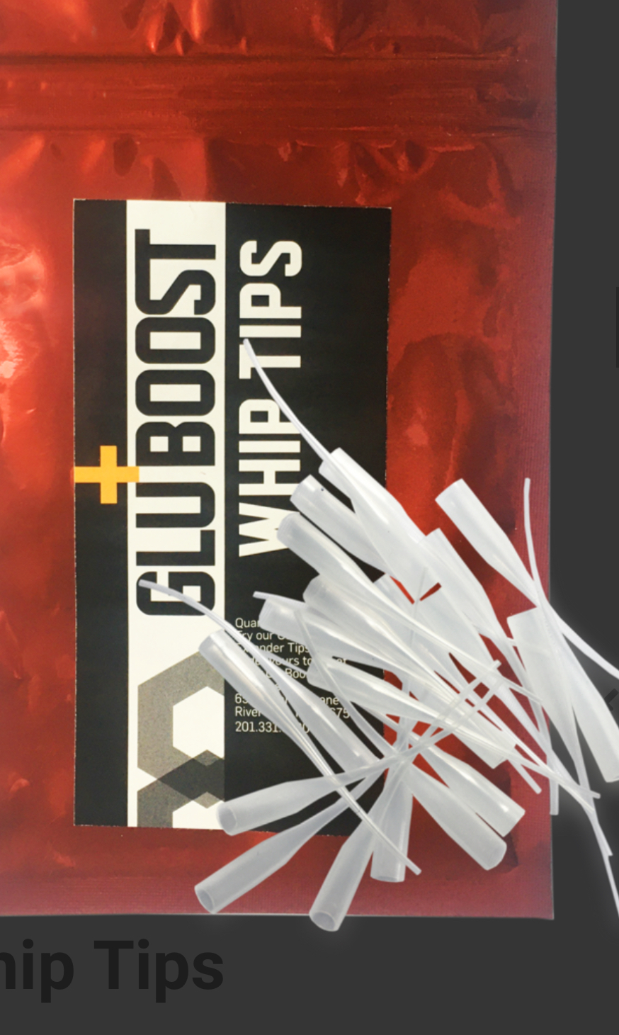

There are two types of tips that come with Gluboost when ordered from Exoticblanks for you to try. Just make sure you are using the proper one. The Extender is a larger opening for the thicker glue… like the orange and blue label, and the Whips for the ultra thins. Both will help you put the glue right where you want it and conserve your product. It will also help you not glue yourself to the bottle or project. 🤫
