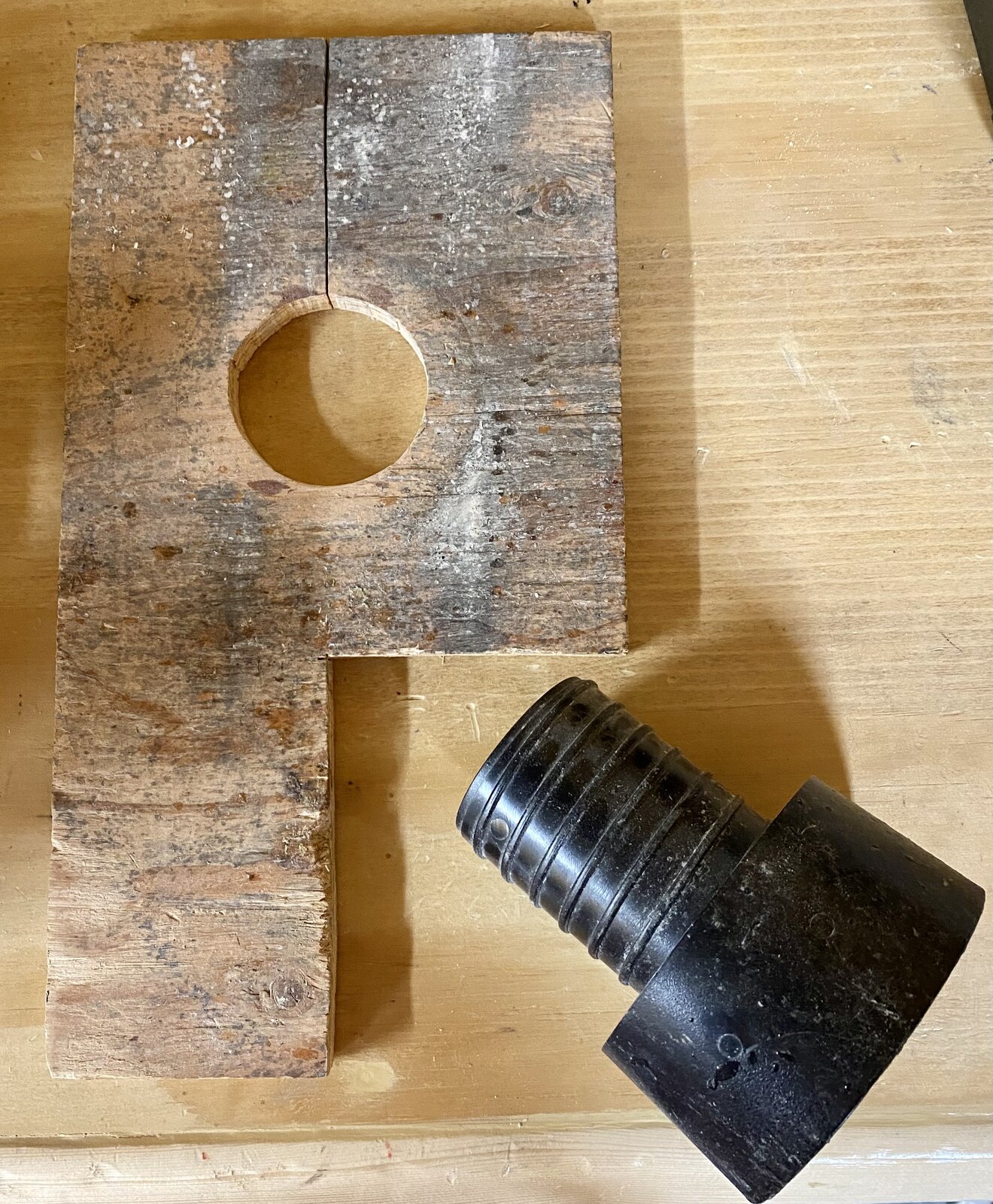

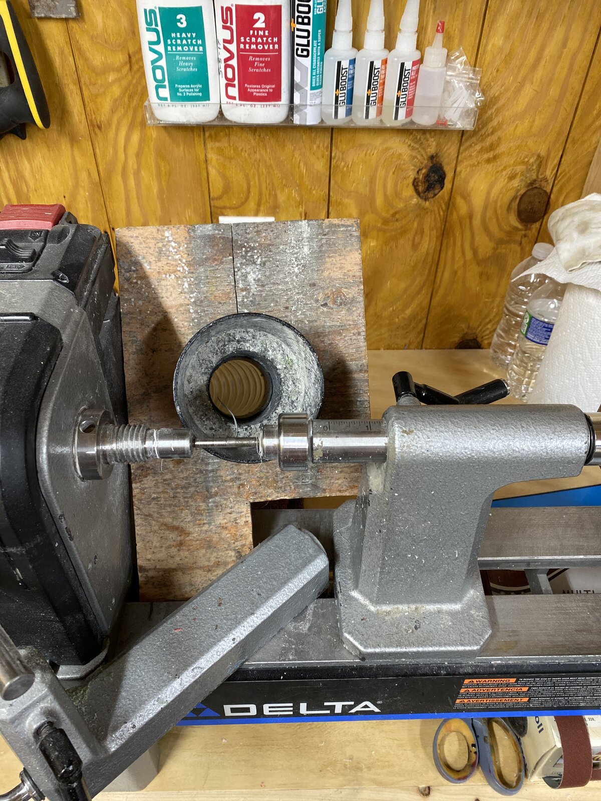

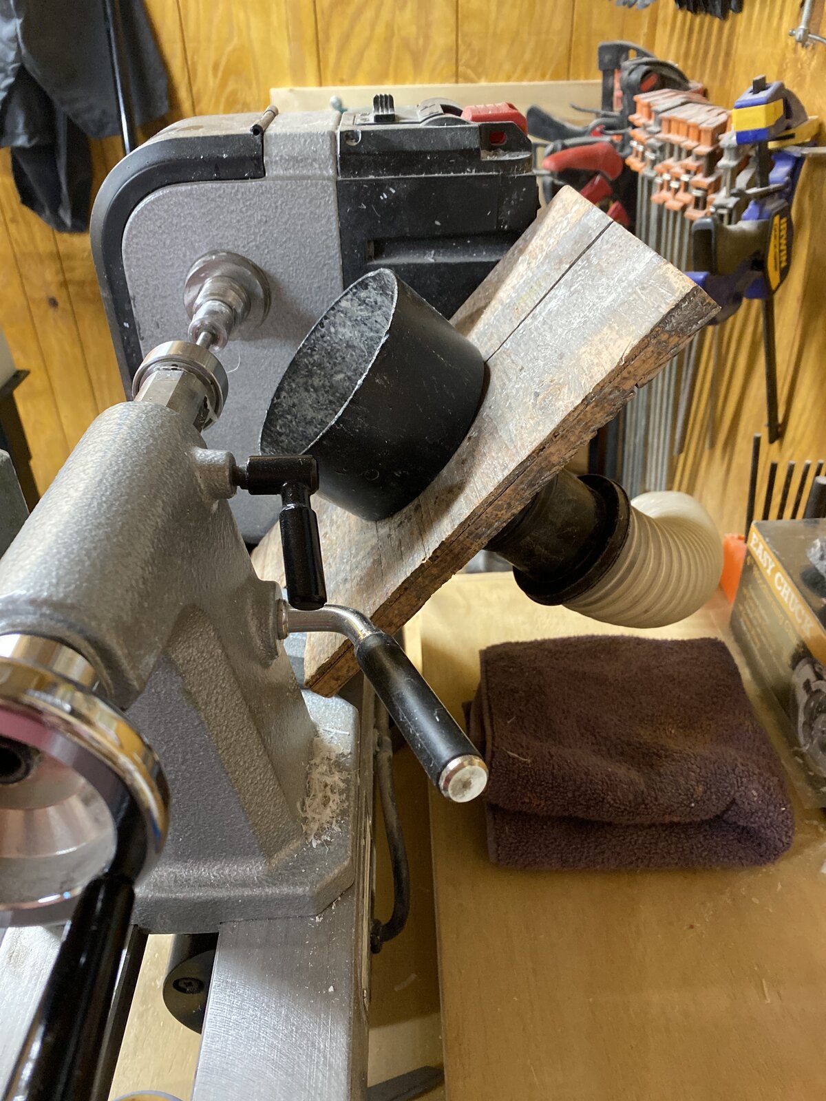

Nothing fancy…..

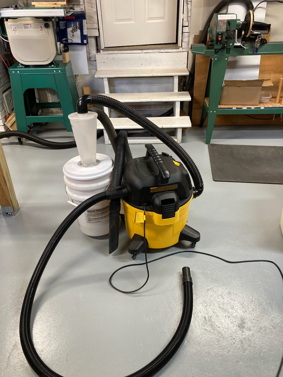

I use a shop vac. Have for a couple of years. I have a variety of attachments, and for pens I use this Rockler pen vac attachment that kind of wraps around the blank on the lathe. Even with that, and with my respirators, sometimes...and I don't know how, I still get exposed. In the long run, I guess the fumes just get sucked through the vac, and probably come right back out? I dunno. In any case, my reactions are severe enough that...well, I guess its safe to say, I fear using CA...
Never smell any fumes with this setup.
