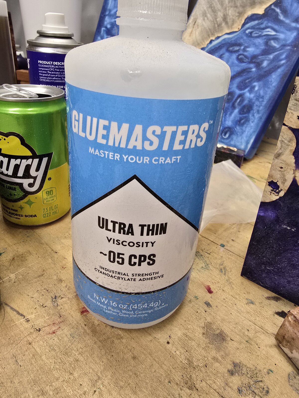

They don't disclose the viscosity of their ultra thin, I might have to try for CA finishing. I mostly quit CA finishing, I to started out 13 years ago with a boiled linseed oil and CA glue. Then I tried Mercury thin flex with decent results on a straight pen blank it's not too bad but I always have issues on the curves of my seam ripper handles with CA and I make hundreds of those each year so mostly I do a friction polish wax.
I currently I get 16 oz of ultra thin (maybe not flexible) for $58 shipped to my door. Gluemasters ultra thin is ~05 viscosity
I use it all the time for stabilizing cracks and small checks in burls and love it for that. I
