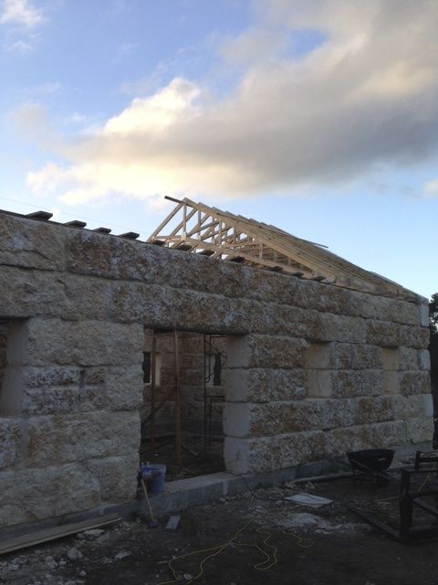

Each stone block measures 2' x 2' x 6' and cost $80 each. Delivery charges really depends on how far they have to go to deliver them. In my case $40/rock for delivery (about 45 miles from the quarry).
The foundation measures 2' wide by 5' deep and cost $20,000 for the 36' x 60' footprint.
Installation of the rocks has been ~15K to date...and more to come.

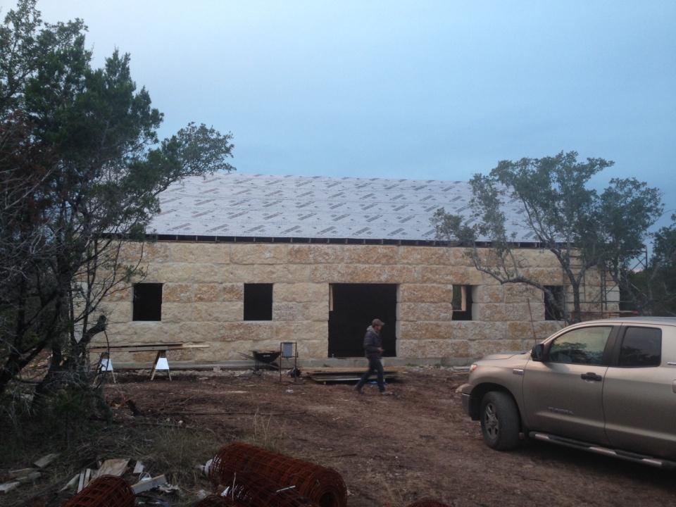

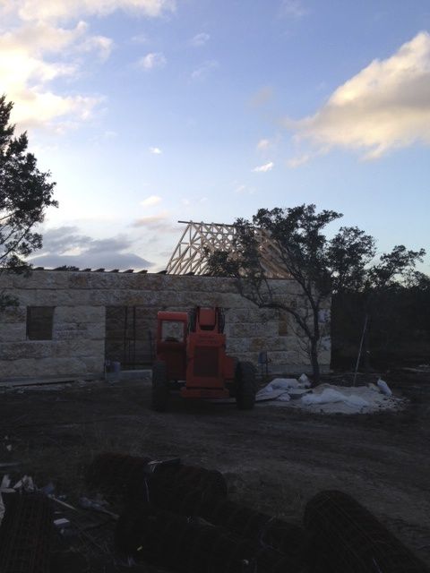

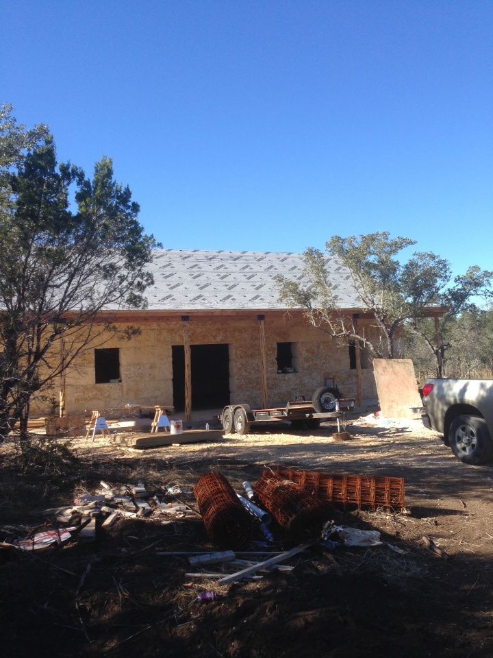

Latest today. Lighting a fire under them.

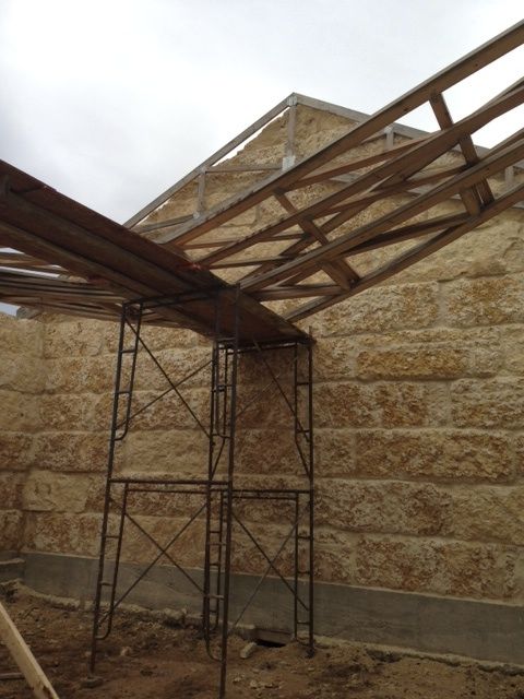

Truss going up...finally!
The project that never ends......hard on the pocketbook also. Overruns...missing sub-contractors...rain delays....

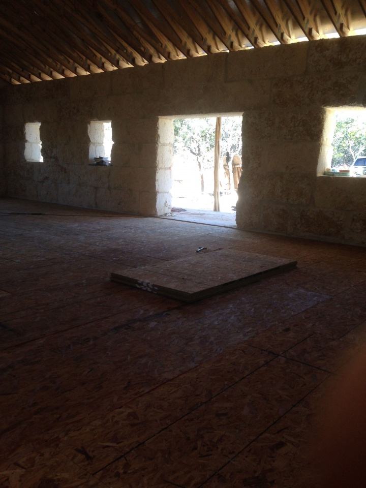

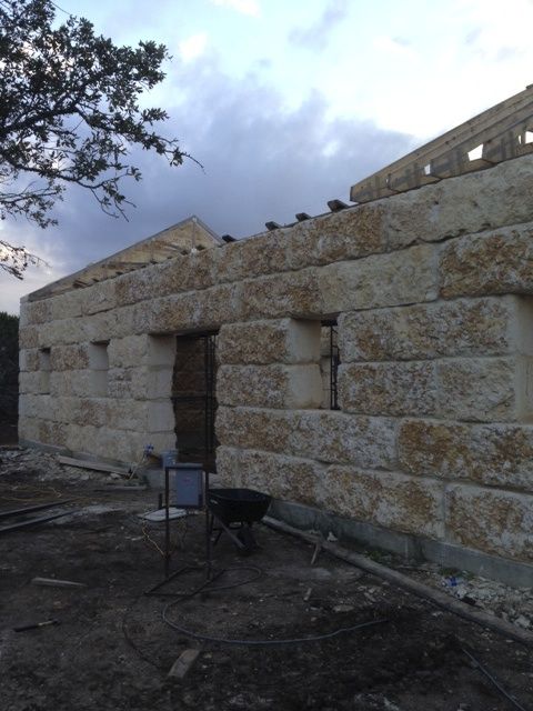

Ear preservation
Ear protection will be important. the echo is intense
on the flip side, it was 48 degrees outside and 60 inside..without doors and windows. the stone is rated at R65.

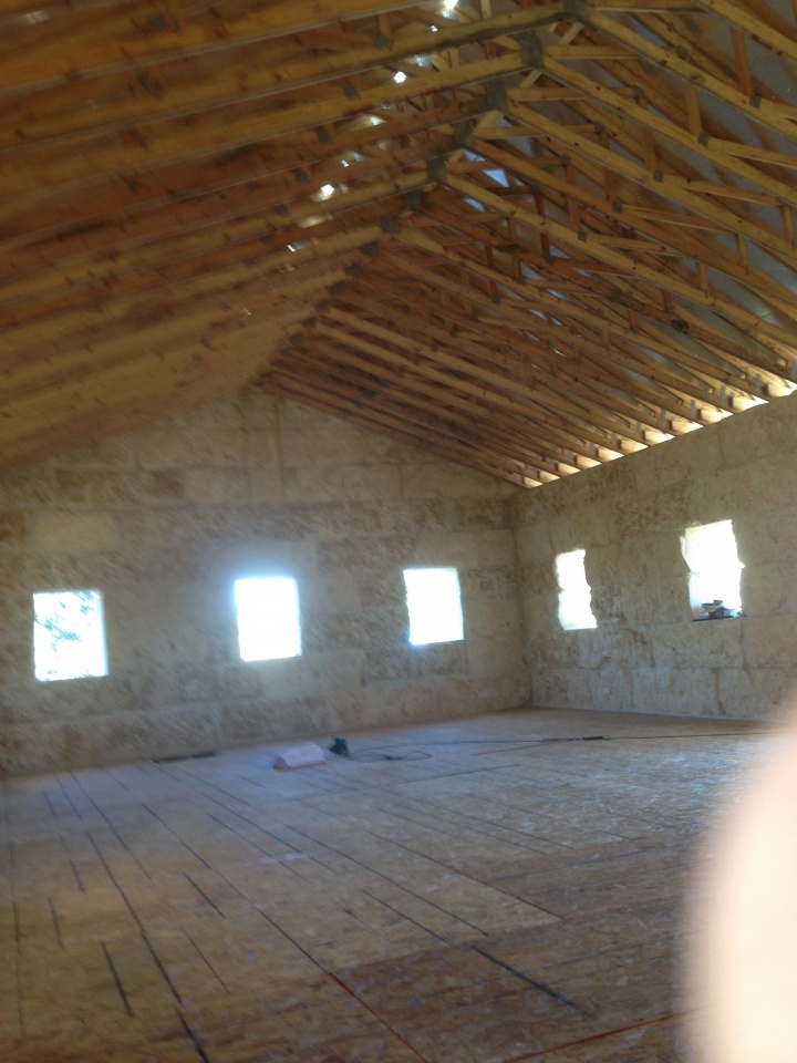

One aspect of your building that I was disappointed with is, that timber roof that doesn't seem any different than the roofs put on houses in our days and the very same ones that, get blown away with strong winds so, I wonder, what good it will make to have a structure up to ceiling level that is capable to withstand the worse of cyclones and a rood/ceiling combination that will be taken away on a "mild" cyclone, exposing everything and therefore causing tremendous damage on anything that is inside that building, particularly if heavy rains are involved...??:confused:
On the other hand, I can understand of the extra costs of having a better roof/ceiling combination but, you have already made a statement by building such an unique and strong building base frame/body so, I apologise for my observations/questions but, I feel pertinent...!
Please, don't take offence of my opinion, I'm doing so based on the principle of constructive criticism and at the same time, satisfy my curiosity about this issue so, I would appreciate your thoughts on this...!
Cheers
George
George,
You are correct on most points. the floor is being changed to 2 layers of strand board and then a 3/4" oak tongue and groove flooring. the roof is very modern because of cost and the fact that it will not be visible. A good twister may remove the roof but the stones aren't going anywhere. I will be "skinning" the rafters with a bead board so no one will know the true structure under it.
Here are the current pictures.

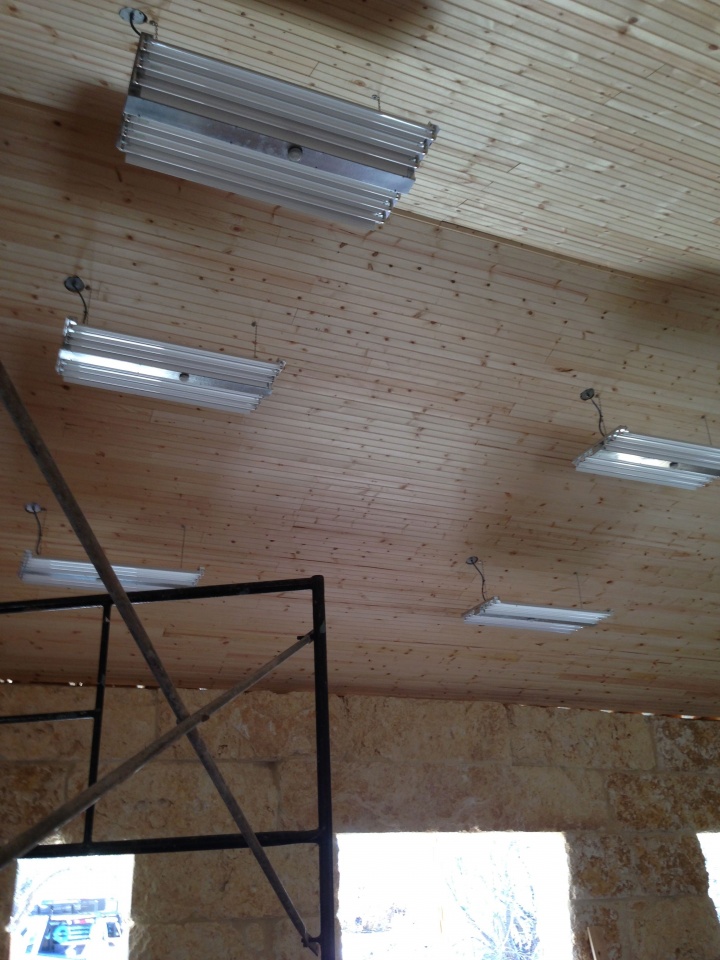

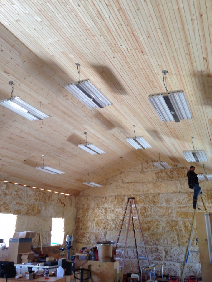

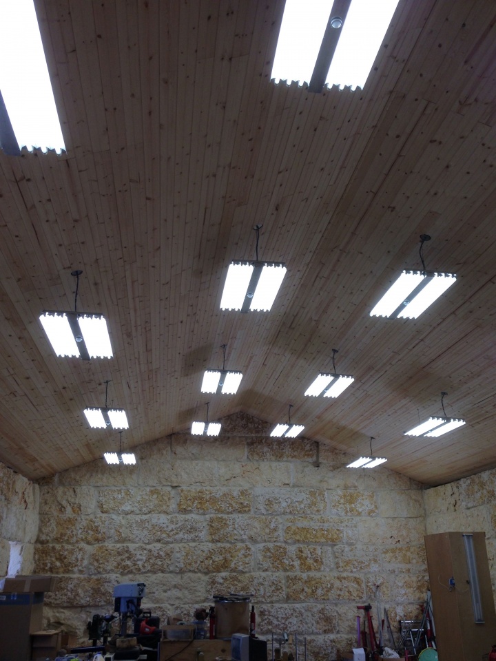

Let there be light!
It's been a long trek. Lights are now installed. Look like the sun rose in my shop. No shadows will ever be known in here. Installed high efficiency, motion detected panels (16). They come on when you walk in and go off 10 minutes after last motion is detected.

How did you run the wiring for the lights and switches? I don't see any conduit anywhere! Is it outside? Just wondering since we are in the planning stages to have a concrete house poured soon and that is one of our questions. Our house will have a poured foundation, walls, and roof.

the wiring was run up in the corner thru a conduit where it cannot be seen. We buried it with rocks and mortar. There is one interior framed wall (i'll take a picture) where the light switches are but I will most likely never use them as the motion sensors are doing a great job.
I have an office, mechanical room and a bathroom. The mechanical room is for 5hp vac and air compressor. this room has 3/4 plywood, 1 inch soundboard and 1/2 inch drywall. I am hope the shop will be very quiet while the van is running.
I'll take some more pics in the morning.
In all serious if you are focused on something at the lathe for 10 minutes these lights may shut off on you. You may want to have some non-motion lighting at the lathe just in case.
