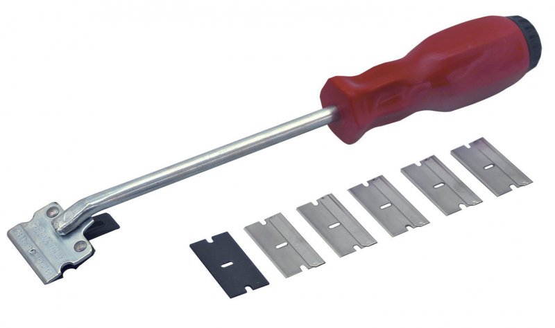

If you're like me, you have a lot of blanks sealed in wax to prevent drying
out too fast. Then, you spend a lot of time getting the wax off to see what the wood looks like.
You sand it, heat it up, etc. but nothing works very well.
Well, here's a little gadget I found that works wonders taking wax off.
All you do is scrape the wax right off with it. Change the blade & it works like new, every time.
What is this miracle tool I have found?
Well, my friends, it right below.
Here's the link in case you want one.
https://www.amazon.com/Lisle-52000-Razor-Blade-Scraper/dp/B0002SR88C
None of my blanks are end grain. So, I really don't know how it will work on it.
But if I have to get rid of wax on end grain, I find it usually turns right off using sharp tools
For turning, the only time I worry about wax is for stabilizing / casting. A good scraper works great. For end grain it's best to cut off 1/16 or so. For burl natural ends, soaking it in xylene will dissolve the wax, then hit it with a wire brush.
