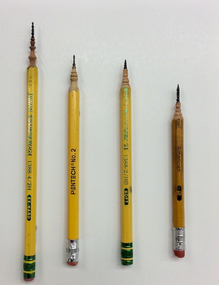

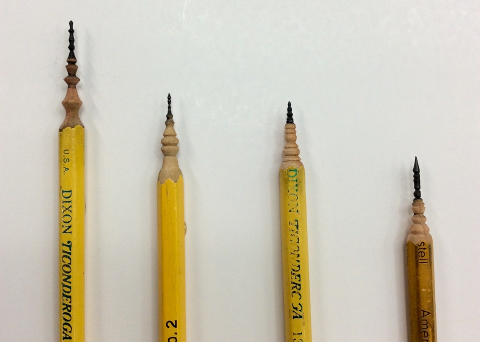

I had another go at the pencil turning I showed recently. This time I used a visor with magnifying lenses. That made a difference in my being able to see more detail while turning. For these, I stuck them on a card with some hot melt so no one would pick them up and use them during show & tell at our club meeting. :biggrin:
Tools used: 1/4" spindle gouge, 1/4" round skew.

Which turned better the 4H lead or the B lead.... 4H being the hardest. Used to irritate my drafting teacher with the ultra fine lines from a 4H
Hey Vic, I found that the regular #2 lead was the easiest to turn. The #4 seems to be a bit harder but cut fine. They were more brittle and subject to snapping off if I didn't have my finger behind the lead for support. With sharp tools, both cut fine.
I tried a red pencil but with less success. The red lead seemed to be more "waxy" .....harder to get crisp detail and would snap off quickly.
Note I used wooden pencils...not those plastic types.
