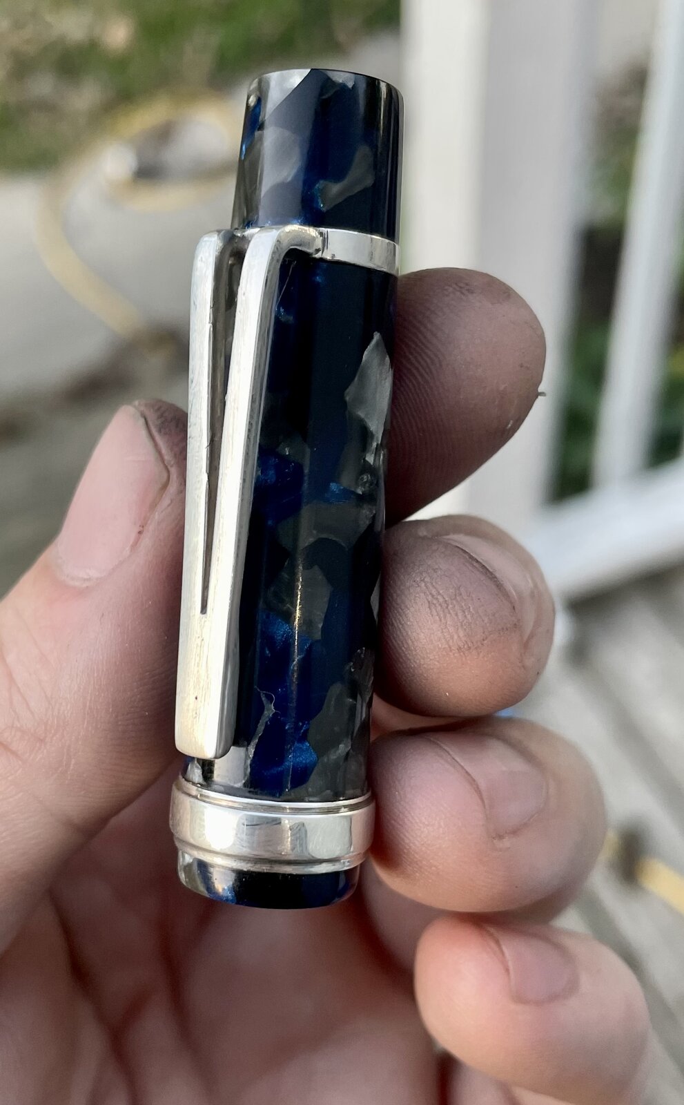

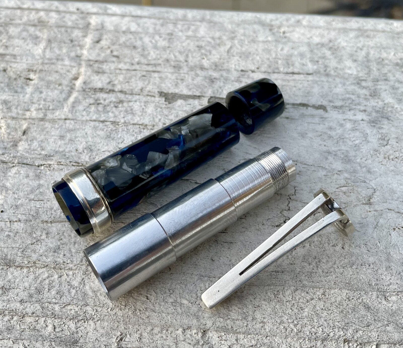

Aluminum sleeve for a vintage acetate cap. Sometimes I use aluminum because I can get away with very thin walls, as opposed to ebonite or acrylic.

Aluminum sleeve for a vintage acetate cap. Sometimes I use aluminum because I can get away with very thin walls, as opposed to ebonite or acrylic. View attachment 361269View attachment 361270
John,
I was just wondering if you could give any instructions on how you would make a clip like this. If there is already another thread, or video, where you might have done this could you just point me in the right direction?
Thanks,
Bill
