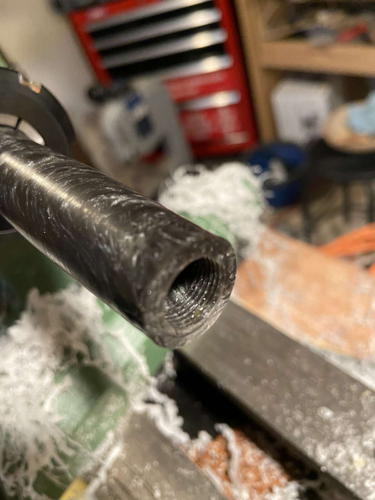

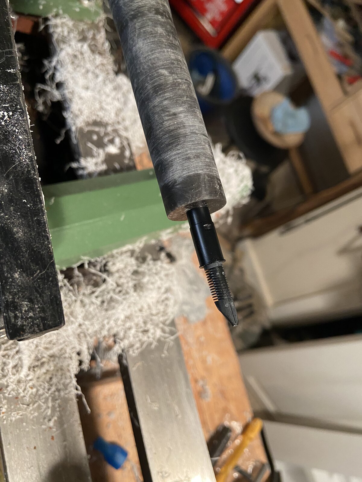

Well I am finally jumping into the deep end of the pool. I have been gathering tools and nibs and odds and ends. My first attempt at tapping went great. The threads seemed nice and crisp and the pen feed screwed in nicely. I don't think my placement was spot on. I will do a little more measuring and drilling and try again.

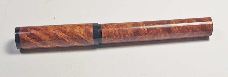

I'm not a fan of the word. Even the kit pens I make are bespoke since I only make pens that someone has requested. But, kitless isn't any better. Only those of us who make kit pens really k ow what kitless really means. Here is my latest kitless bespoke pen.​

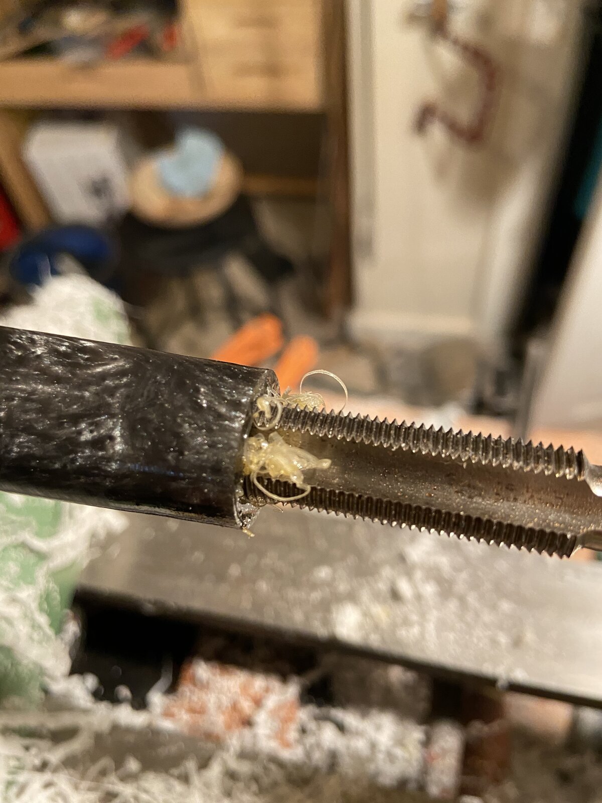

Well anyway. Here is my tapping. It's a triple start and made shavings very nicely. And the threads look good. Going to do the male part later.

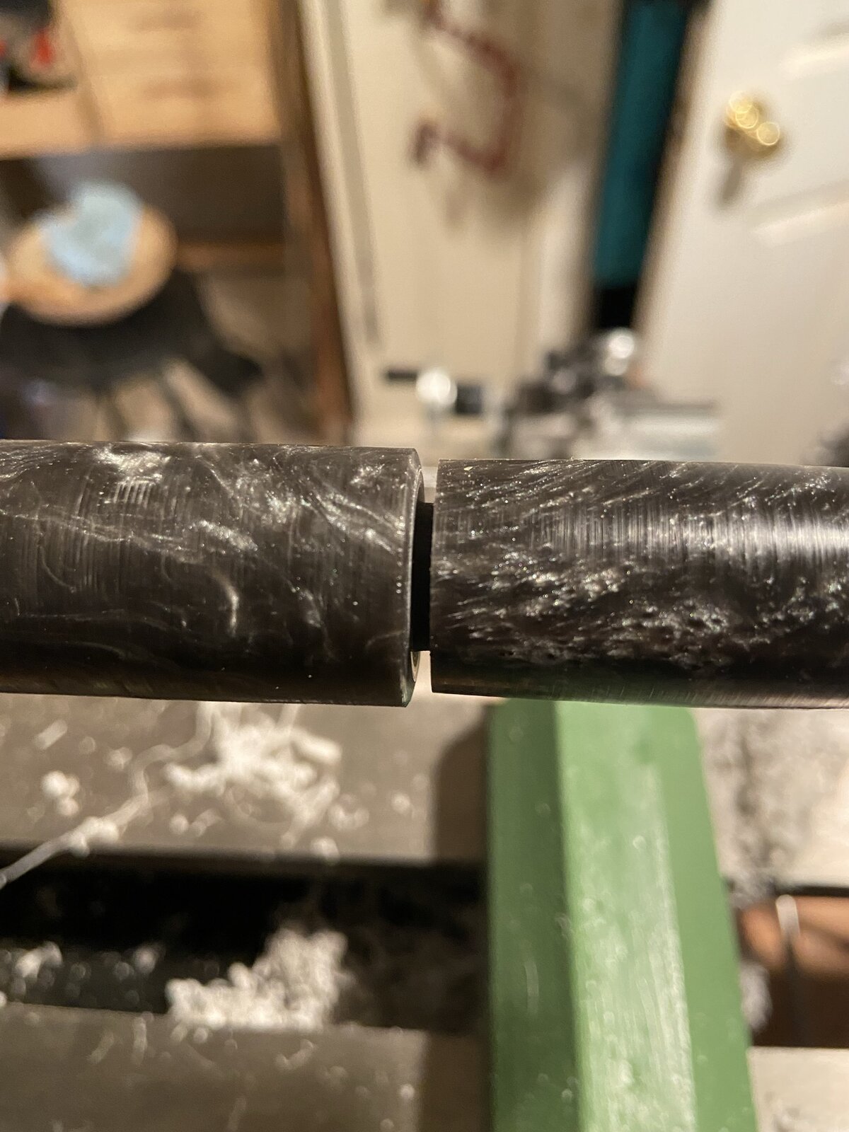

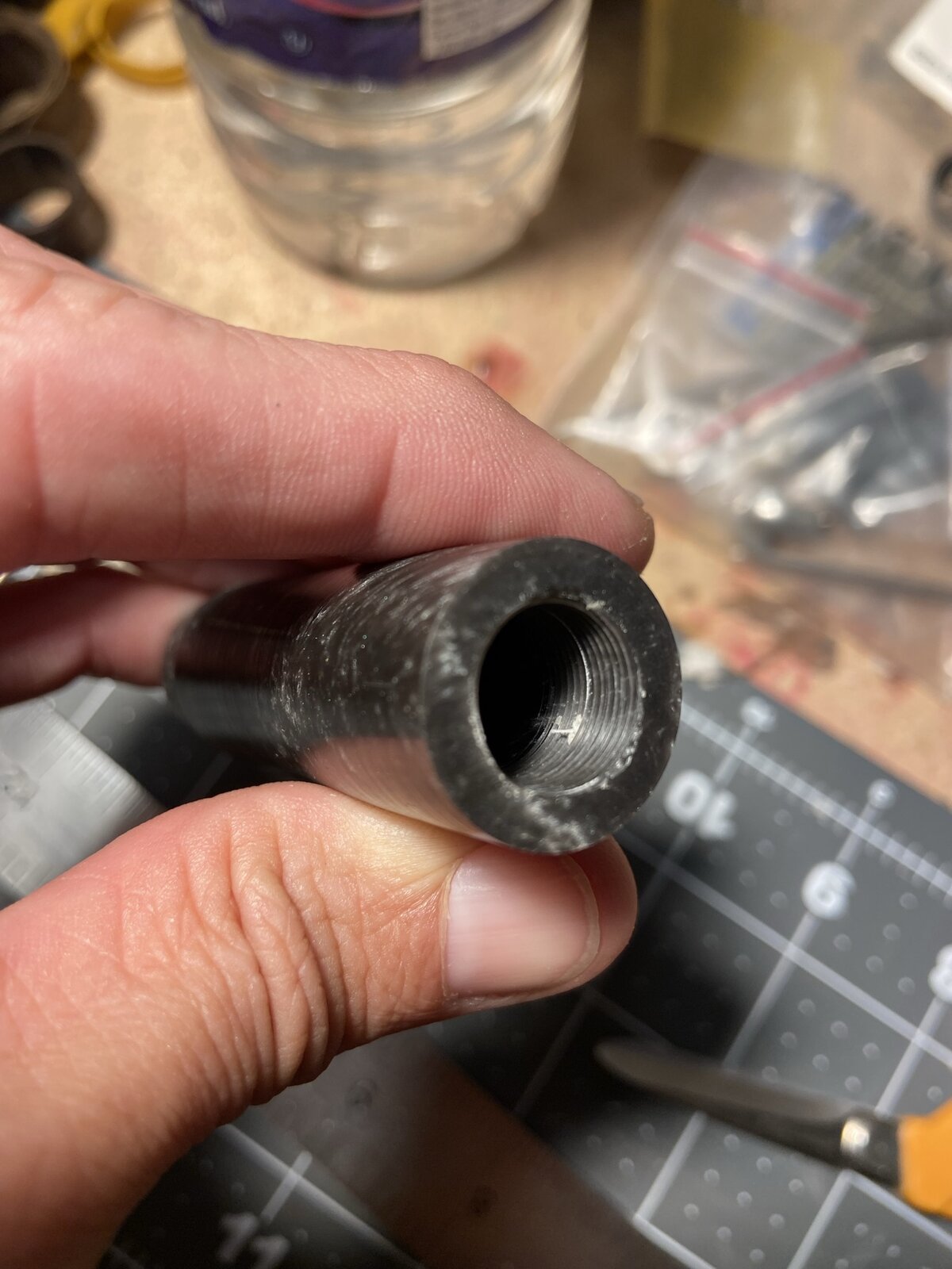

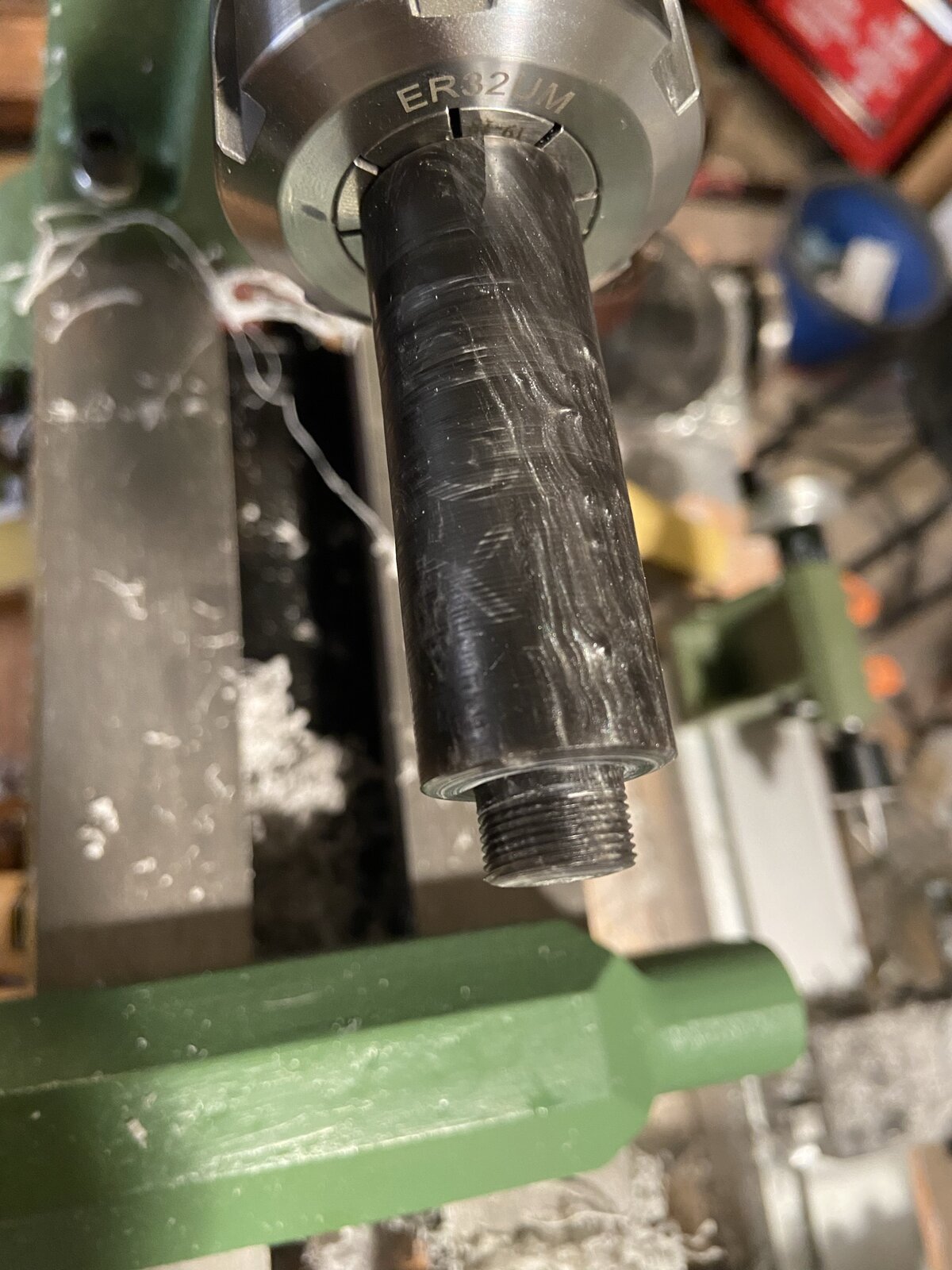

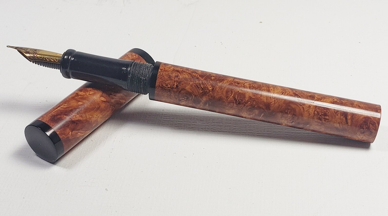

Here is a little update for those that are interested. I have been working on getting the threads cut in the cap and body portions of my learning pen. The threads cut well once I got the dimensions right for the tenon and opening. I used a 13x.8 triple start I got on a group purchase and they did a great job. The problem is that there is a gap when I try to screw the two parts together. Is this where I have to cut a shoulder behind the threads? Or take a little of the threads off the cap so it will ride over the threads just a bit before engaging?

Agree with Duncan. Remove threads from inside the cap- you'll likely need to do that anyway to ensure the cap screws and unscrews with a reasonable amount of turns. The thread relief or "gutter" on the barrel
is supremely ugly, and needs to stop being a trend in penmaking.
Paul asked : "Or take a little of the threads off the cap so it will ride over the threads just a bit before engaging?"
Duncan said : "This is what I do - IMO a gap behind the threads looks ugly."
John said : "The thread relief or "gutter" on the barrel is supremely ugly, and needs to stop being a trend in penmaking."
I agree with Duncan and John.
