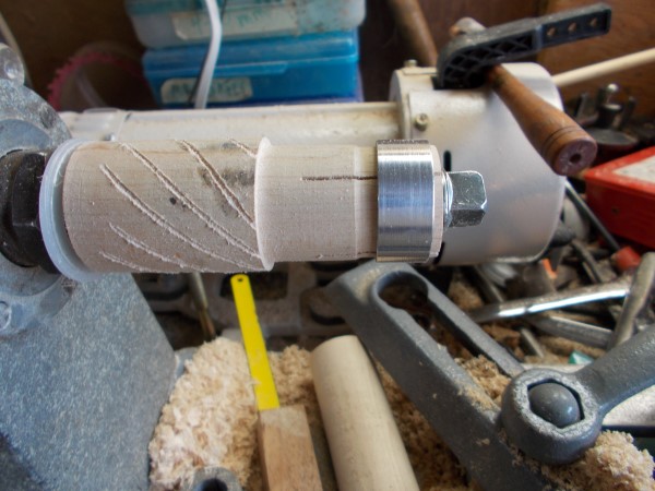

I make my own ring mandrels. I turn to size I need and the drill and tap the end for a pipe plug. Then I cut 4 slots like a collet so that the pipe plug will expend the size. This one is for duck call bands, but the same thing. I also drill and tap the opposite end to fit the spindle threads. The rough saw marks make it easy to unscrew the mandrel. I also use a similar "mandrel" to hold the ring blank, but where the pipe plug fits, is a 1" diameter hole to stick the ring blank and a pipe clamp to squeeze the fingers of the collet. I use modified spade/paddle bits to drill for the sizes.
