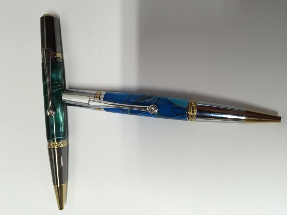

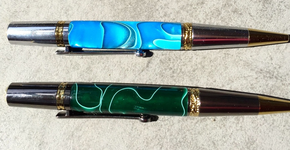

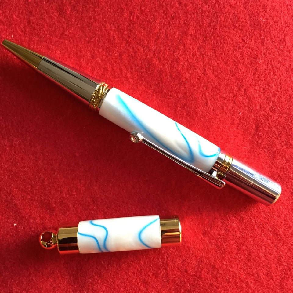

OK, here are my first three Acrylic Pens
Thanks to a lot of advice and counsel from the forum, as well as my mentor who got me started in this wonderful hobby, I turned 3 Acrylic pens (and one Perfume Vial from CSUSA) today. The pens are all PSI Majestic Squire pens.
I purchased a spindle gouge and skew and some sharpening equipment that I share with my mentor. That has also been a learning experience for me.
The IPhone camera isn't the best for this, because they look spectacular in the sunlight!
Thanks again for all the help! This is really fun, and I realize I have a STEEP learning curve to get this right.
