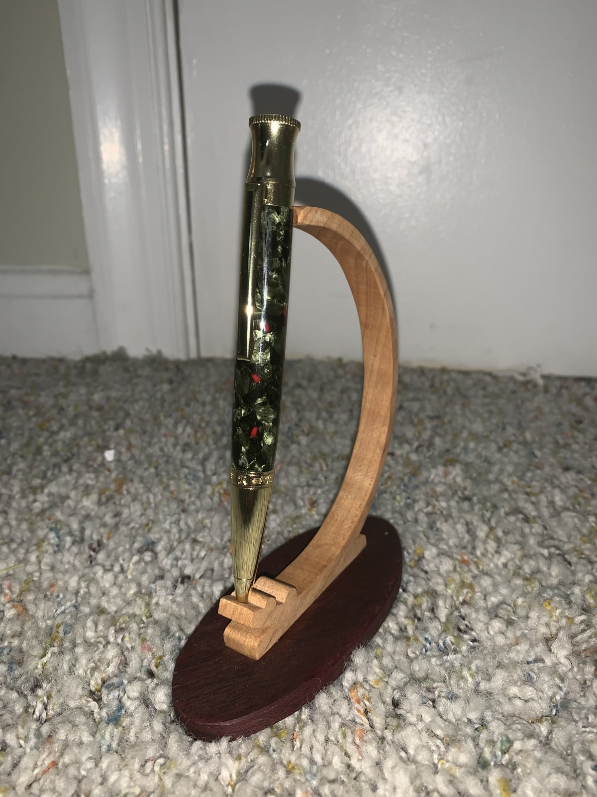

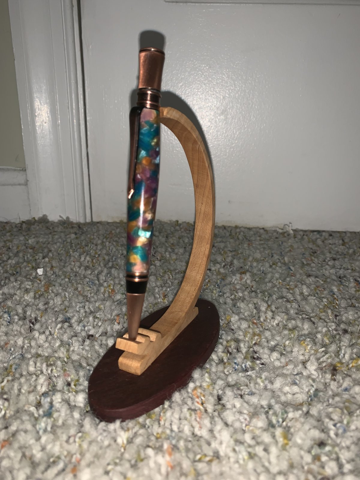

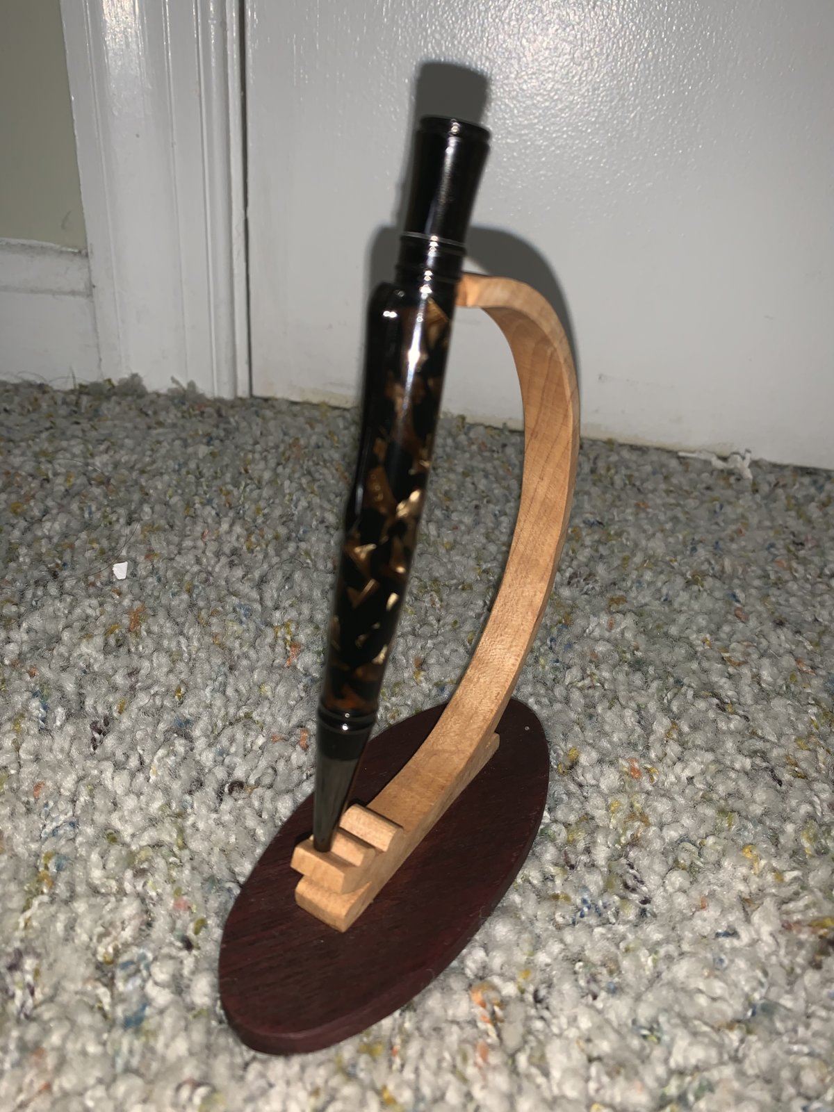

I've had some issues with plastic blanks. See here and here. Blew another one out tonight. But some are turning out quite nice.
Forgot the links to the errors: https://www.penturners.org/threads/getting-better.161028/
Good ones attached.
